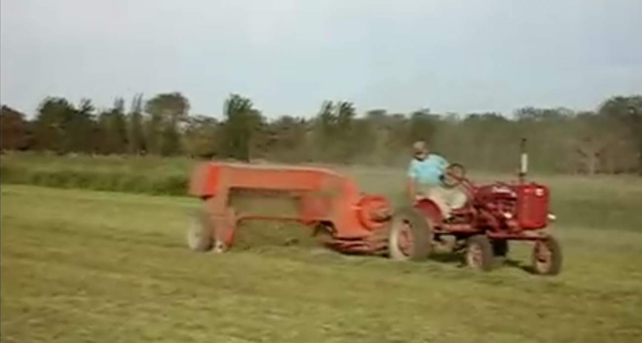

I ran a Massey Ferguson 124 bailer (small squares, two twine) with my Mahindra 5525 (55 hp engine, 45 hp pto). The operator manual says the minimum hp for the 124 is 33 hp (pto).
Balers this size have been operated successfully with much smaller tractors. This photo shows a Farmall Super A operating a small square baler. The Super A has about 16 hp (pto).
Some small balers have on-board air cooled Wisconsin engines that typically run 20 hp (pto). Tractor pto not required for this type baler.
