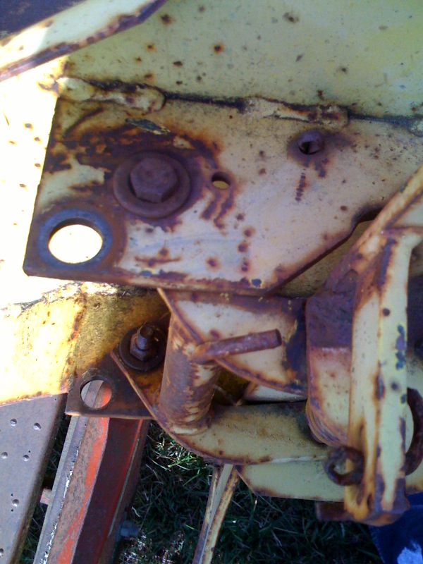

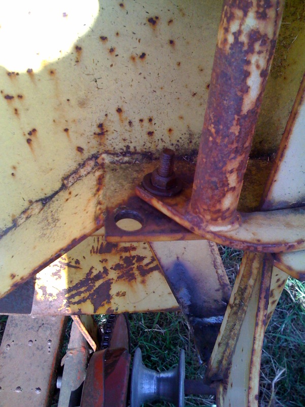

Funny how both our machines have issues in exactly the same areas. I just welded one of my front forks back together (with a bridge reinforcement).
My pulley shield brace also broke.
BTW: I just removed the 2 rear forks as being unnecessary (used for retrieval). As you can see, your wagon frame is level with the ground. Mine is pitched downward in front. How about adapting a tractor drawbar to a Class III truck type and then use a drop hitch to lower the front end?
Also, the wheel you added to the bale chute needs to caster (rotate). Otherwise it will get torn off when turning. Mine is just a heavy duty job from TSC.

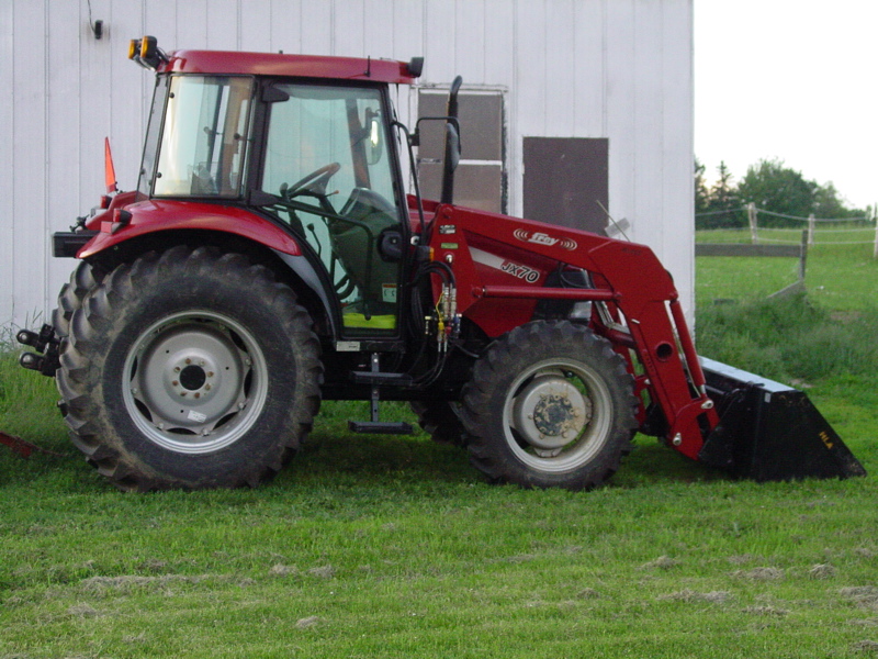

Our neighbours have the Case JX 70 cousin to your TDD 95. Its only got 16.9 x 30 tires on it so the drawbar is much closer to normal. The final drives are spur gear offset to the rear as well though but probably not as much as yours. They have the tires set in as narrow as they can go too, basically rubbing on the fenderwells.
