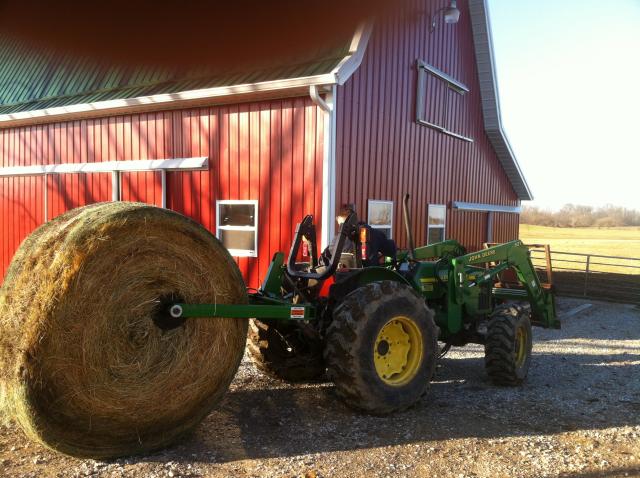

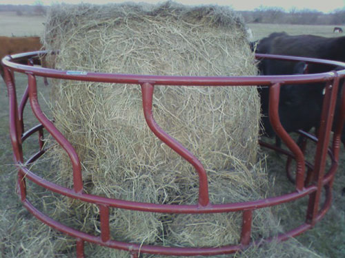

Ok we have always used hay rings. I don't understand the benefits of unrolling. To me it would waste a lot of hay. What dose everyone think.
