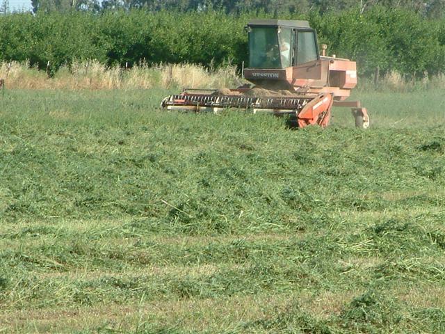

Just to complete my input to this discussion, I have several neighbors who grow hay crops on large acreage--one has 30 acres of irrigated alfalfa; another dry-farms about 200 acres of oats or beardless wheat (he alternates year to year). Both of them use self-propelled Hesston windrowers (aka swathers) to mow their crops

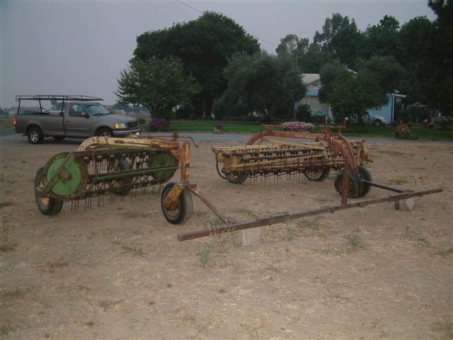

The alfalfa windrows are combined using a dual bar rake setup.

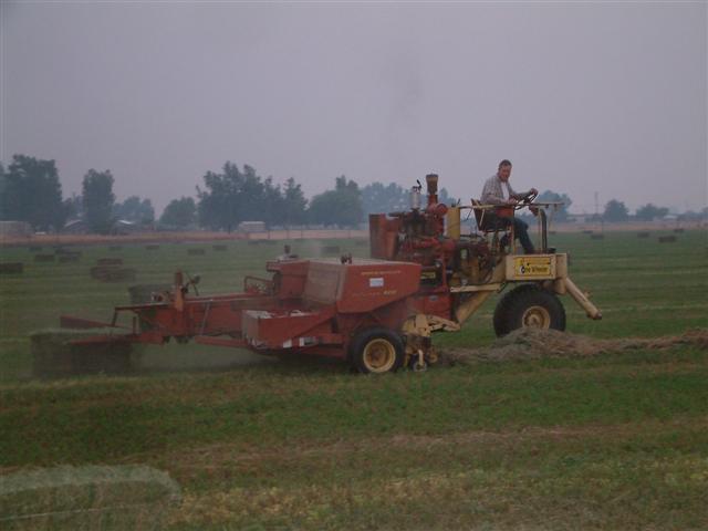

A self-propelled 3-twine NH baler does the alfalfa (the engine is a Deutz diesel, the front wheel is driven by a hydraulic motor)

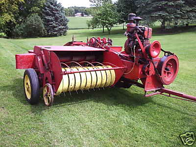

Baling on the 200-acres is done with a towed baler that has it's own engine (like this NH66 baler with a 2-cyl Wisconsin gas engine)
The nice feature of these balers is that the baler operation (70-80 strokes) per minute is completely independent of the tractor so you can control ground speed with the foot throttle on the tractor without changing the baler rpm. Very helpful when the windrows are not uniform.
