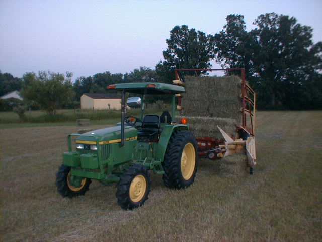

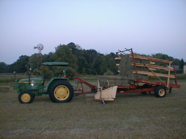

Works for me. Not much power required, but the empty tongue load is high. Need front weights or a loader attached. Mine also has the single bale unloading feature. Youtube has a vid on how this works.
The alternative is a wagon or trailer behind the baler with a 1 armed teenager on-board, good cell signal or wi-fi coverage and light weight bales. stack_wagon.jpgstack_wagon_III.jpg
