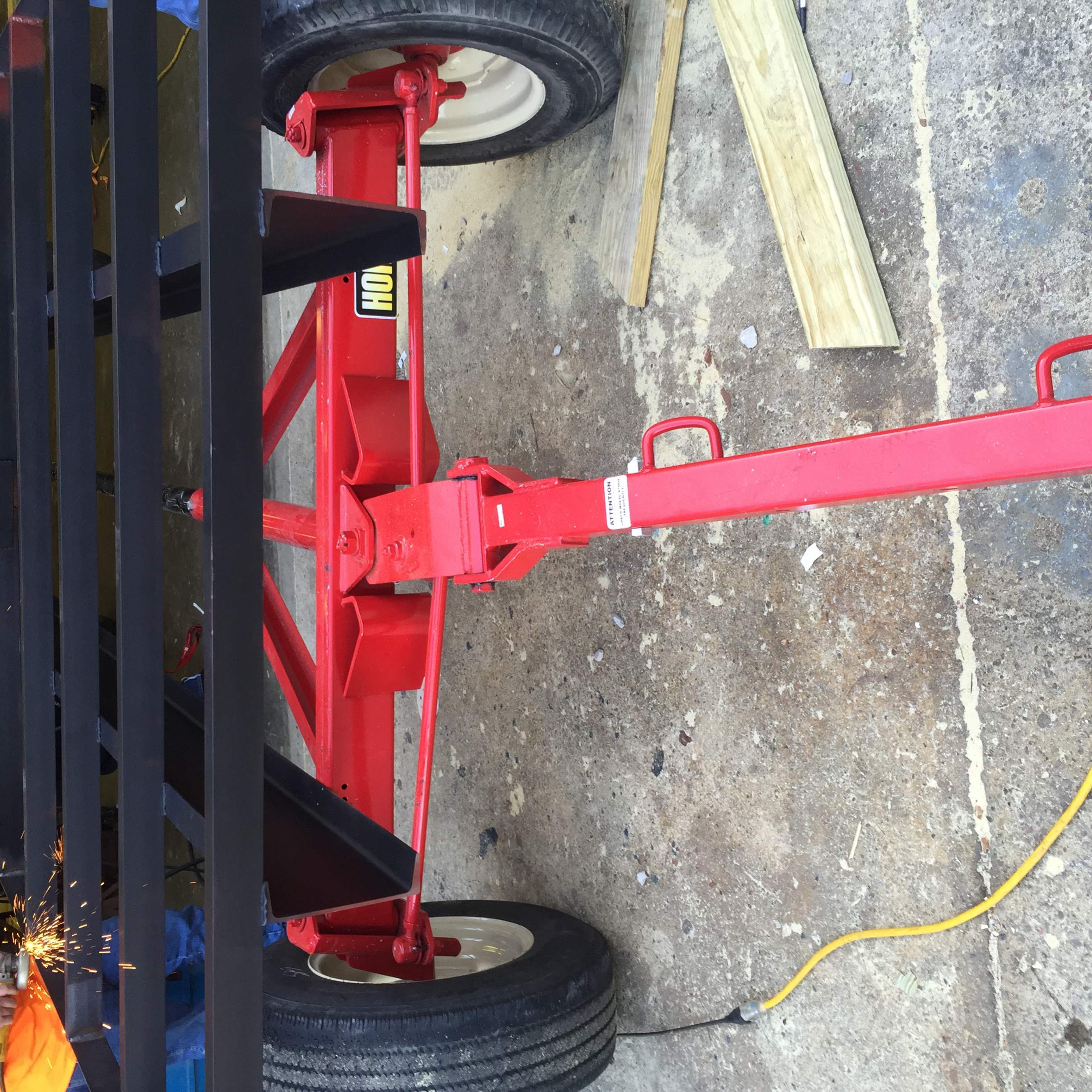

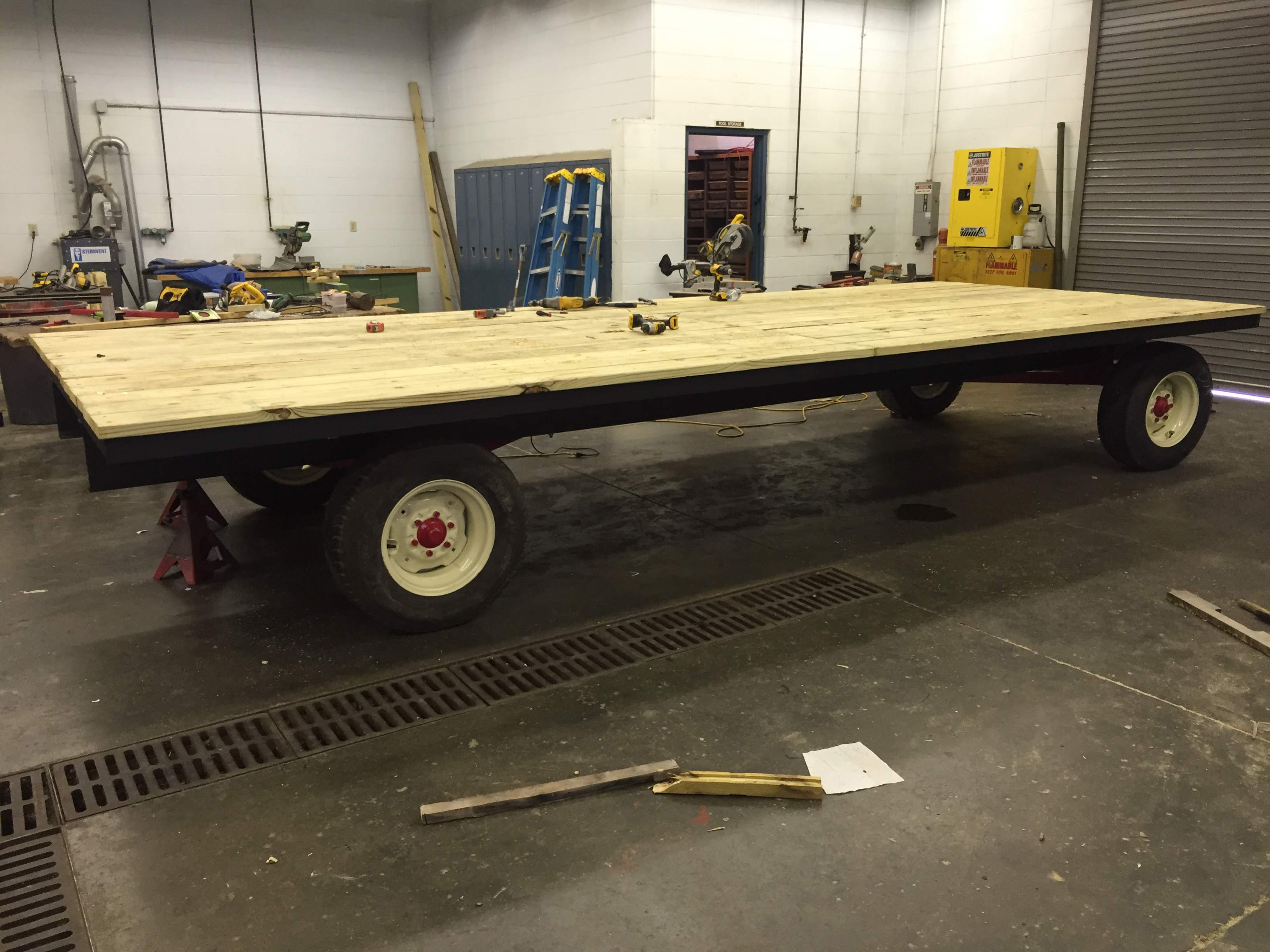

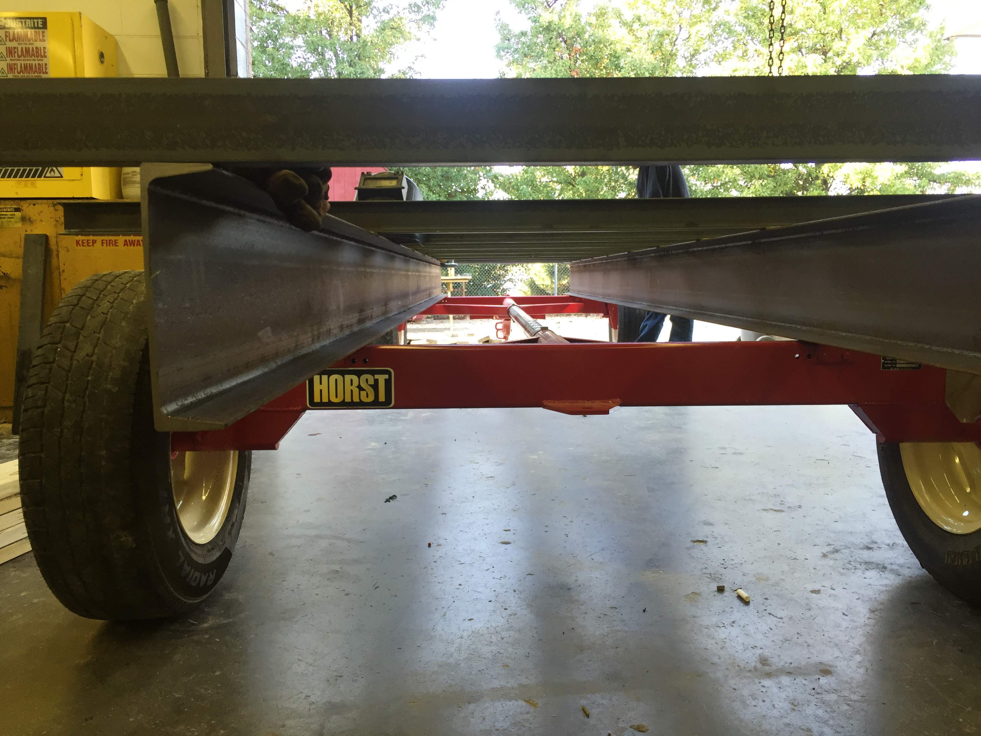

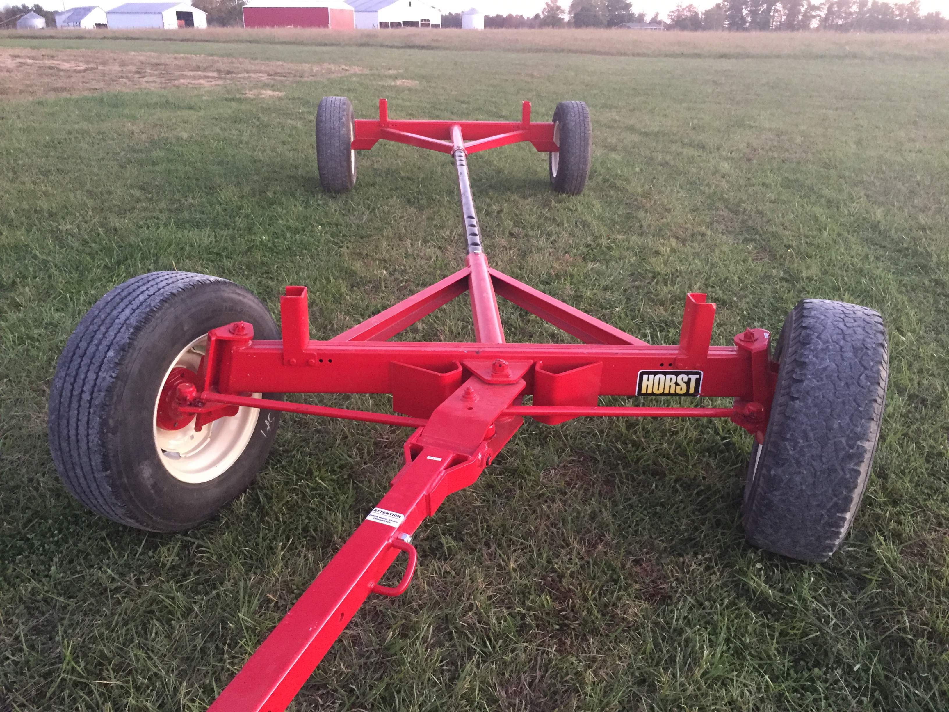

We are building a metal hay flat with 10 inch channel as the sills and 3 inch channel as runners every 24 inches. The top will be treated 2x8s. Question is can you still bolt this set up to the running gear or should we use a chain or cable one on opposite corners? If we bolt it I'll use a grade 8 on opposite corners. Wagon is 20 feet.

What do toy mean chain or cable? ? Only thing I have ever heard of is bolting. Just make sure you have heavy enough running gear.
Have you tought about making it a trailer? ?

The running gear is rated at 8 tons. I just want to make sure it has enough to flex if it needs too.
   / Hay Flat #5
Our wagons are bolted on all 4 corners with grade 5 bolts. Thats stronger than the wood and I doubt it will be a problem.
