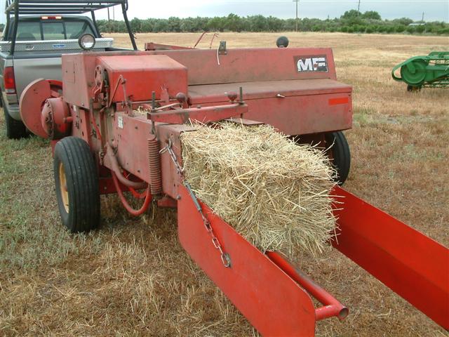

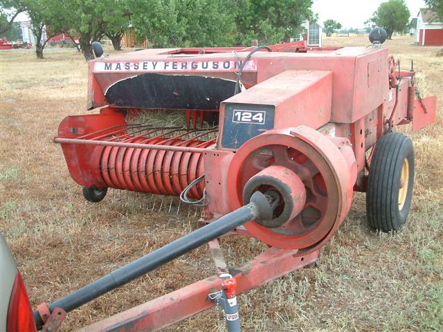

A nice 530 went for $900 on eBay a year ago Oct. So $1K doesn't sound out of line, provided it's in working condition. Be sure get the seller to include any manuals and spare parts as part of the deal.
When was that baler last used? The MF124 baler I bought a year ago was purchased right out of the field--the owner had used it the previous day to bale part of his 30 acre hayfield.

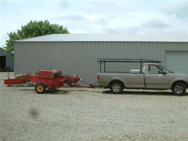

Next problem is getting it home. That MF124 was about 30 miles from my place. I towed with my 2001 F150, staying on the back roads to avoid the local gendarmes. Kept the speed at 25 mph max.
