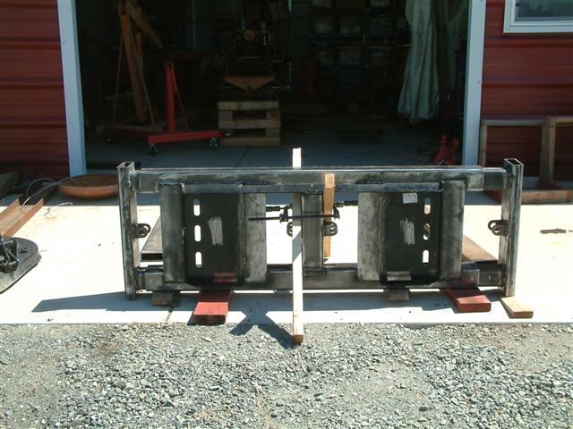

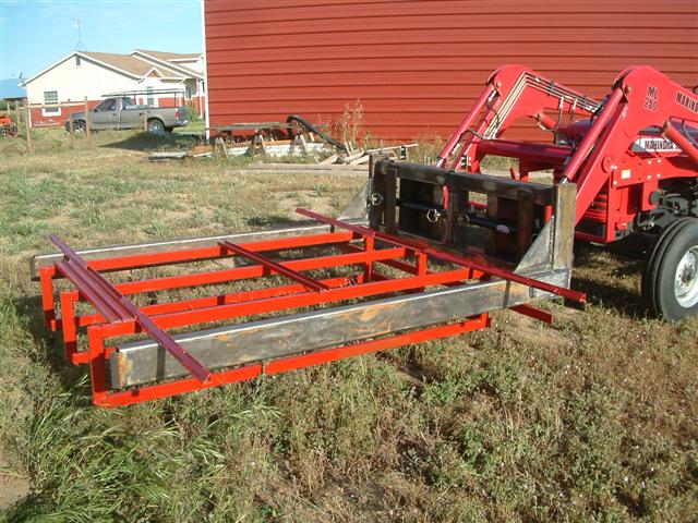

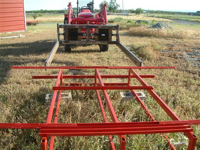

I built this combination accumulator and bale squeeze about 8 years ago for use with my 2008 Mahindra 5525. The 8-bale accumulator is clamped onto the forks of the bale squeeze and is then removed to use the squeeze to stack the 8-bale groups. It attaches to the skid steer quick attach on the 5525 FEL arms. It's a nice welding project.
View attachment 499048View attachment 499049View attachment 499050
Good luck
Neat work. If I understood the process you use, could you have designed the accumulator part to slide together when the bales are squeezed but then been pulled back open when the arms open up?
