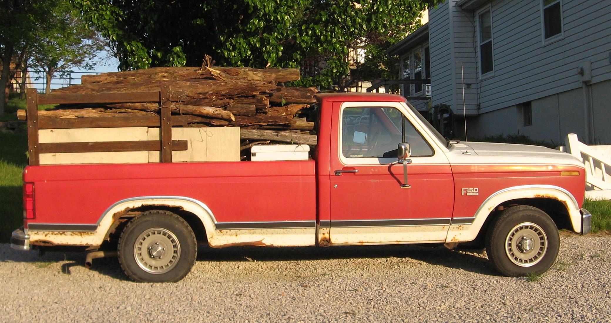

My 1984 F150 regular cab long bed, with crossbed tool box and 2 people weighs 4,400.
Ain't she sweet? Have no idea what the load of logs weighed, but it was too much....

Forgot to attach the piccy

Shes a beauty Clark!
Really though looks like a good old hard working girl!:)
Chris
