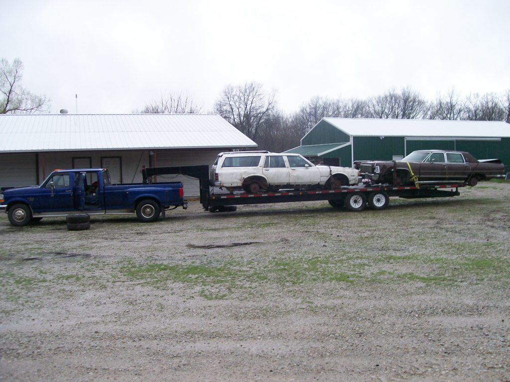

I have weighed the past 3 trucks that I have owned. 1st. 1992 Ford f-150 reg cab long bed 4x4 custom. 300 6 cylinder, 5 speed mazda, full tank of fuel. 4,556lbs. 2nd, 1999 Ford F-350XLT reg cab 8ft bed 4x4 dually V-10 Auto, aluminum factory wheels, 6,620lbs. 3rd 2003 Chevy 2500 reg cab 8ft LS 4x4, Duramax Diesel, Allison auto, factory alum wheels, 6,244lbs. I never had any good reason to get them weighed, I just always wanted to know.
/ Have You Ever Weighed Your Truck? #3
I was weighing mine on a weekly bases last year when scrap was high, The truck and trailer run 14,400 to 14,600 empty depending on the fuel I carry. The biggest load of prepaired iron I have had on it was 34,000 which seemed little much for my truck and trailer, but I got it there with out any issues.

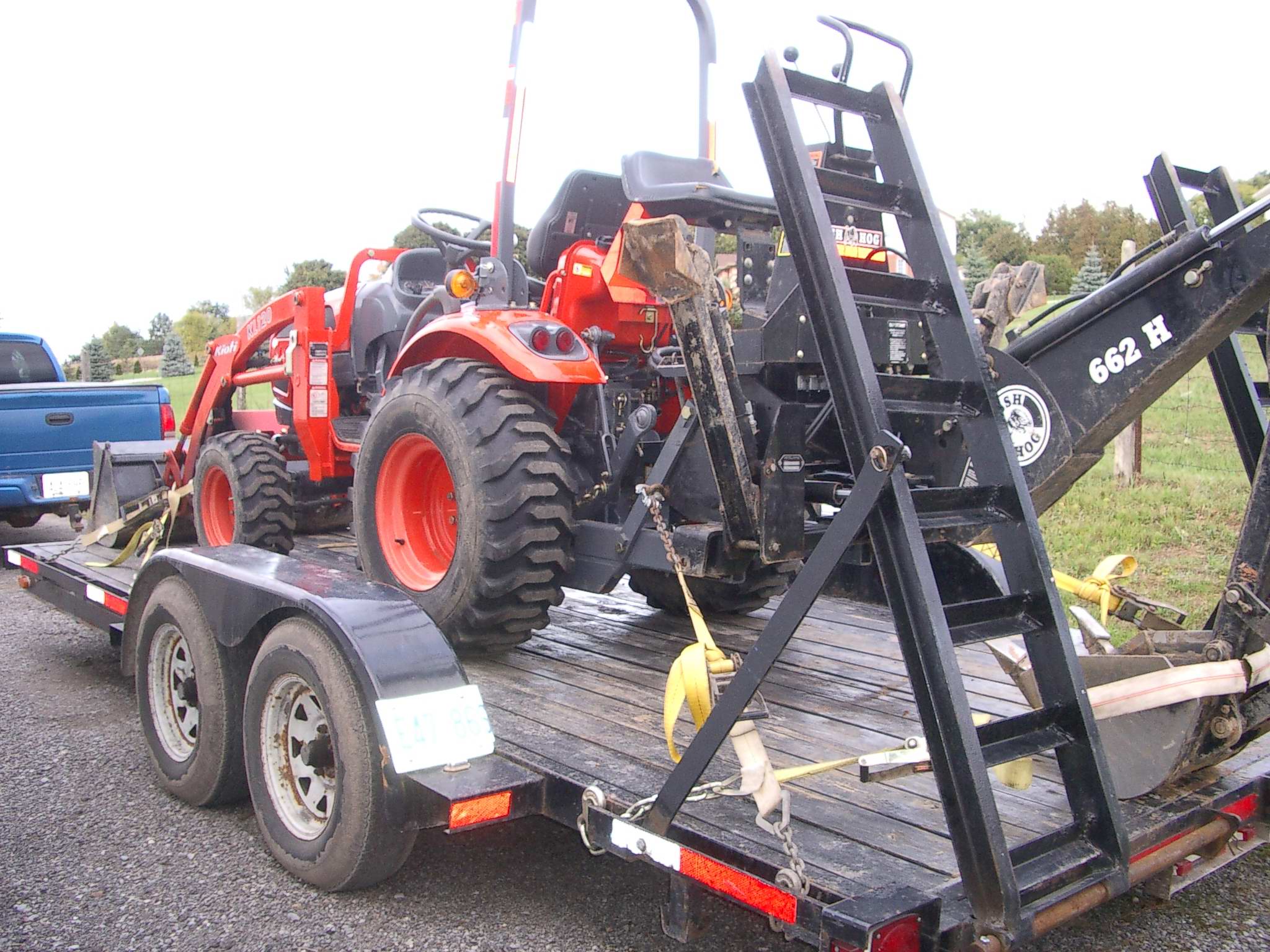

I weighed my truck with the trailer and the tractor & backhoe, to licence the truck for enough weight, everything weighed about 4100kg's, I licenced it for 4500 to give me some leeway with tools and extra's, I maintain everything regularlly but at 4500kg's I don't need an annual inspection or have to a daily trip sheet.

Have you tried backing that tractor on to the trailer to help out that Dakota some? Does not look too bad but it may help some with the tongue weight and allow for better steering control.
Chris
