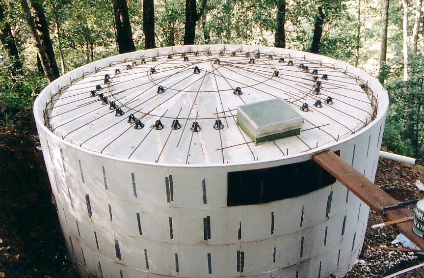

Have any of you guys built a cistern ?
My 5000 gal water tank is made of ICFs, and is poured monolithically.
(ICF=Insulating Concrete Form).
