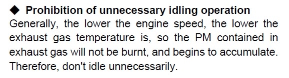

Can't speak to John Deere. But the owner's manual for my Kubota M7060 specifically warns against idling the engine too much and I have found that to be true. As long as I keep the rpms up to at least 1800 rpm it rarely goes through a regeneration cycle. If I let it idle a lot, the regeneration cycle will occur every 10 hours or even less.

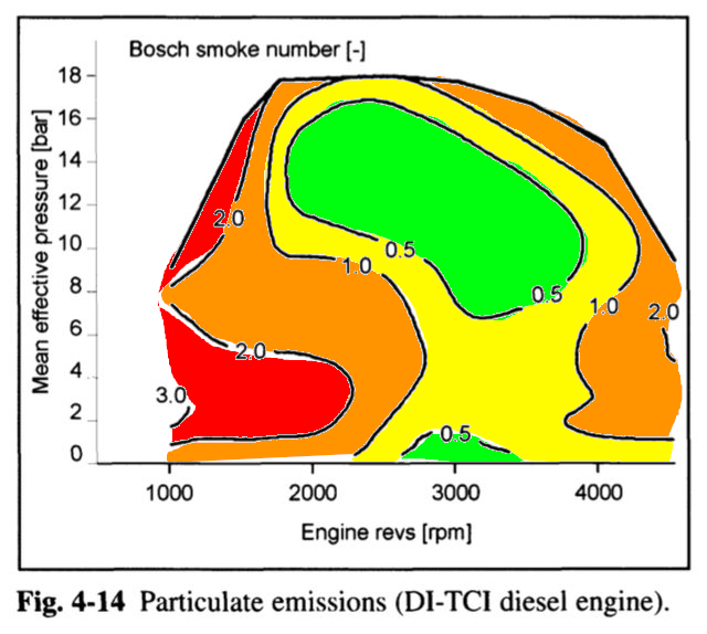

This graph shows soot production as a function of power and rpm. BMEP which is effectively torque is on the vertical axis and rpm on the horizontal axis. You can see there is a sweet spot of low soot right in the range where its putting out some power at a range of operating rpm. I don't know what engine its for or how much it changes for different engines but at least it's an idea of how it is for one engine.
You can tell that letting it idle with no load is going to generate many times more soot that working it.
I (sloppily) colored the graph in as I think those are isolines? so perhaps this is more intuitive for some:
