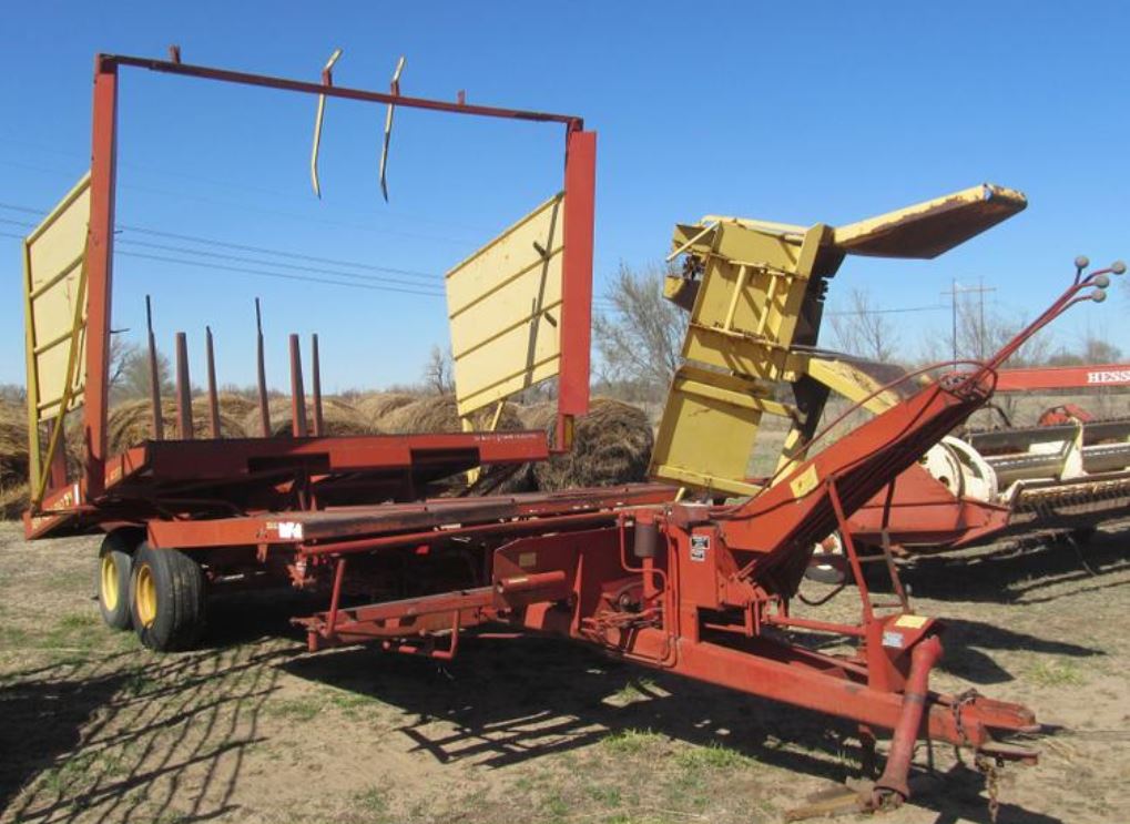

My dad bought a used New Holland Stackliner. After two years of total frustration, I finally convinced my dad to sell it at a loss. It was a great feeling seeing that POS behind someone else's truck leaving the ranch.
