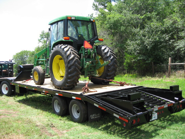

Defective said:
Even if there's a rail, the original method still works best. Just make sure that when you bring the hook up outside the pocket, it's inside the rail. The problem with looping around the pocket instead of through it is that the rub rail is not structural. Sometimes they can be pulled away from the stake pockets.
Meanwhile, if you get sideswiped hard enough to break a grade 70 chain or hook, your trailer is probably upside down anyhow & all bets are off.
I think I'd rather take a chance and chain around the stake pocket inside the rubrail than to have a portion of the hook or chain outside the rubrail and risk getting it hit. That's how I was taught to chain down loads of pipe and structural steel. If I'm not mistaken, that's also the way the DOT wants it done.
I agree, perhaps the proper verbage should have been "to front or back of stake pocket" instead of outside. That's the way I do mine.
