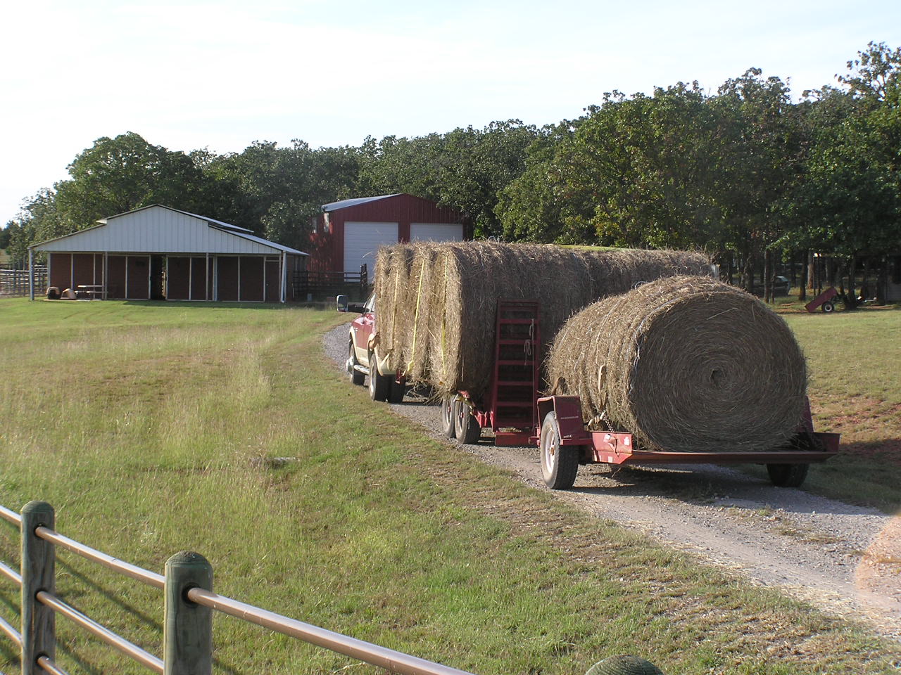

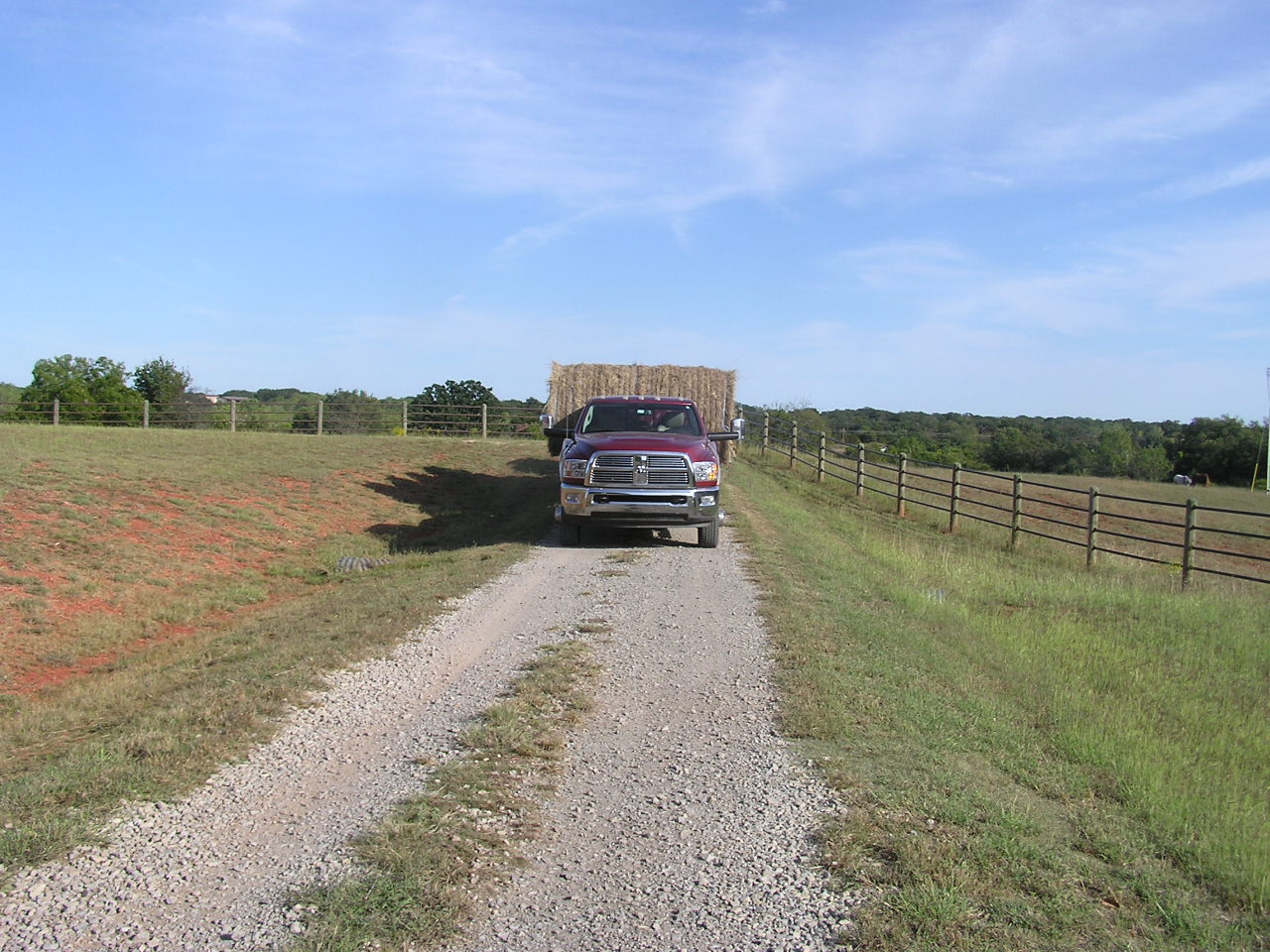

When I was hauling 8, 5x6 bales from my field, I didn't strap them:

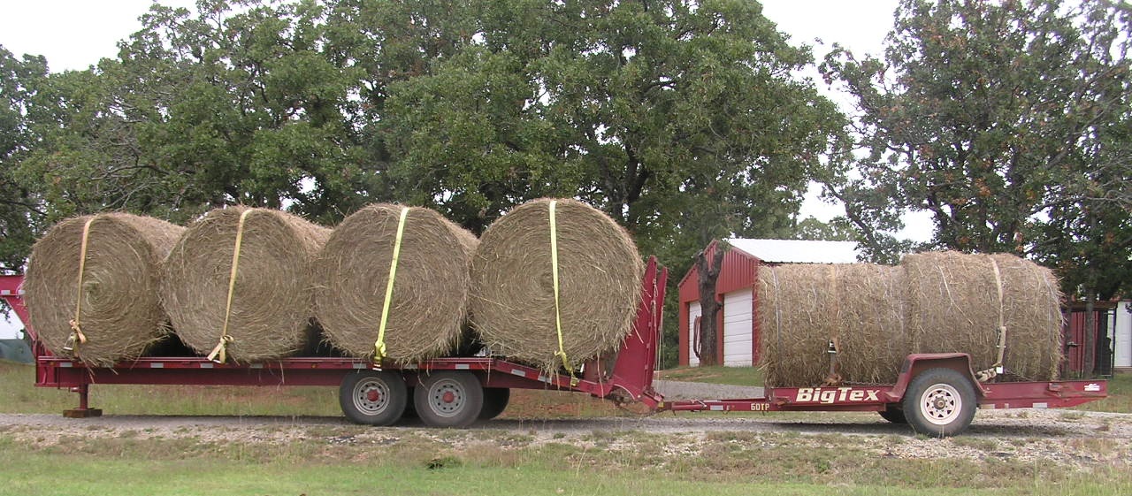

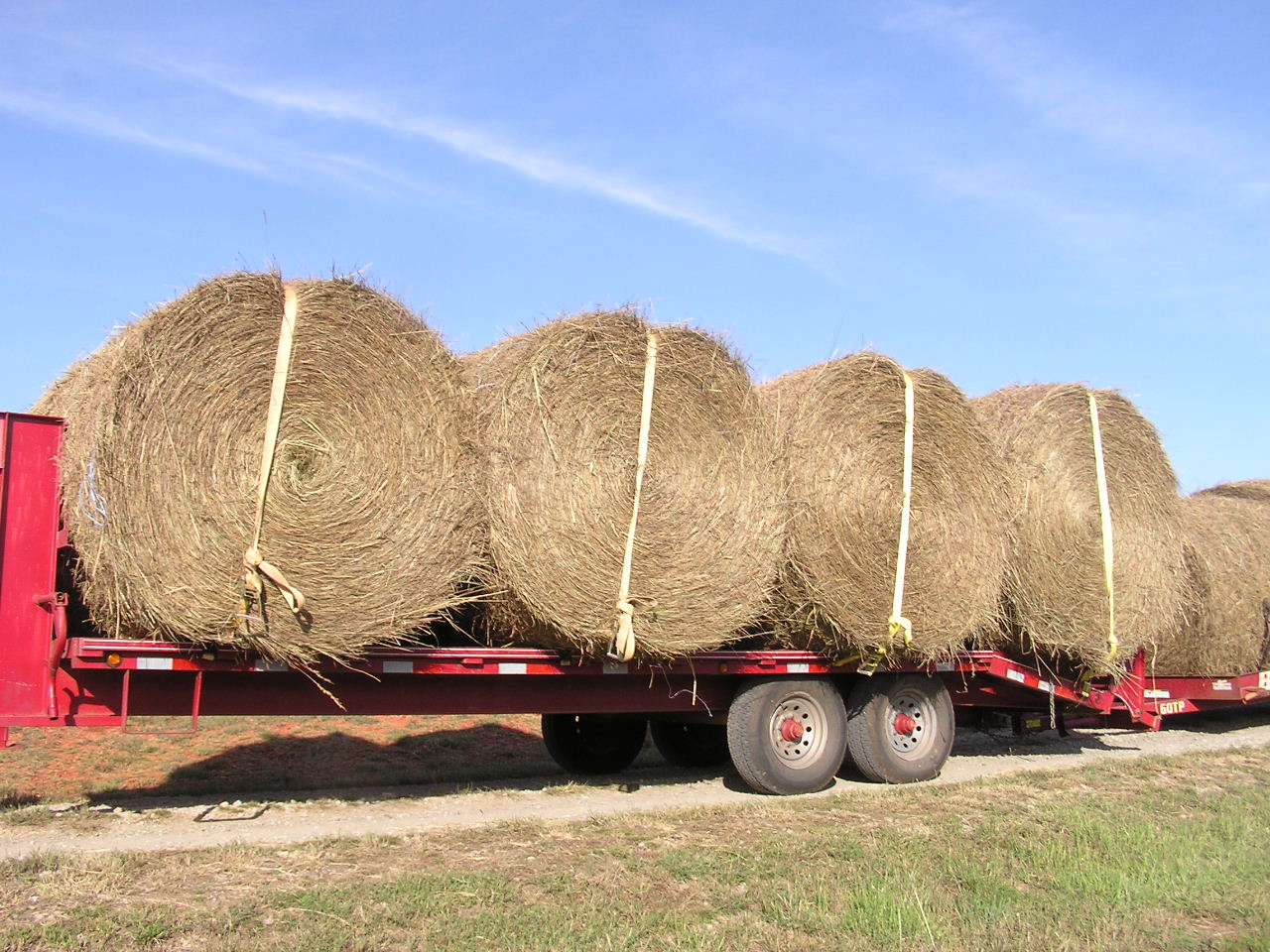

Out on the highways I am required to cross strap each set of 2 and each bale on the little trailer:

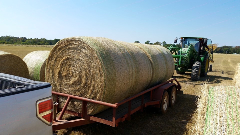

Here's 1000 words
Man that looks like belt and suspenders!
How far are you hauling these bales? With the trailer you've pictured all you need to do is have a couple of straps running fore and aft and if you were only hauling on local roads at low speed you wouldn't even need that. The back ramps will preclude the bales from rolling back. Just the weight and friction of the bales will keep them from leaving the sides unless you are making a 2 g turn. It looks like the front bales are kept from rolling forward by a lip on the trailer.
I haul on back roads at low speeds and I use one strap across the back two bales at a 45° angle. If I'm hauling on a highway( which is rare for us) . I use chains and straps fore and aft over the top of the bales. Never lost a bale with either method.
I would not lay them down on the ends. They will be tippy.

Those are about the neatest bales I've ever seen.
Thanks, but all I did was haul them home. :D
Here is the same load, different angle:
