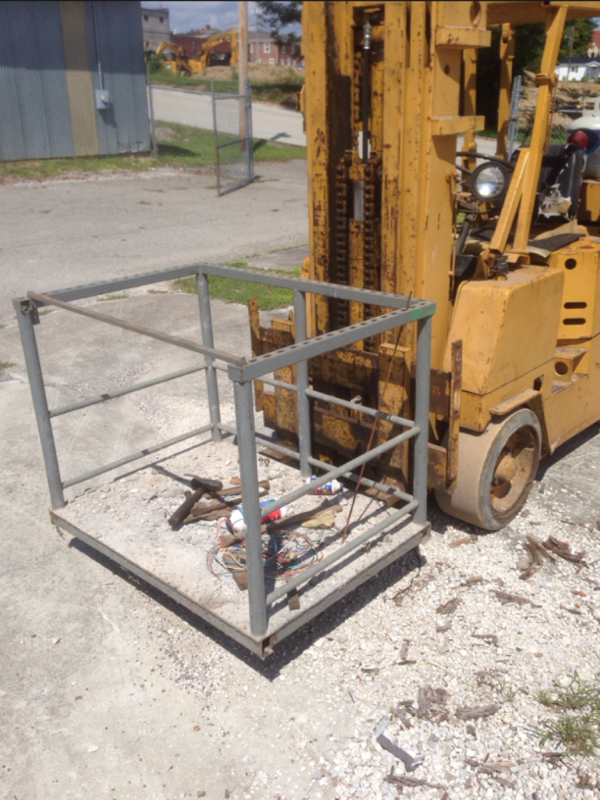

/ HAS ANYONE EVER THOUGHT OF.... #7
I have a homemade platform.
/ HAS ANYONE EVER THOUGHT OF.... #8
Too junky to risk you life on. The pallets are usually rotten out by the time the tank fails, the metal is very thing tubing and probably impossible to reinforce the area cut to create a door.

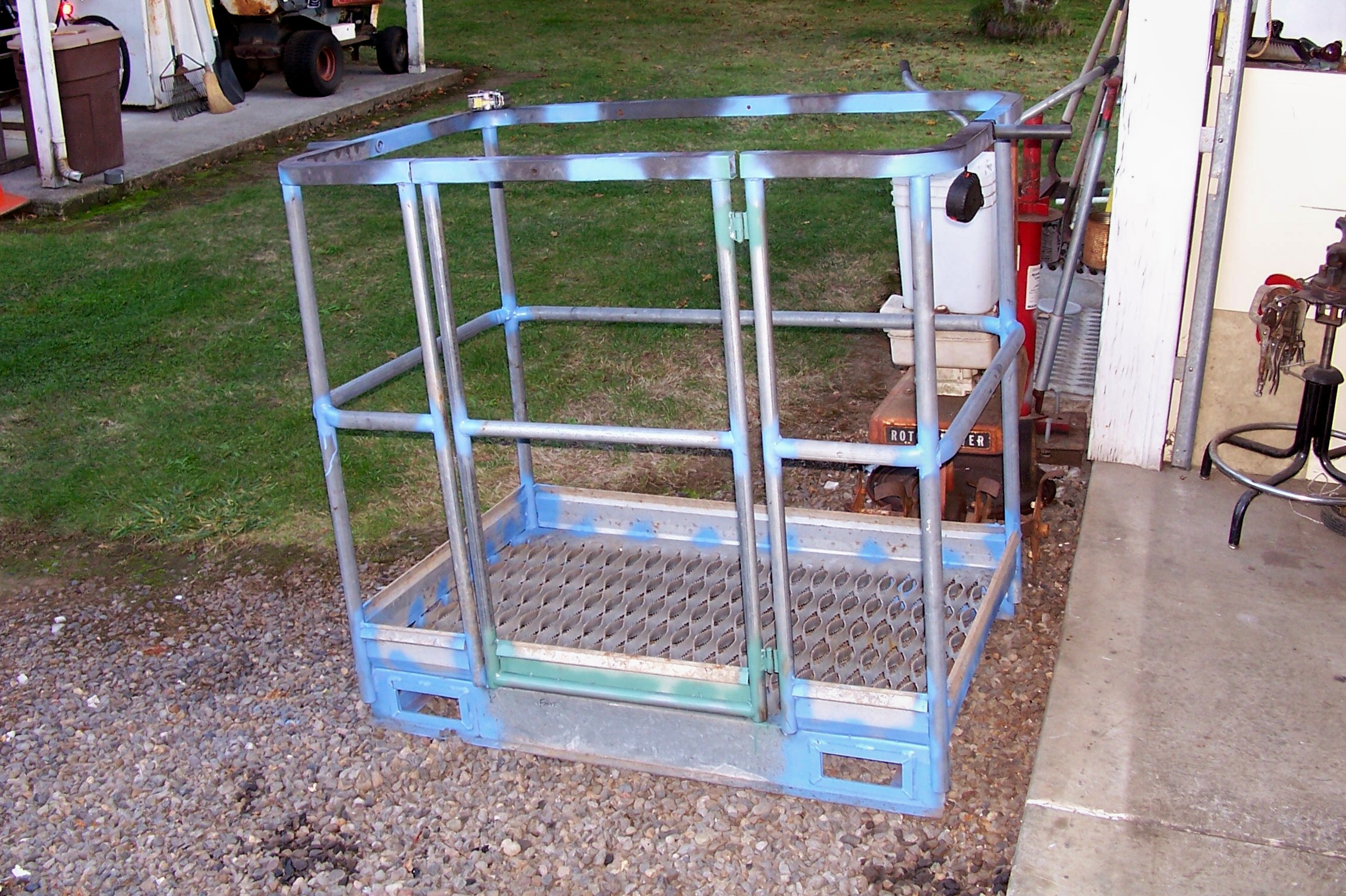

/ HAS ANYONE EVER THOUGHT OF.... #9
I had a chunk of expanded metal catwalk laying around, and enough other scrounged material to make a basket. The hinges are a regular door hinge cut in half and trimmed to fit, it has a dog kennel latch on the door now. Not seen are a couple of bed frame angle irons on the bottom to help guide the forks to the far pockets. Even the paint on the welds was rattle can remnants that wasn't enough for anything else, so all I have into this is welding consumables. I like cheap projects.
