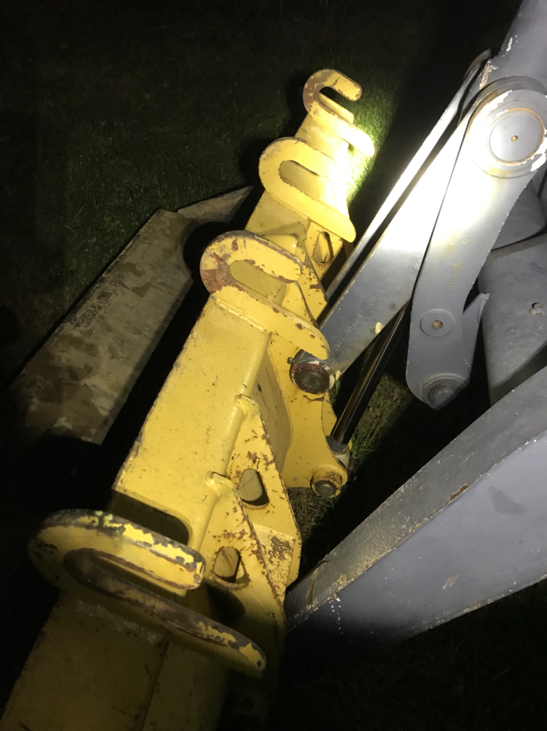

I really want a set of forks and maybe a grapple for my backhoe. I’m wanting to convert it to either a 4 point mount like loaders use or SSQA. The conversion isn’t as straightforward as some tractor conversions since it has the curl cylinder in the middle. IMG_0316.JPG

That’s what I am afraid will happen to the SSQA version.
   / Has anyone converted a full size backhoe to a quick attach bucket? #4
I do not think that would be difficult,, it might be helpful if the SSQA was off a machine that used a center cylinder,,,
I have no idea what machine my SSQA is off of,, it was at a junkyard,,,

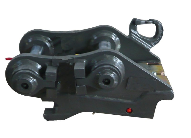

Why not use a solution made for excavators and then make an adapter from that to the tractor quick hitch?one-tp-attache-rapide-hydraulique-s30-1.jpeg
   / Has anyone converted a full size backhoe to a quick attach bucket? #6
Or was the plan to use it for general digging?

I have a 420 ford industrial backhoe, and I thought about putting a quick change for the bucket to forks or whatever, I changed my mind and just put 3 hooks,(similar to the 4 hooks on your bucket), and use a 1and 1/2 inch steel bar across the top and hung the forks on that, it hooks up quicker than a quick attach as I don't have to get off tractor to hook it up. the down side is I cant see the forks most of the time. they do hang down about 4 inches below the bottom of the bucket, but still cant see them if there on the ground, In any case they are very handy, just yester day neighbor had me load shingles on his roof, so his son didn't have to carry them up a ladder. We are both in our 70s so don't like ladders anyway.
the grapple part , I have a Hyd thumb on the hoe and use it all the time .
Hope this gives you some ideas , Have fun, Stay safe.
Rich
