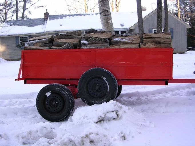

   / Has anyone built a log forwarder? #8
I have been thinking of making one for a while now. I made a smaller version a few years ago and would use the same design but increase the size and add brakes. As far as the loader goes you may be able to use the back hoe to load the trailer or a small grapple could be purchased and added to a home grown trailer.
There is a picture of the trailer showing how the walking beam suspension works going over a bump in the road. I have loaded this trailer with over 3,000 pounds of wood without any problems. The next generation will have a removable box for smaller material and bunks and stakes for logs.
Randy
