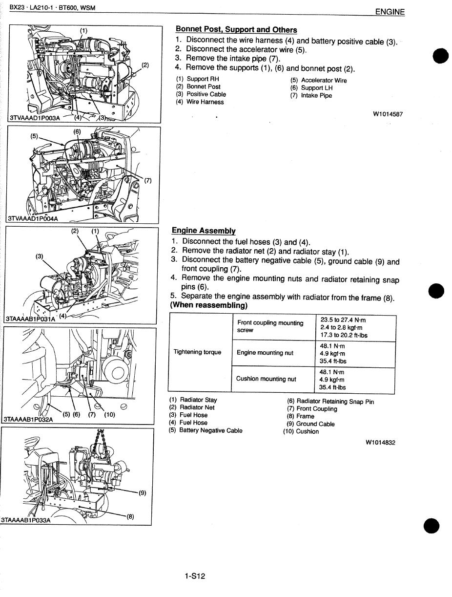

If Kubota built the engine assembly in the BX24 like the BX23 it may not be as hard to slide the engine assembly forward as we think.
In the BX23, the engine and radiator assembly are bolted together in a sort of subframe then its dropped and bolted into the main frame.
On the surface it appears that the engine/radiator subassembly can be unbolted from the main frame and moved forward without having to drain the radiator or disconnect anything with the exception on maybe the throttle cable and battery lead to the starter.
The grill guard and bonnet (lower engine cowling) will have to be removed.
An engine hoist or block & tackle setup will probably be needed to support the engine assembly when it's unbolted and moved, unless it can be slide an inch or so in it's mounting.
Theres been a few posters here that have R&R'ed the fan on the BX23/BX2230 and some have removed the floor pan, which involves the removal of the ROPS and seat while at least one poster was able to do his without removing the floorpan.
Now the 00 and 30 series BX's have a different design in the driveshaft/fan assembly and the moving the the engine is not required for them.
So basically, if you choose to take this mission :D the floorpan and associated assembly's have been removed and documented here as not being much problem at all, and you can do a search for them to use as a ref., but the moving of the engine assembly forward just enough to gain some clearance will be new territory.
The attachment is of the BX23 engine assembly from the WSM to show how it's mounted/dismounted.

I purchased my BX24 three years ago and before I had 20 hours on it I took out the fan with a tree branch. That's when I discovered the value of the Bro-Tech skid plates.
To replace the HST fan I removed the ROPS, operators seat, rear fender assembly, floor pan, front/engine hood and cowl, and yes the engine can be "disconnected" and slid forward. BE CAREFUL and make sure it's supported!
At the time I did not have an engine hoist available so I used a "strap/come along" with a 4x4 beam on top of the front loader.
I don't recommend this method. Using an engine hoist would be much easier.
You don't need to disconnect your radiator hoses, electrical, throttle cables (nothing) "but" only move the engine forward enough for clearance when sliding the fan off the shaft.
I did not drain the HST fluid and had no fluid loss.
The entire process took me about 6-8 hours, (it made a lovely weekend) with a break for lunch.
