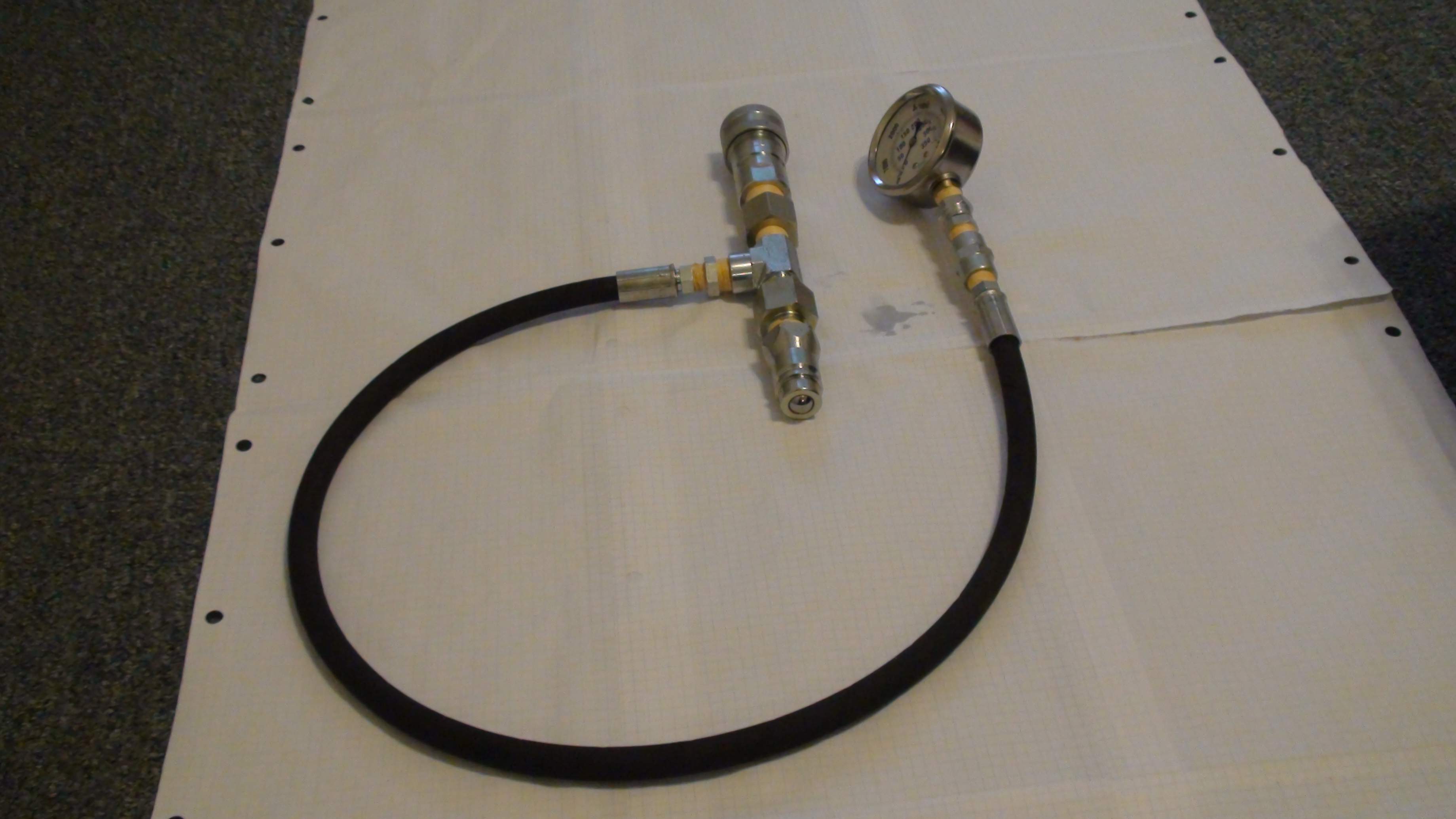

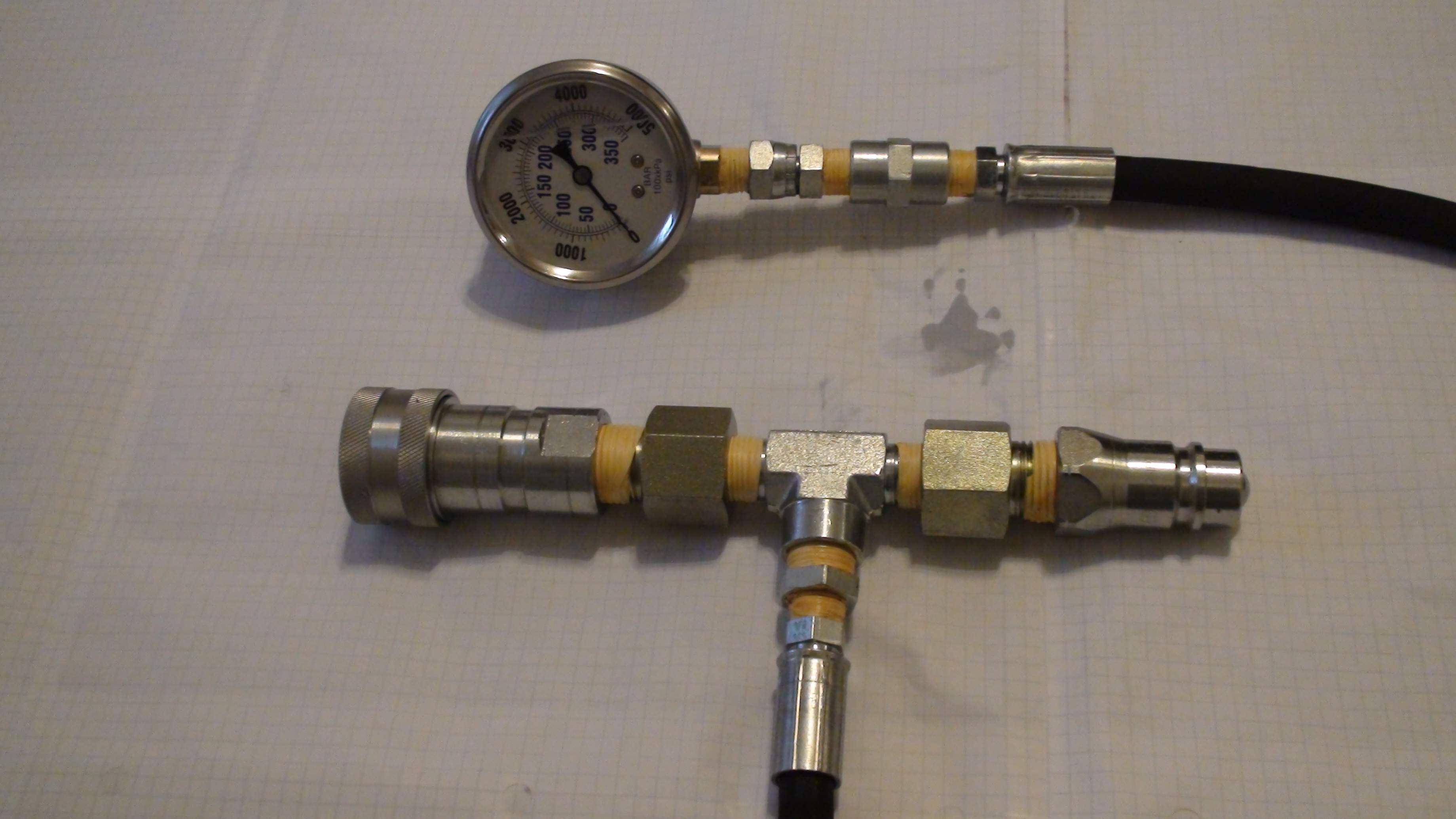

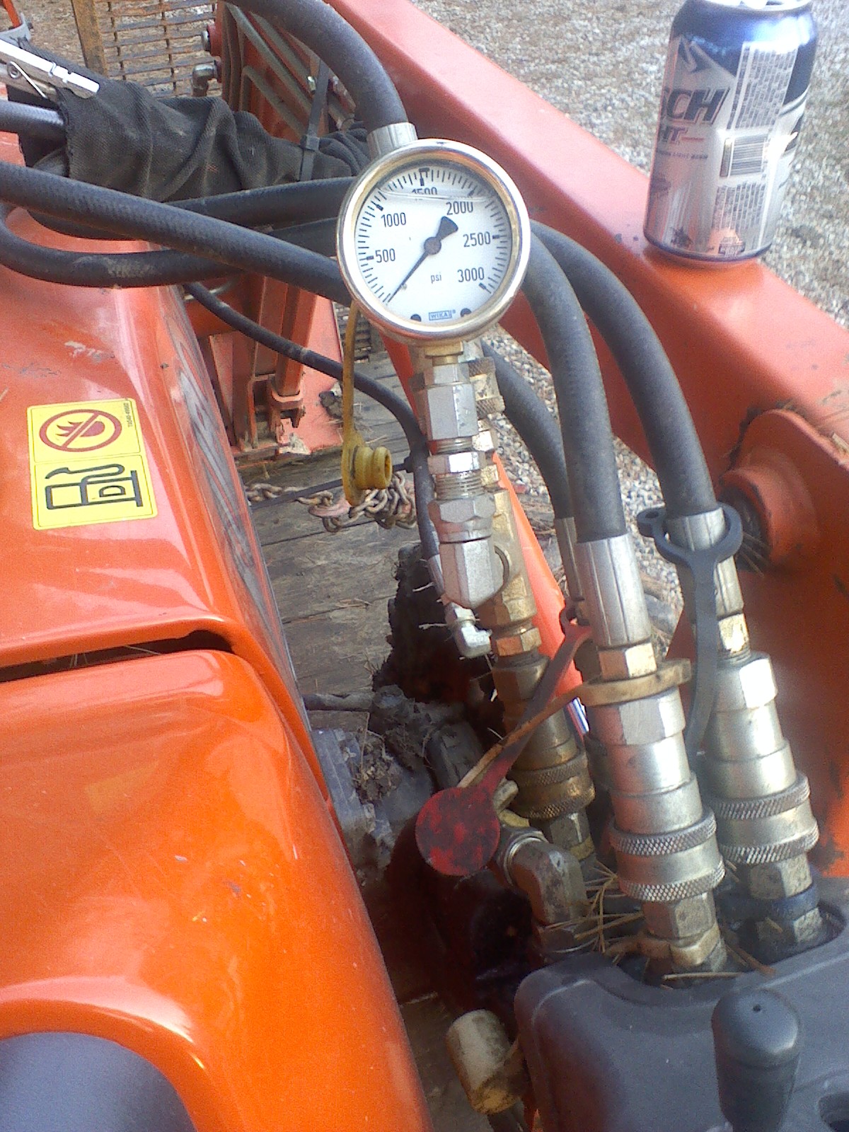

I did this to my Kioti DK45 HST. Conceptually it is the same process on any system I would imagine. Per my shop manual I was to have 2702 PSI at a rear remote at wide open throttle. I had 2600 PSI. The actual adjustment was a quick 10 minute fix from beginning to end.
My adjustment was on the outside, back corner of the FEL control valve assy- opposite the side where the 4 QD hoses are connected, which was very easy to gain access. I just had to loosen the lock nut with something like a 22mm open end wrench and turn the 6.0 or 6.5 MM allen type screw 1/4 turn to move it from 2600 pounds at WOT to 2750 pounds at 2500 RPM- my PTO RPM and the max I will ever have the RPMs to.
I built my assembly with all parts from Discount Hydraulics. It is a pass through type so I can hook it up inline to troubleshoot an operational system later. Or one can just design a deadhead system for a bit less money. I bought all two sets of each of the four QD coupling types I have on mine for connecting inline should that ever be required. The 1/4" hose is to allow the coupling to be connected to any fitting and allow me to be at the throttle, FEL control stick, etc. and still be able to read the gauge. I have another 18" long, 3/8" hose for inline connection adaption, should that be necessary.
You can build a dead head type assembly for $75 - $100 depending upon coupling types up to the $200 + I spent with all of the flexibility I built into mine with extra couplers.

Most all hyd system have one or several relief valve, and most can be adjusted.
When new, the reliefs are set at the factory for whatever reason.
Should you need to check the relief pressure or change the pressure, you need a hyd gage installed before the first valve.
Some relief have an adjusting screw, and others have shims to adjust the pressure.
If the machine is still under warranty you can check it, but do not adjust it over the tractor specs.
Here are some hyd test sets one can build for about $30.

I like your can of "lube" in the third photo :)

For the LS I think you can just disconnect the hydraulic QC hoses for the loader and plug in a gauge then operate the handle (it could be the same on other tractors also) the set pressure should show on the gauge.
