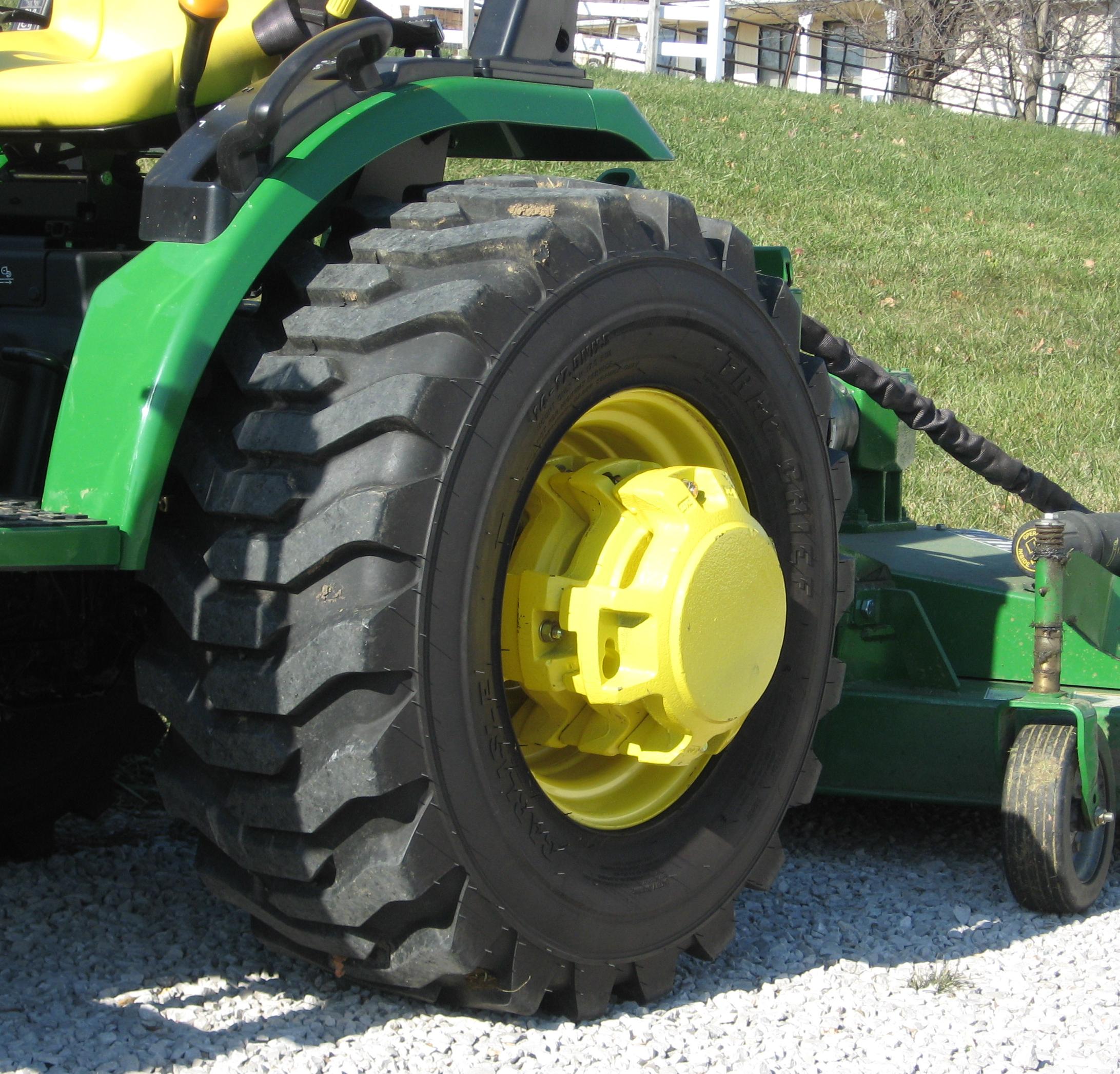

Will,
The wheel weights are 60 lbs each, and I now have three per side.

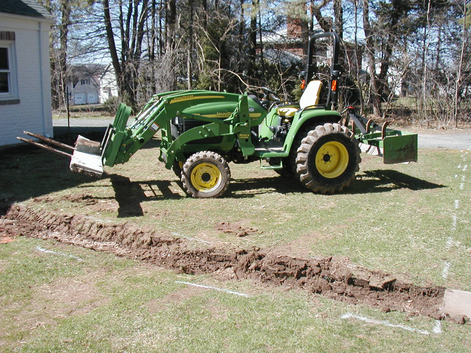

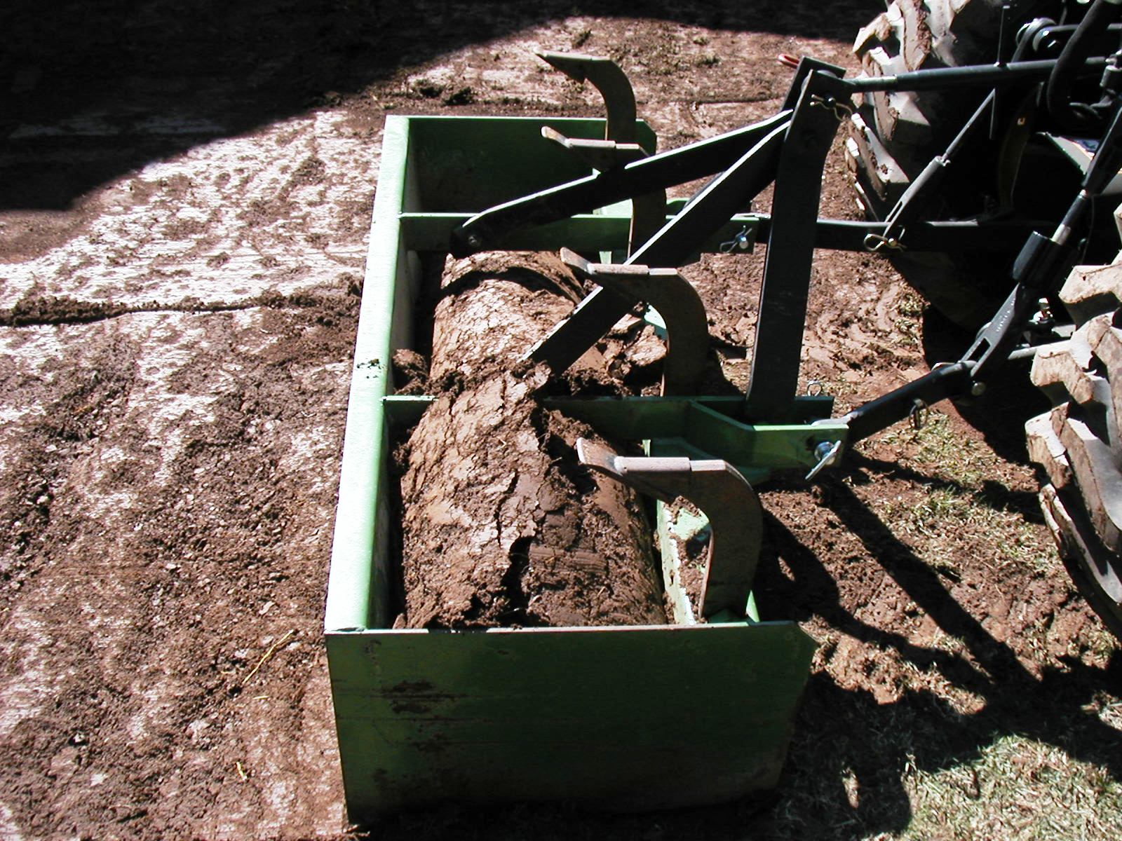

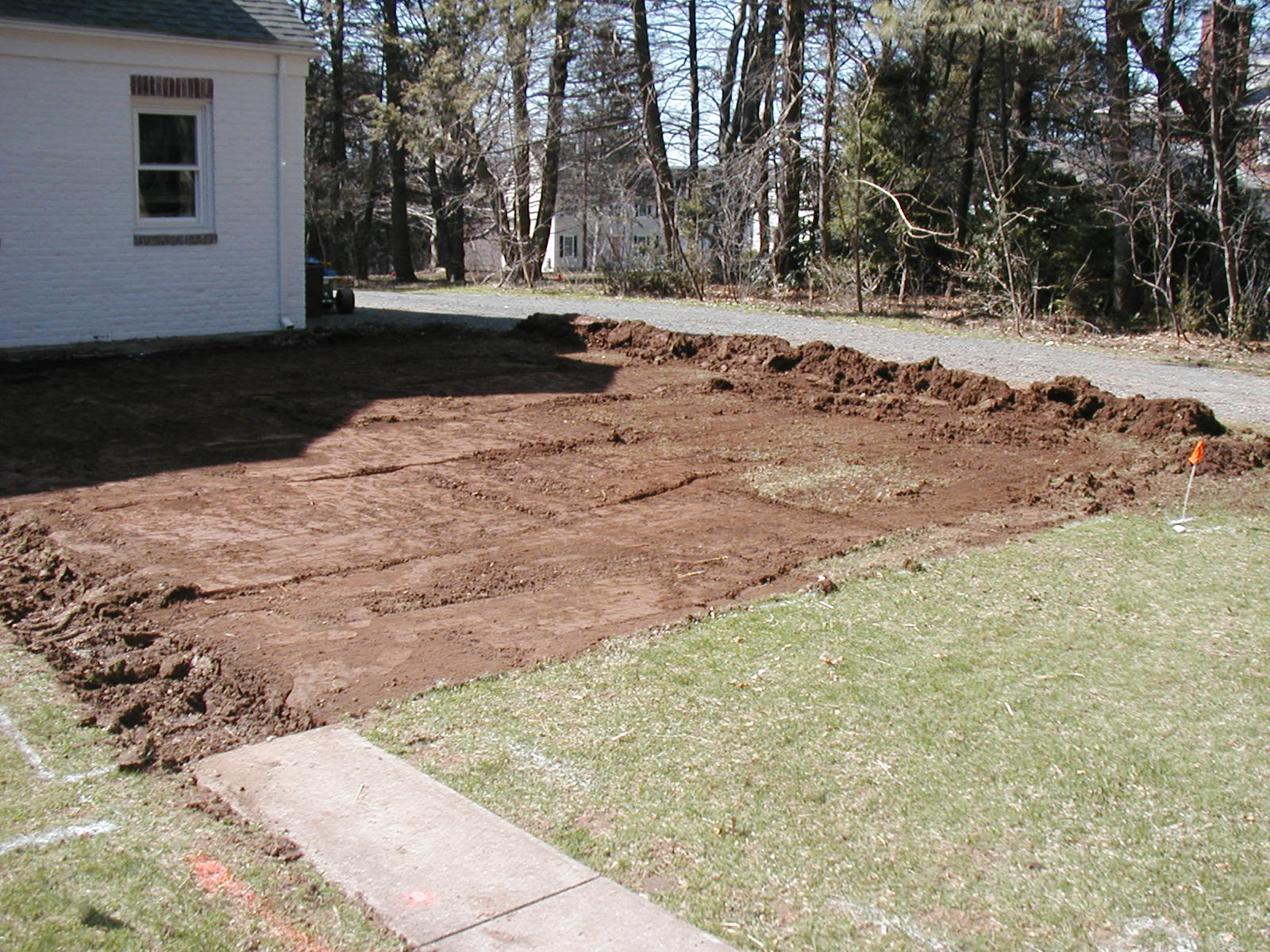

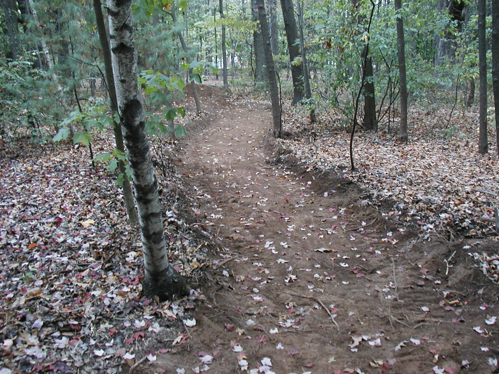

I definitely use the weights to aid with digging on almost every job I do with it except just removing sod. and if someone extra is standing around we'll usually add extra human ballast.
guess we have some hard ground here cause even with the rippers all the way down and all that extra weight it still just scrapes the ground in some cases and requires several passes to get down even a little.
Some of my projects have been in woods dirt with roots, so that explains alot, my box is a HD 5' I now have rear remotes and am gonna get a hydraulic top link which should help with dialing in the sweet angle, even working the rippers back and forth while pulling may help.
