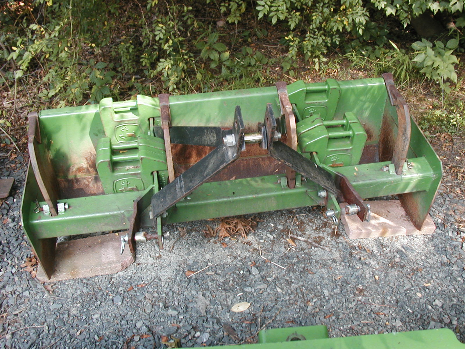

Extra weight helps the box take a bigger bite especially in hard ground where without the extra weight the box will just scratch the surface.
I do the same as Runner and just hang the suit cases on.
JB.

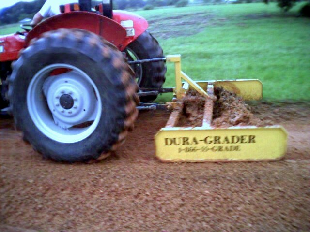

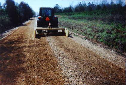

I own a dura-grader implement which has holes in the sides so I can bolt
extra wieghts to it if needed, but it cuts very hard material without the use
of wieghts. If you have a drill you can drill two 5/8 inch holes in each side of
your box blade then buy you about a 10ft piece of 1" x 4" flat bar. cut the flat
bar up in lenths about the lenth of the side of your box blade and drill the same holes in the flat bar. then all you have to do is bolt as many lenths on it required to do the job and it would look nice if pianted.
