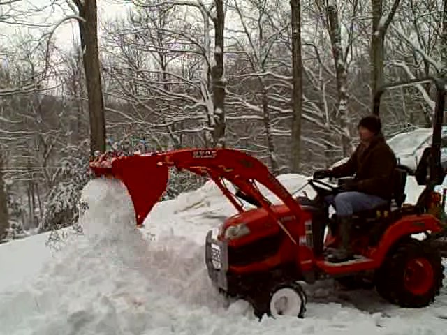

For us Yankees up here in the north, our BX-25's have ac for 4 months during the year.
