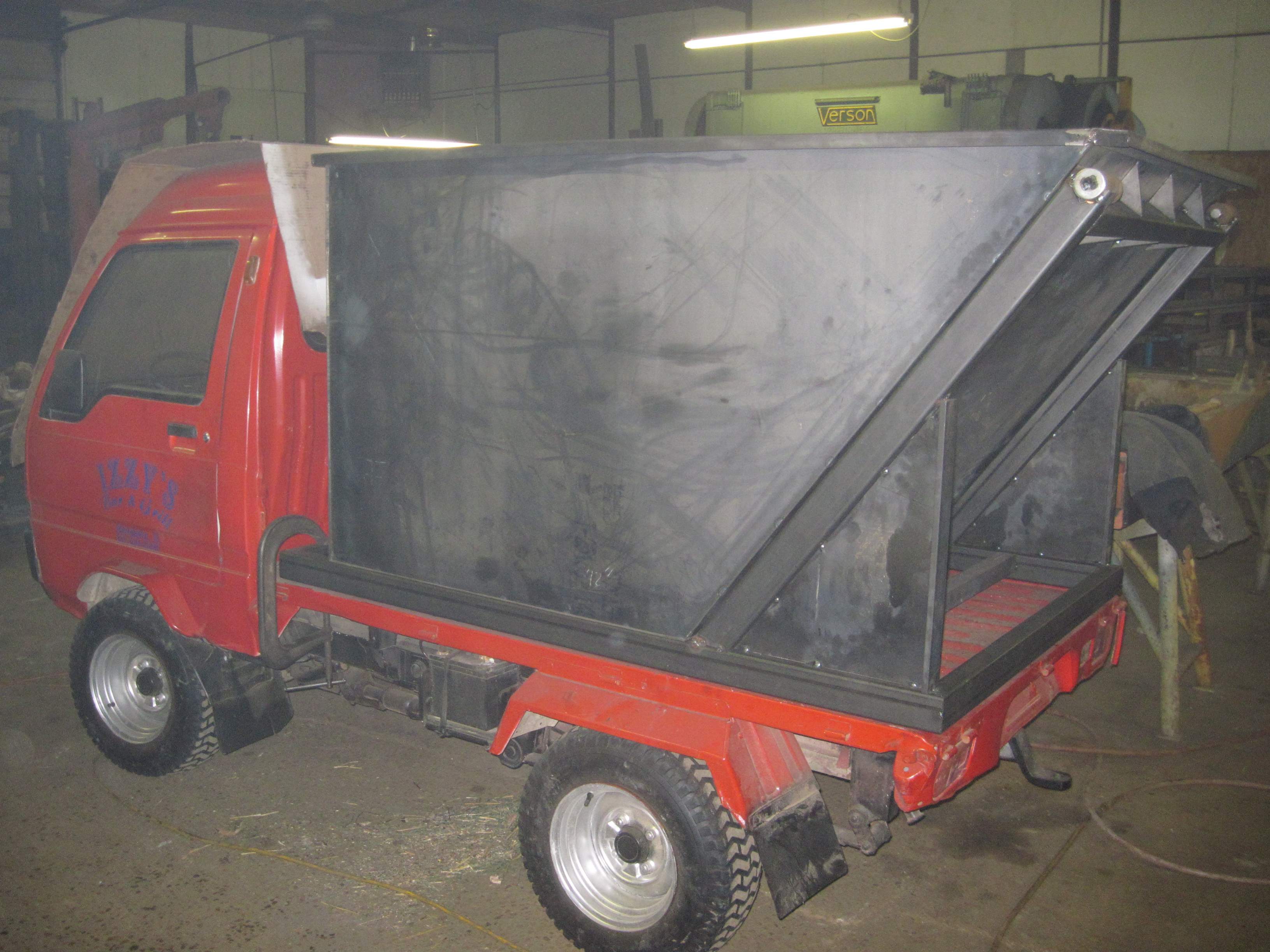

New on-going build ... should be completed in 2 weeks. 12 volt elec./hyd. pump, will dump into a roll off dumpster, will have access side door. Sold to a roofer for tear-offs and another to a campground.
Nice looking work there and I see many practical uses for such a machine at camp sites and other such places. Great thinking!
