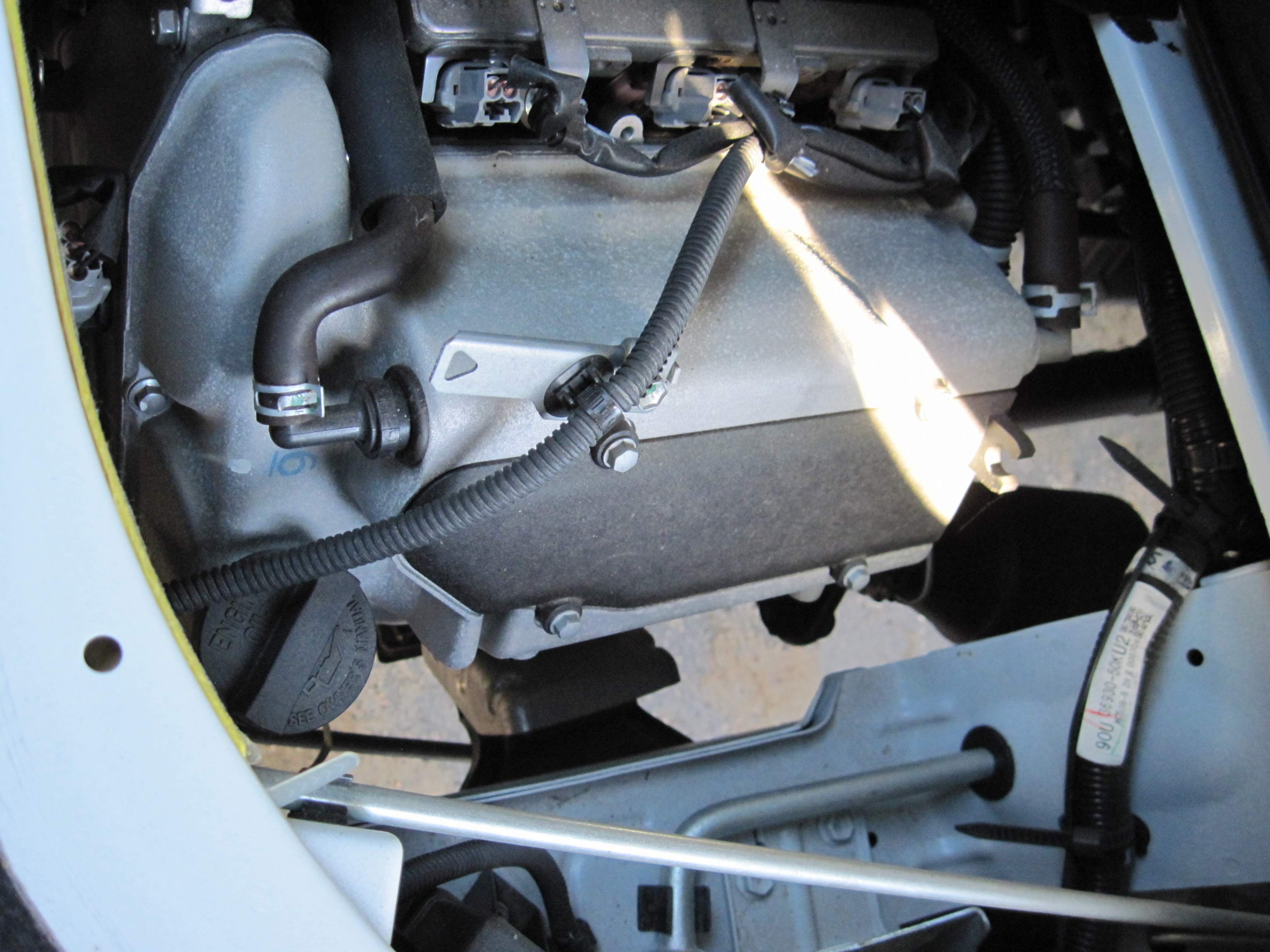

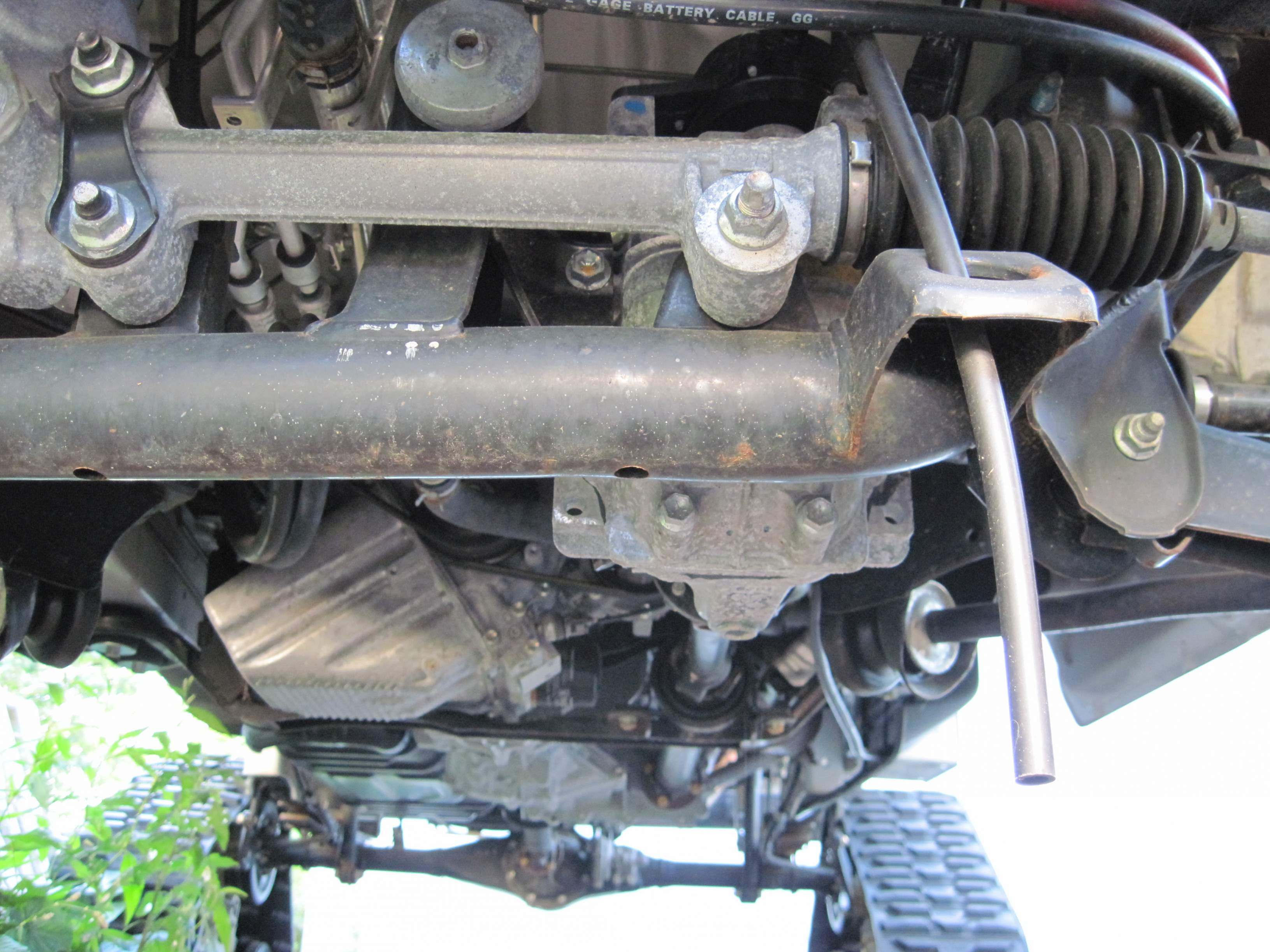

Subaru, 660cc, 4 cylinder

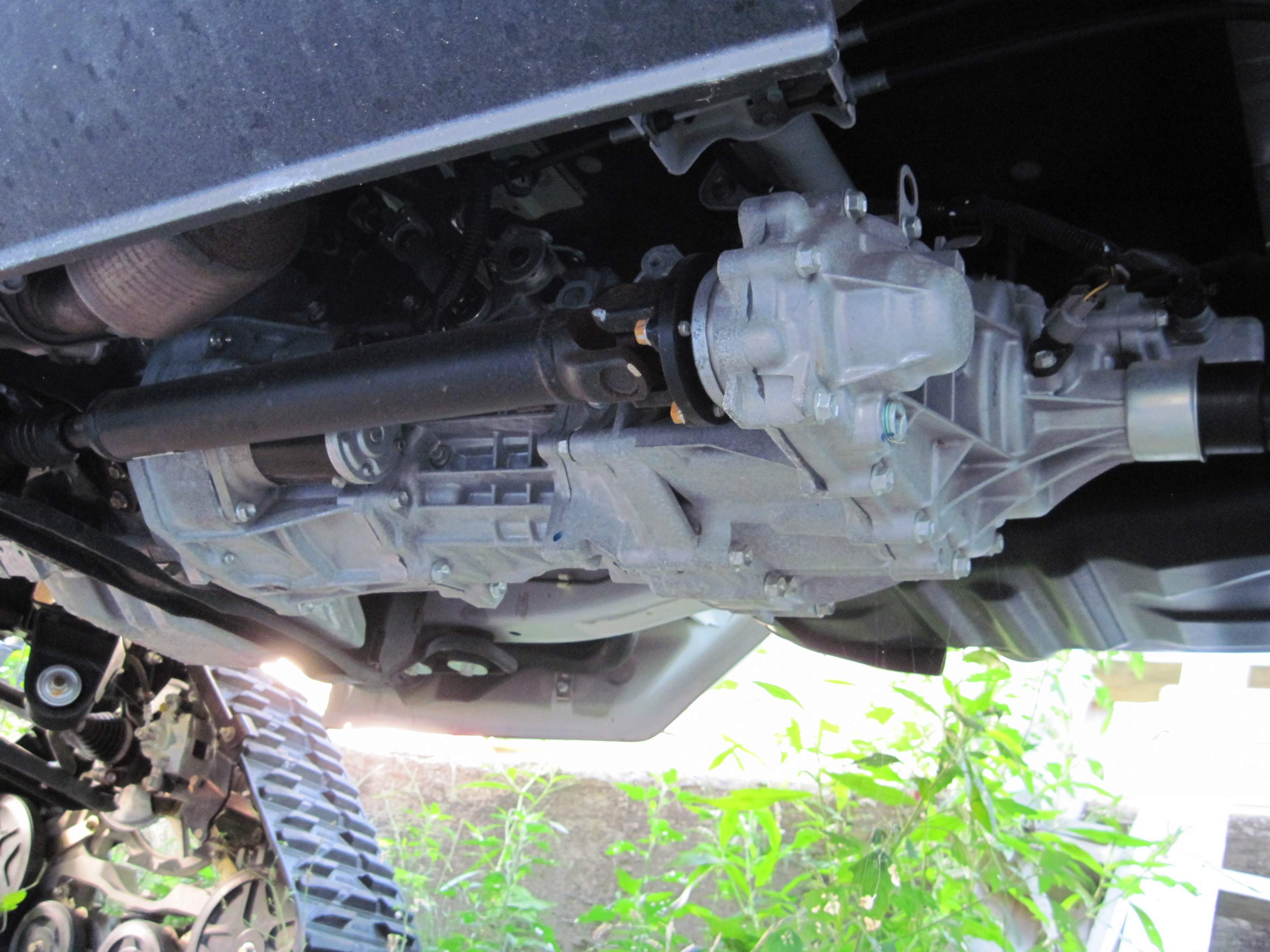

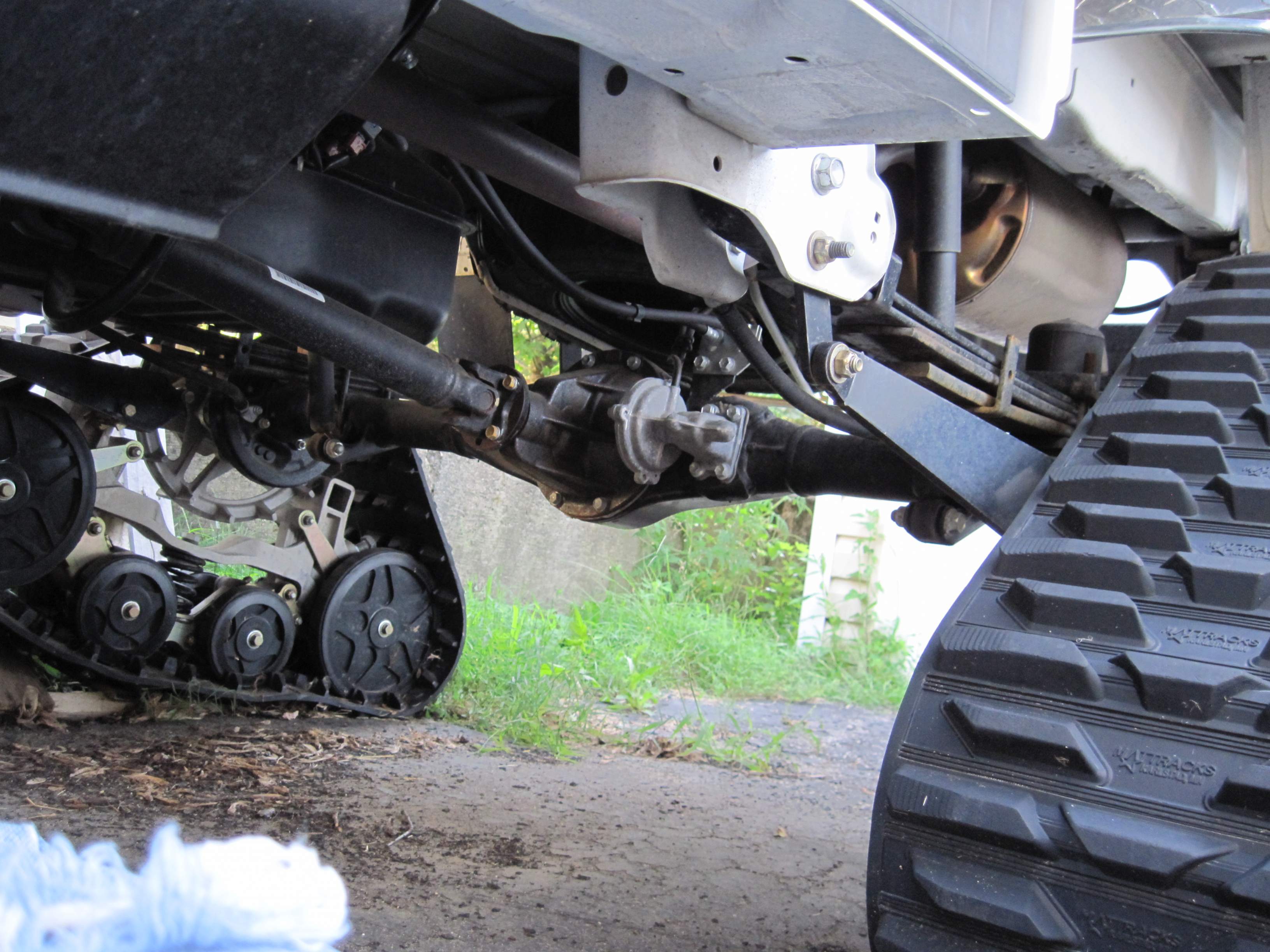

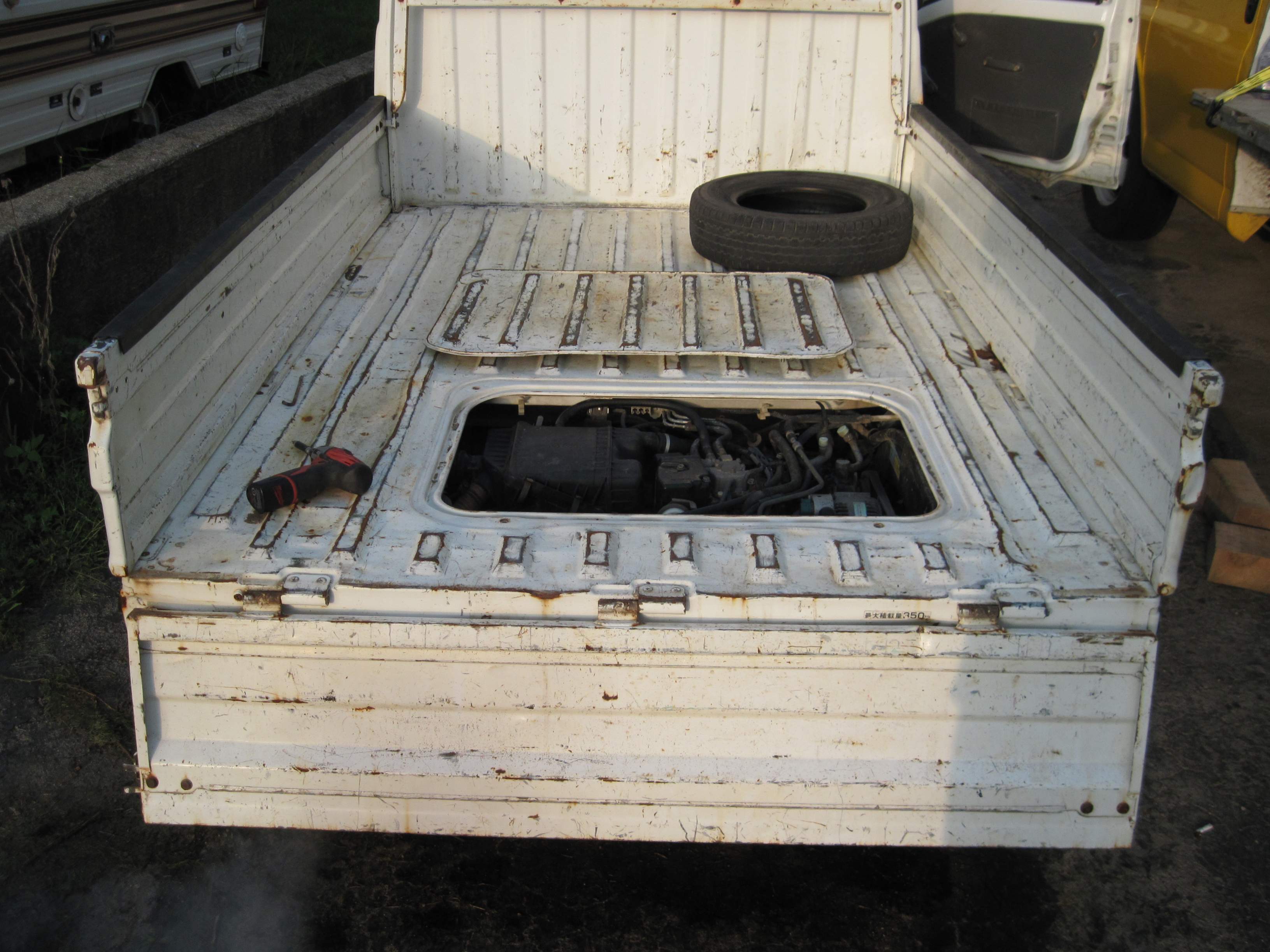

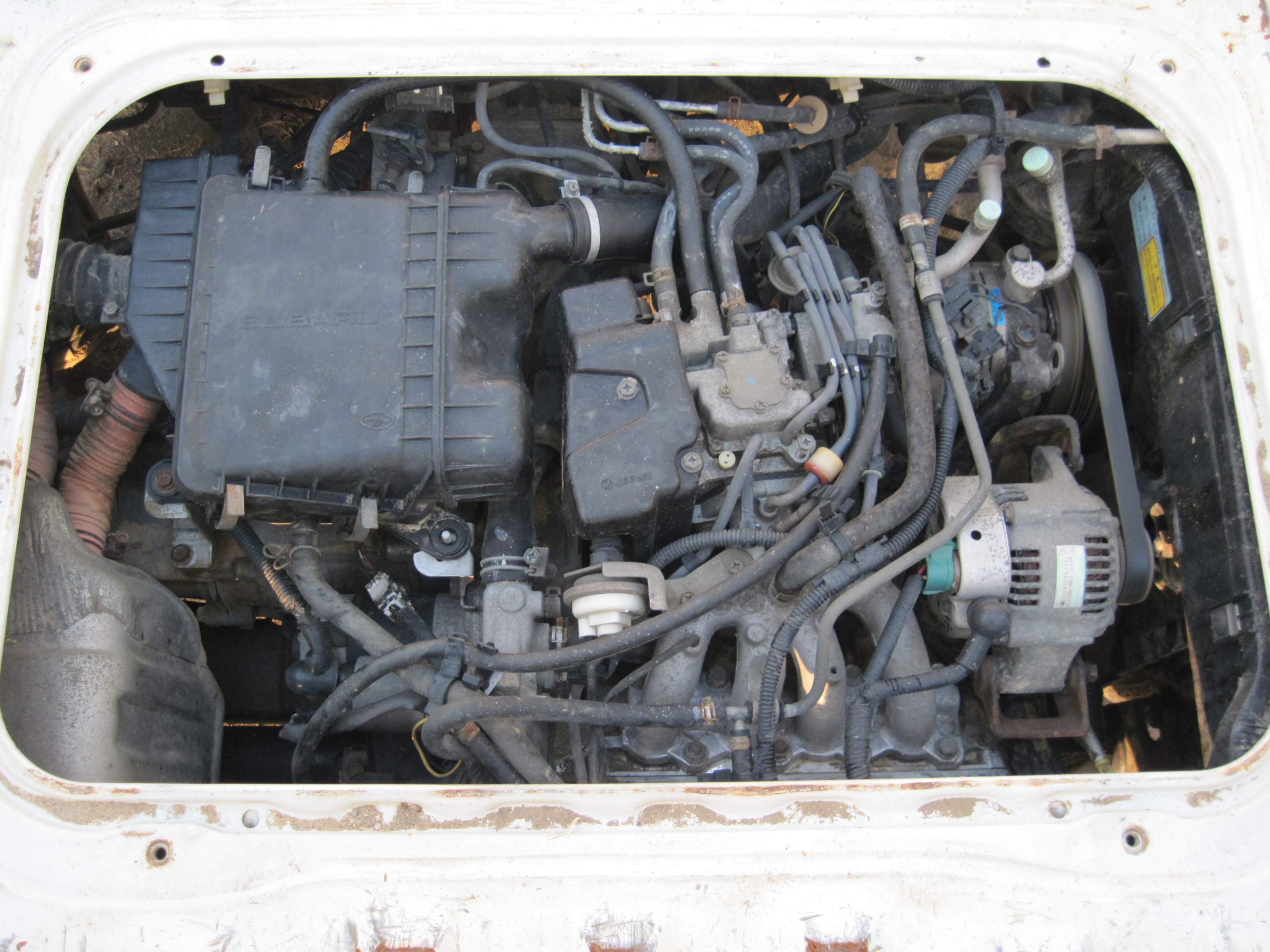

1999-2010 Suzuki, 3 cylinder, 660cc, fuel injected, 12 valve, engine located under seats. access panel in box
