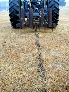

Best picture I could find.One man was at the start point unrolling,the other running the equipment.
Minimal soil disturbance doing it this way .Run wires for remote valves at the same time as you run the pipe. You can do a search for; mini/maxi sneaker,vibratory plow,pipe puller,cable puller,pipe plow.

/ Has any one built a sub soil wire puller ?? #17
I had it made. Here's another picture of it in use.
