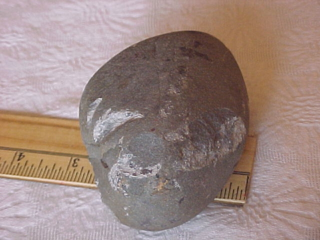

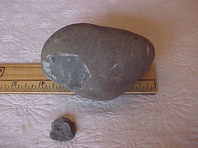

Winter has gone bye, mostly. A few days ago, I put the batteries back into the mower. I had raked some leaves from the flower garden area in my front yard and also some from along the house.
On April 12, I got the mower out and was mulching the leaves up. Was almost done when suddenly the whole machine jumped and there was a horrible noise. I quickly shut off the blades and turned off the switch.
Got off of the mower and look on the ground behind it. There was this rock:
Now I tell you this rock is NOT a rolling stone. Some one planted this in my yard with hope that it would damage my mower. Well it did. Mangled both blades and may have bent one of the motor shafts. I straightened out the blades as good as I could and ground off the big dings in the blade.
It could be that whom ever did this doesn't like my political leanings as I have a big Trump flag in my front yard.
I did also find a smaller rock in another part of my yard.

You sure it’s not just a rock that worked its way up? I don’t live in a rocky soil area and get one every now and then.
