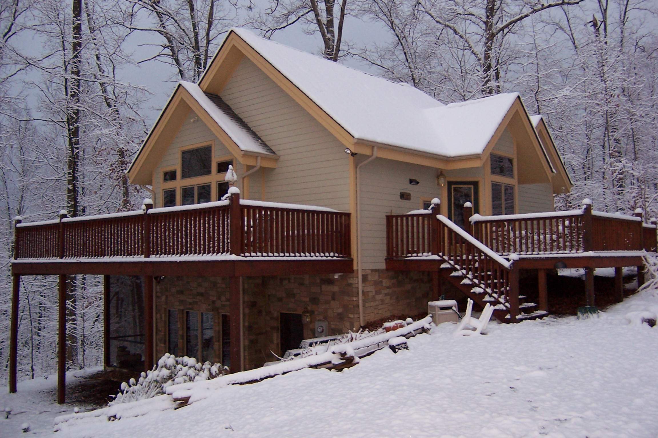

We built our home in 2001 with Hardieplank siding and Hardie trim pieces. Could not be happier. It looks like wood, wears and holds paint as well as anything I have seen. Been ten years and all I do is wash the siding. I wish I had been smart enough to use composite for my decks, then I would have been happier.
I have attached a pic from last winter to give you an idea.

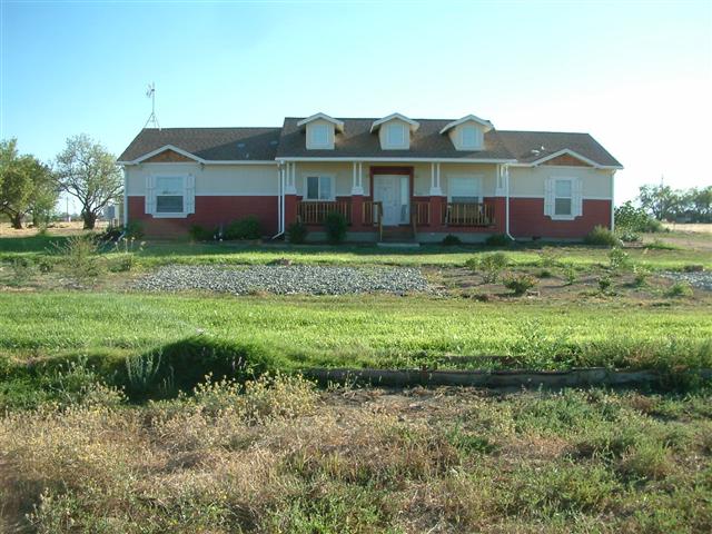

My double wide manufactured home has Hardiplank (red) and Hardipanel (white) siding. Installed in Sep2005. No problems so far.
