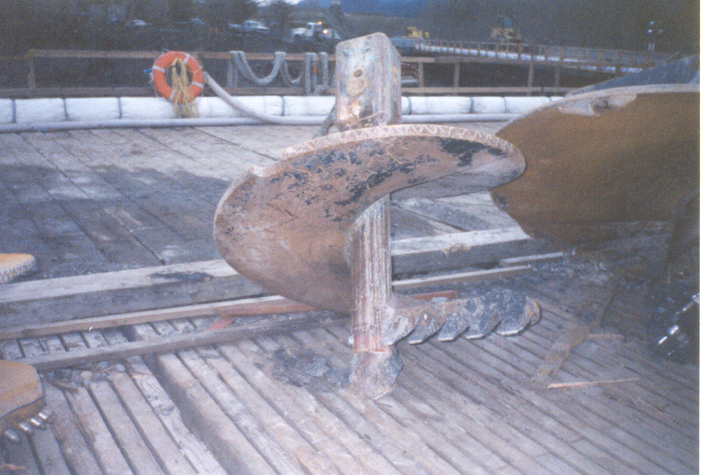

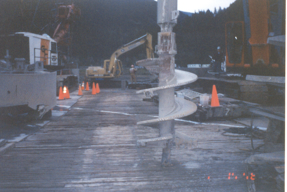

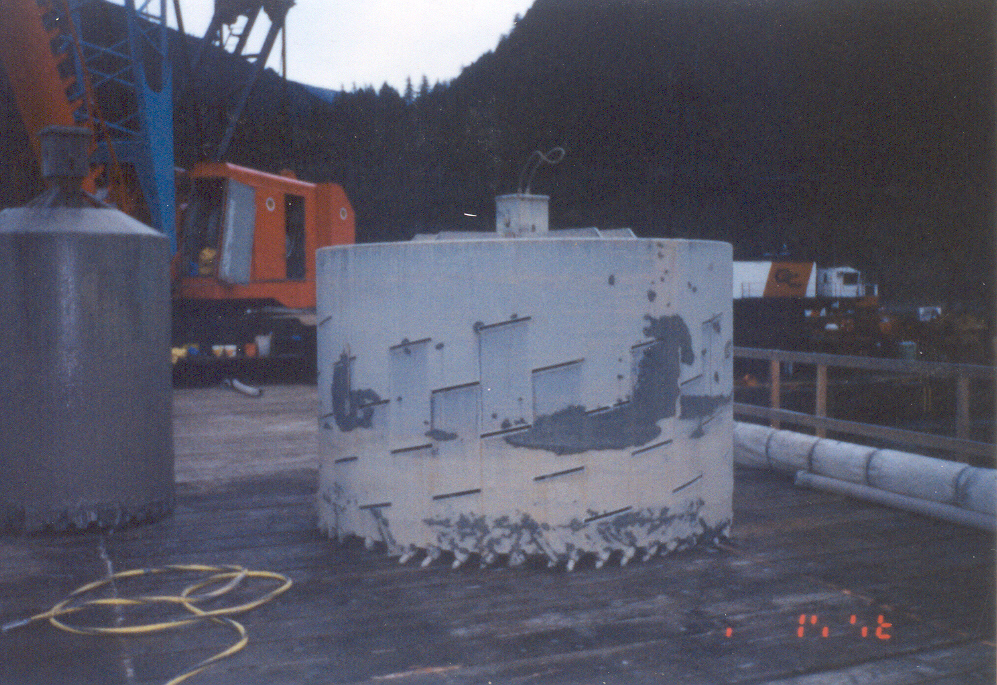

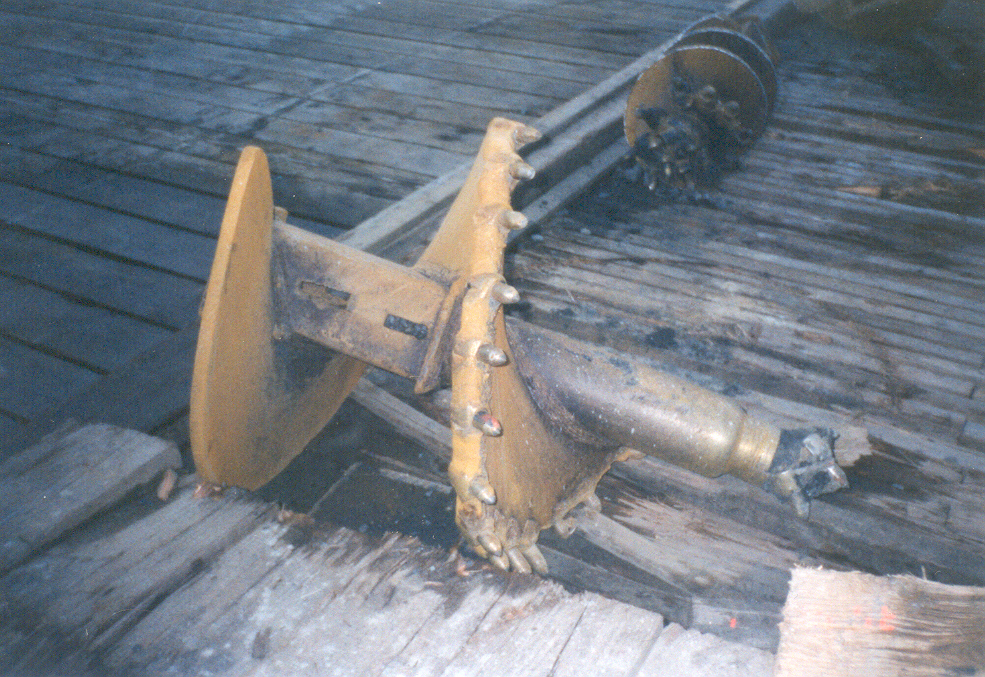

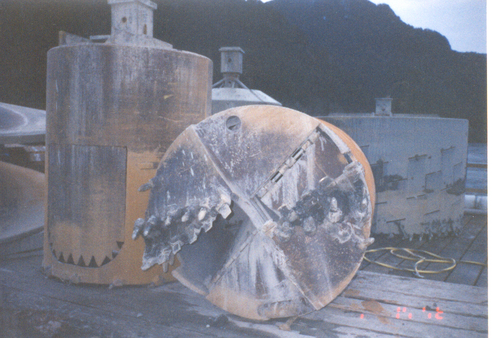

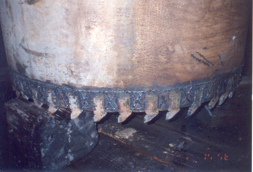

Wish I had a dollar for every pound of hard facing rod I've run. :D
   / Hard surface rod #6
In that case you'd only have a dollar which which you might be able to buy a cup of coffee in some places. Now if you have applied many pounds and you asked for a dollar for EACH pound you might have enough that will buy you a little more than a cup of coffee, even at Starbucks.
   / Hard surface rod #7

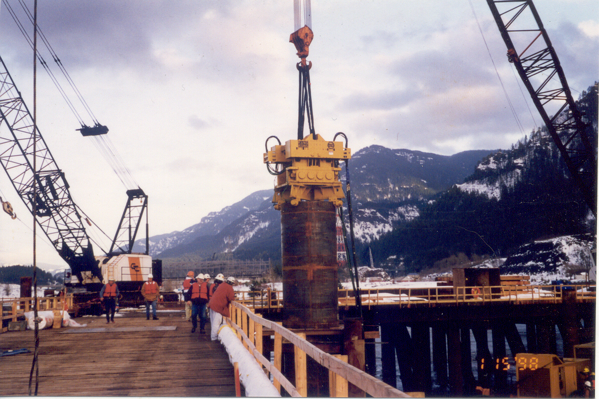

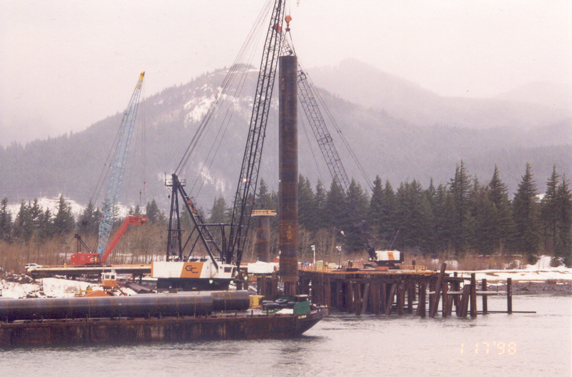

I worked for years drilling tiebacks, and solider pile. The augers need hard facing all the time.
Those auger pictures were drilling 200-feet into solid rock. For a bypass outfall around the Bonneville dam on the Columbia river.
