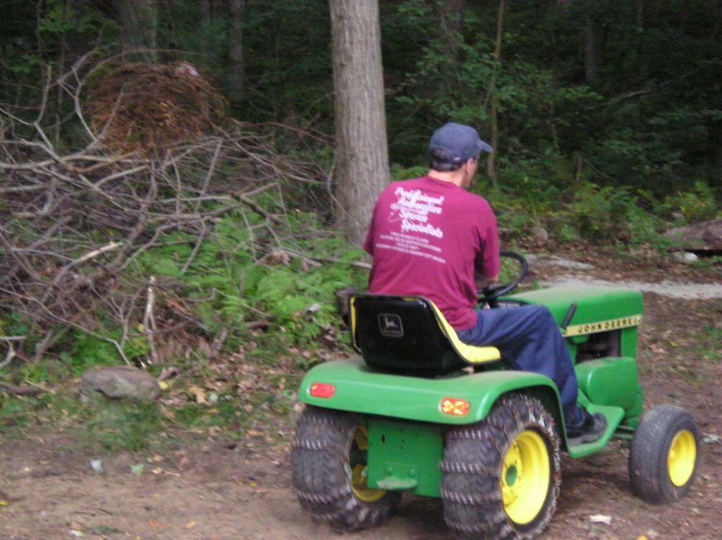

hard starting Deere 110- any suggestions?
   / hard starting Deere 110- any suggestions? #1
irwin
Veteran Member
Feb 17, 2007
1,262
SE Conn
2004 Kubota L35TLB, '89' Cub Cadet 1541
Well, for a couple weeks this, new to me, "69" 110 would start after cranking for 5-15 seconds, now not so much. Will crank and crank, smell of gas, I'll remove plug and clean, crank engine w/out plug, put it back and maybe will start up. (Runs fine when it starts). Not exactly my idea of a useful machine..
Is there something I'm not doing? I put a new plug in it the first time it happened, but no better (old plug looked ok). Do these coils have a history of getting weak with age?
I'd hate to have to use starting fluid on a good engine, long term ether use is not so good for cylinder, rings, etc.
Hopefully I'd like to be able to jump on and trust it to start up quickly, like the rest of you guys we want our work machine to behave.
Any ideas.....???
BTW I'm ordering a service manual for it monday, along with one for my 770. (Trying to get manuals for all my tooltoys, )
