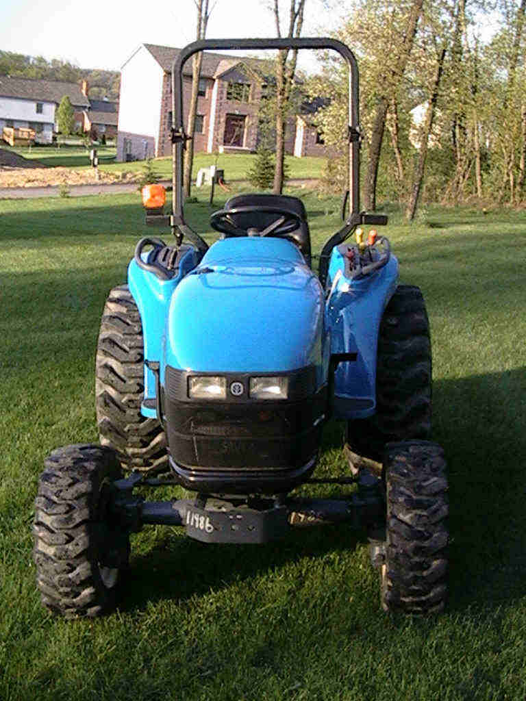

Just thought I would post a picture for those of you who never saw the 1925.

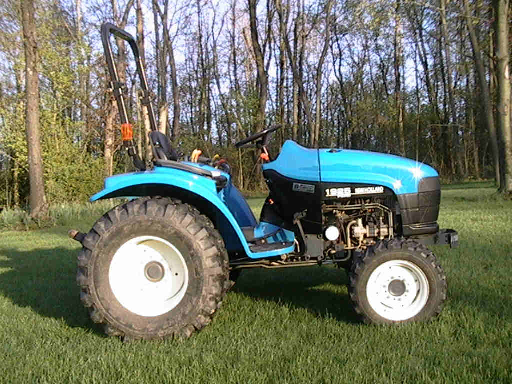

From the front

MeanGreen, are those recent photos? That tractor looks new to me. Very nice machine! /forums/images/graemlins/smile.gif
...and are you a Steelers fan? Your tag name has me curious. When Mean Joe Green was in school, he went to North Texas State Univ. which still calls itself "Mean Green" as a nickname. Then, of course, he went to play for the Steelers and they kicked the Cowboy's butt so many times I can't remember all the money I lost because of Joe Green and the Steel Curtain.
Anyhow, your name may not be associated, but it sure has a familiar ring to it. /forums/images/graemlins/cool.gif
