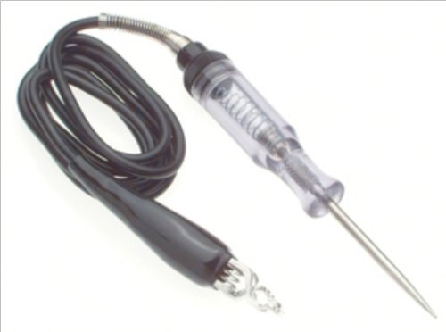

I just posted this in another thread but the best 12V test light I ever got came from Harbor Freight a few years ago.
Above is a generic picture but my HF one has one with a long cord and a long and sharp metal probe. Works great. I didn't find the one I have on-line just now but saw it in the store a while back.
Yah, mine was great too- until some numb nut [yours truly] left it under the hood and drive off with it, where its cord got caught in and decimated one of the [luckily] 2 cooling fans in front of my Honda Element's radiator.
Actually, it still works pretty well, you just have to watch which part of the cord you hold, because bare skin on bare copper apparently messes up the continuity of the tested circuit.
Eventually I'll either tape over the bare spots, or break down and buy a new one.
It only cost me about $40 for a new cooling fan assembly -cheap lesson to teach me to look 3 times to make sure all tools are out before shutting hood [again].
