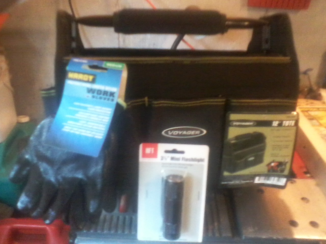

Now I had to go look up the Boss man early today with my all weekend flower sales money as he was headed out on vacation for the rest of the week (figured he could use it. ;) )
And darn if the HF store isn't right nearby the main business front! :eek:
So the Harbor Frieght haul of the day is...
#61471 tool tote with 20% off
I liked the bar handle design of it, and similar larger totes at HD are more money. Looks to be decent though a bit small...12 outside pockets and 6 inside, heavy duty nylon stitching seems okay guess time will tell. I pulled on every pocket to see if it would fall apart. :rolleyes:
Pretty neat the way the inside flaps fold up and attach securely to the ends to support the bag wide open (pushed back down inside the bag folds flat)
Plus a pair of the cheapie $1.99 #97404 Hardy coated nylon gloves . Similar ones sell 2 pr for $5.00 at flea mkt. The tag says they are 60/40 nitrile/nylon but the ad says polyurethane coated :scratchchin:. They do seem to have more rubber coated feel than either my Gorilla Grips or the micro foam nitrile Liberty G Grip F4600 gloves I have. I really like both of those the Liberty is great for garage work and the lightweight GG are perfect for greenhouse type work with constant water and dirt as they dry super fast
So I figure they be ok for doing things like oil changes.
And then added the freebie led flashlight
Total 3 items out the door was less than advertised price on the bag :D

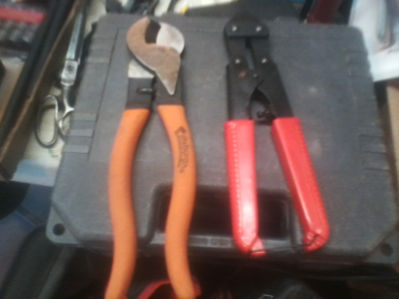

Ditto on the 10" cutters.. Dont know about bike cable but they cut HG fence wire and 1G service wire with relative ease.. Good purchase.
I have a pair of them they do what I want them to do ok.
Mine are orange :D
Have some a couple of pairs of small (9" maybe?) boltcutters style that are also pretty handy for heavy fencing wire or small rod.
Funny how I keep being reminded of my old HF purchases :D
