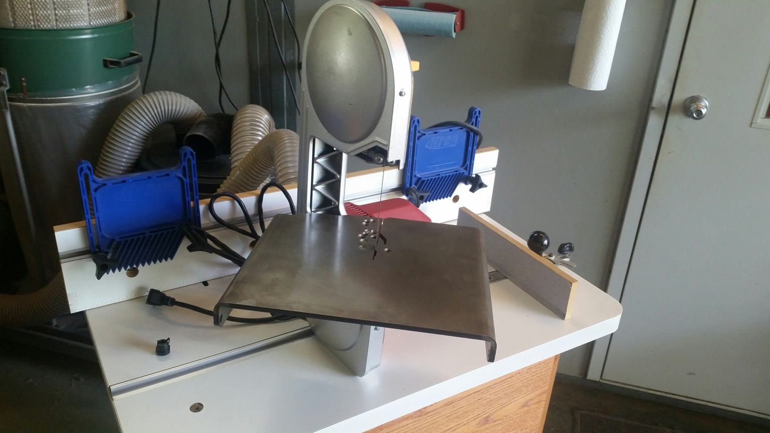

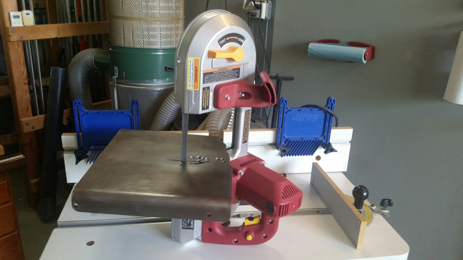

Thomas, if you wanted to get one of the SWAG version 3.0 tables that have miter gauge slots the new BS would work. Only the version 1.0, no miter slots, works on the previous model.
I've mounted my V 1.0 table to my HF band saw and working on a stand for it now. This stand will be 3/4" birch plywood but, want to build another one later with some steel square tubing.
I'd really like a table with miter slots for greater accuracy so, the $99 coupon on the new HF BS is very enticing. If I do succumb and go get it I'd order the Swag V 3.0 and make someone a great deal for the one I have now.
Are you sure the HF band saw fits the Swag V3 table. I thought the V3 fit only the newest Milwaukee model and was designed specifically for it. I have one but have never tried any other band saw. I know my older Milwaukee band saw doesn't fit.
   / Harbor Freight Tools that don't suck #5,639
SWAG Web Site says it does. See picture #4.
SWAG V3.0 Portaband Table
I believe you are thinking of their version 4.0?
