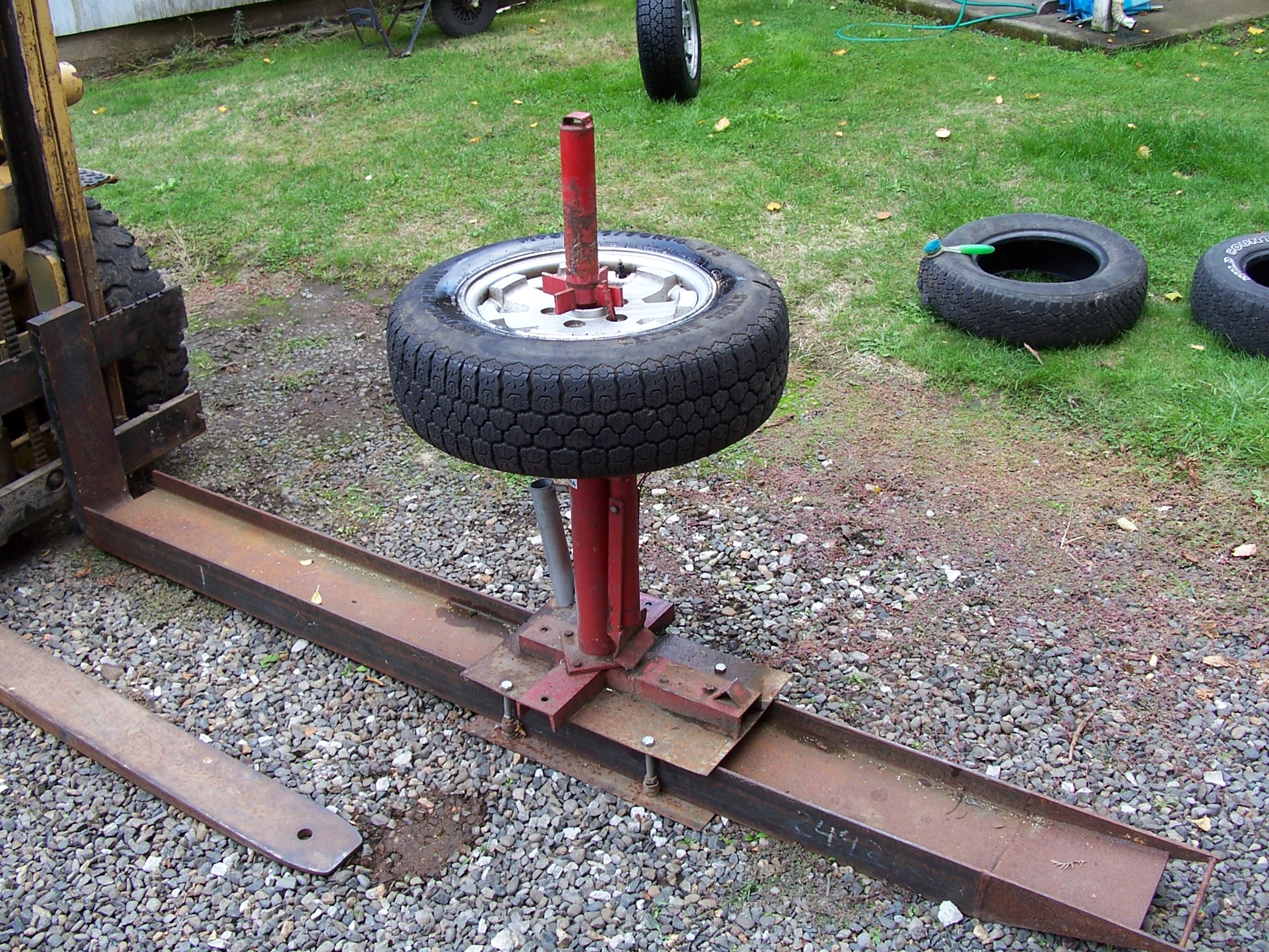

A permanent mount where you can get all around it would eat up too much floor space, so I made a quick slide on base for one of my fork extensions. Doesn't take long to set up, is solid enough to use easily and tucks away in little space when not in use, which of course is most of the time.

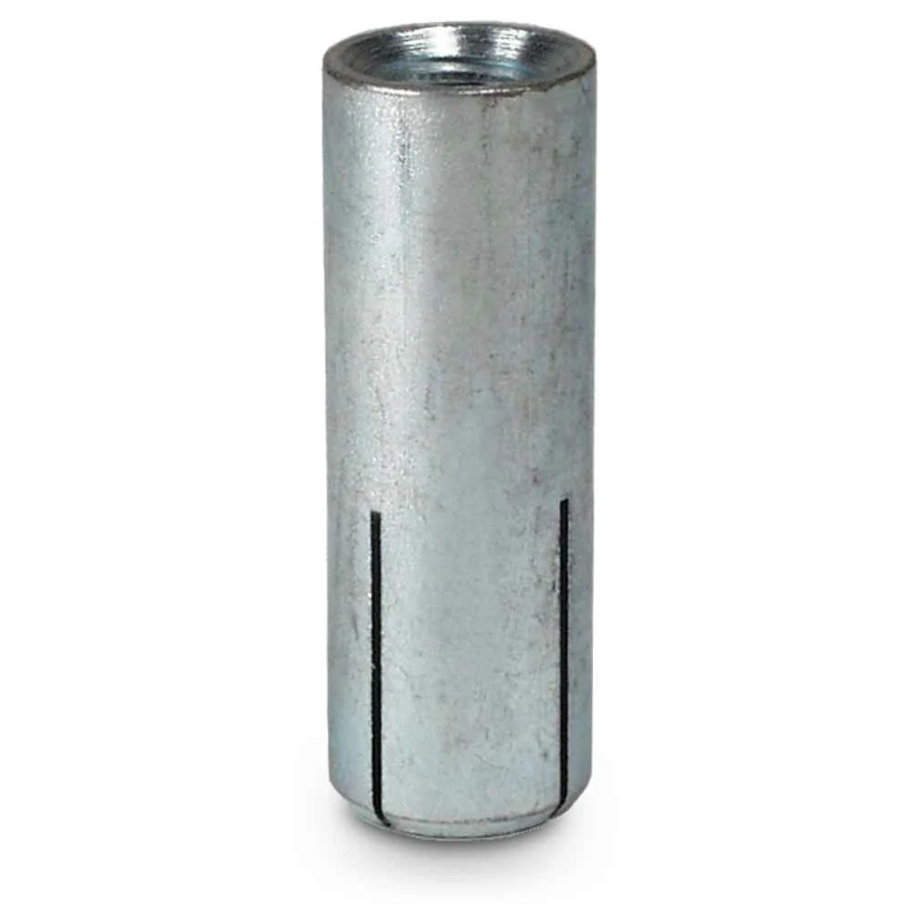

I've done a bunch of tires with mine, I've beefed up some areas that were starting to bend from use. I also added a duck bill to aid in removal of the tire, there's tons of YT vids on mods for these. I put threaded anchors in cement to mount but actually have it bolted to a thick 3x10 right now as I used it to replace some TPMS sensors. This is good enough to break the bead but wouldn't cut it for removing a tire from the rim. Small tires are generally tougher to get off a rim but if just adding a tube then all you need is to break the bead which is pretty simple with this machine. Soapy water helps.

I did that with mine at first, then put in some concrete anchors. Just find them, blow them out when ready to use it.
