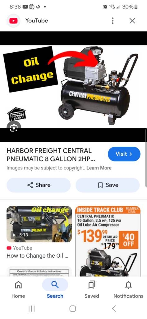

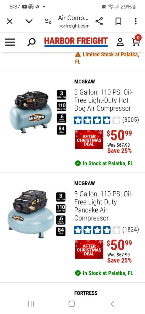

My old Central Pneumatic compressor has been acting up. It seems like a start capacitor, but frankly I haven't dug into it yet, it was dark, and like 30 degrees last night. I did see the McGraw 3 gal light duty compressors are on sale for $51 right now. I was thinking about picking one up while I dig into the 8 gal. What's yalls impression on those small 3 gal models?
   / Harbor Freight Tools that don't suck #16,012
My old Central Pneumatic compressor has been acting up. It seems like a start capacitor, but frankly I haven't dug into it yet, it was dark, and like 30 degrees last night. I did see the McGraw 3 gal light duty compressors are on sale for $51 right now. I was thinking about picking one up while I dig into the 8 gal. What's yalls impression on those small 3 gal models?View attachment 2158701View attachment 2158702
I have one. It’s good for filling tires and running small hand tools like brad staplers, and that’s about it. I also have a 20 gallon Central Pneumatic for more taxing jobs and so far it works well.
