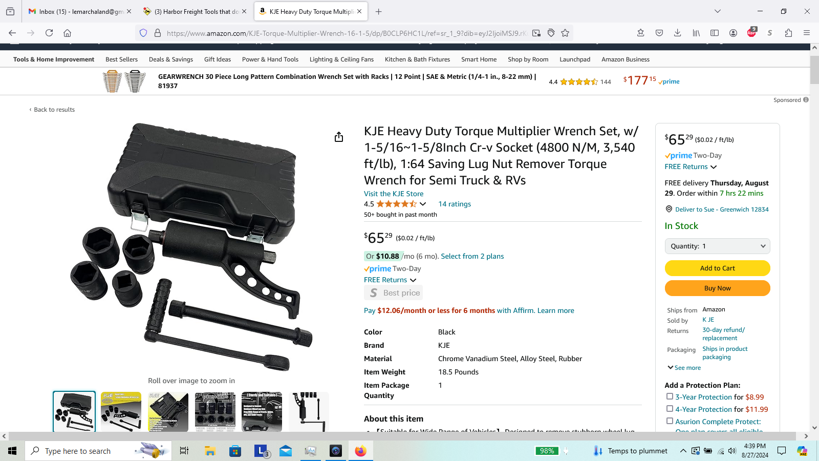

The torque multiplier tools also work very well, I have broken several bolts with one like this;
May have to try that Torque multiplier.
Have my eye on one of the Ultra Torque. I don’t have any 3/4 inch sockets anymore (since we sold the dairy farm), but maybe need to get that 3/4 just to have and add sockets as I need them. Can always get a reducer to run 1/2 stuff but that tends to eat into the capability some.
