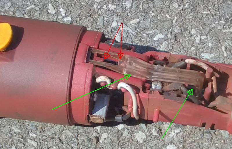

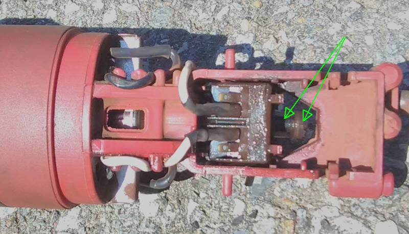

My older Chicago Electric 4" grinder (red with yellow paddle switch on the side) gave up on me this morning. Worked for a while, set it down. When I picked it up a few minutes later, nada. Acts like the switch, but I suppose it could be the brushes. Pretty sure I have a set of those ... IF I can find them.
Which should I try first?
I would check the switch first - I had the same problem with one of their circular saws, altho it wasn't that old - it worked fine a couple times, then dead. When I opened it up, found 2 of the 4 wires going to the switch connections (socket with set screw) had never been tightened. Couldn't believe it had EVER worked - Tightened ALL of 'em up, been fine ever since... Steve
Turn it on and try playing with the cord near the end of the grinder by the strain relief. I've had multiple HF grinders fail because of a broken wire in the cord. Usually will start up when flexing the cord a bit. I take the grinder apart, trim the wire back 6 inches and reattach.
It's even weirder. Finally got the ambition to open it up. There's this clear plastic thingamabob that goes from the paddle to the switch (green arrows). It had simply slipped off the switch. Hard to see in the pictures, but the switch is at the wires and there's a small black button that is operated by the clear pawl. Also looks like there should be a spring between the two pins (red arrows), but I don't see any sign of it.
Hooked the clear thing back over the switch and it works again. If it comes loose again, I'll glue that suckah!!!
