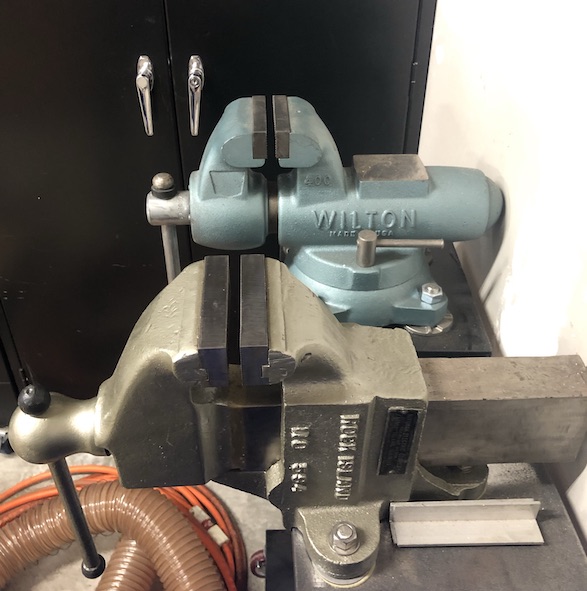

I have both the HF portable 20lb blaster (bigger than the one you are looking at) and the HF cabinet version that I heavily modified to make it work great. I restored two vises using the cabinet.
I can't imagine how much sand you will go through using a portable one with no way to recover the grit and it's not cheap. It takes a lot of blasting to fully clean up all the pieces of a large vise.
Regardless, you also need to make sure your air supply is very dry or it will clog up on you after a while and it becomes quite frustrating.

Those look great!!!

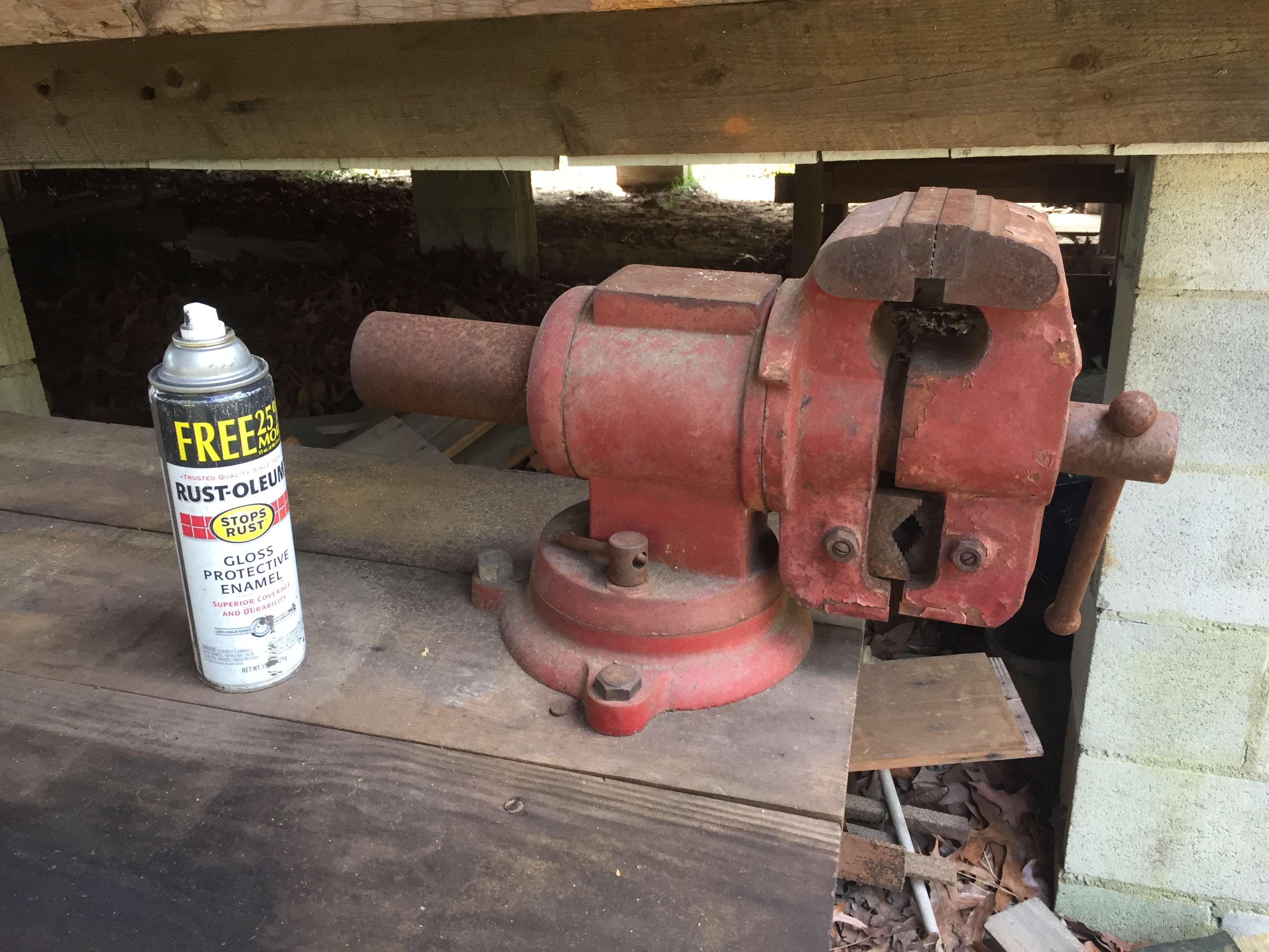

This is the one I'm looking to restore..

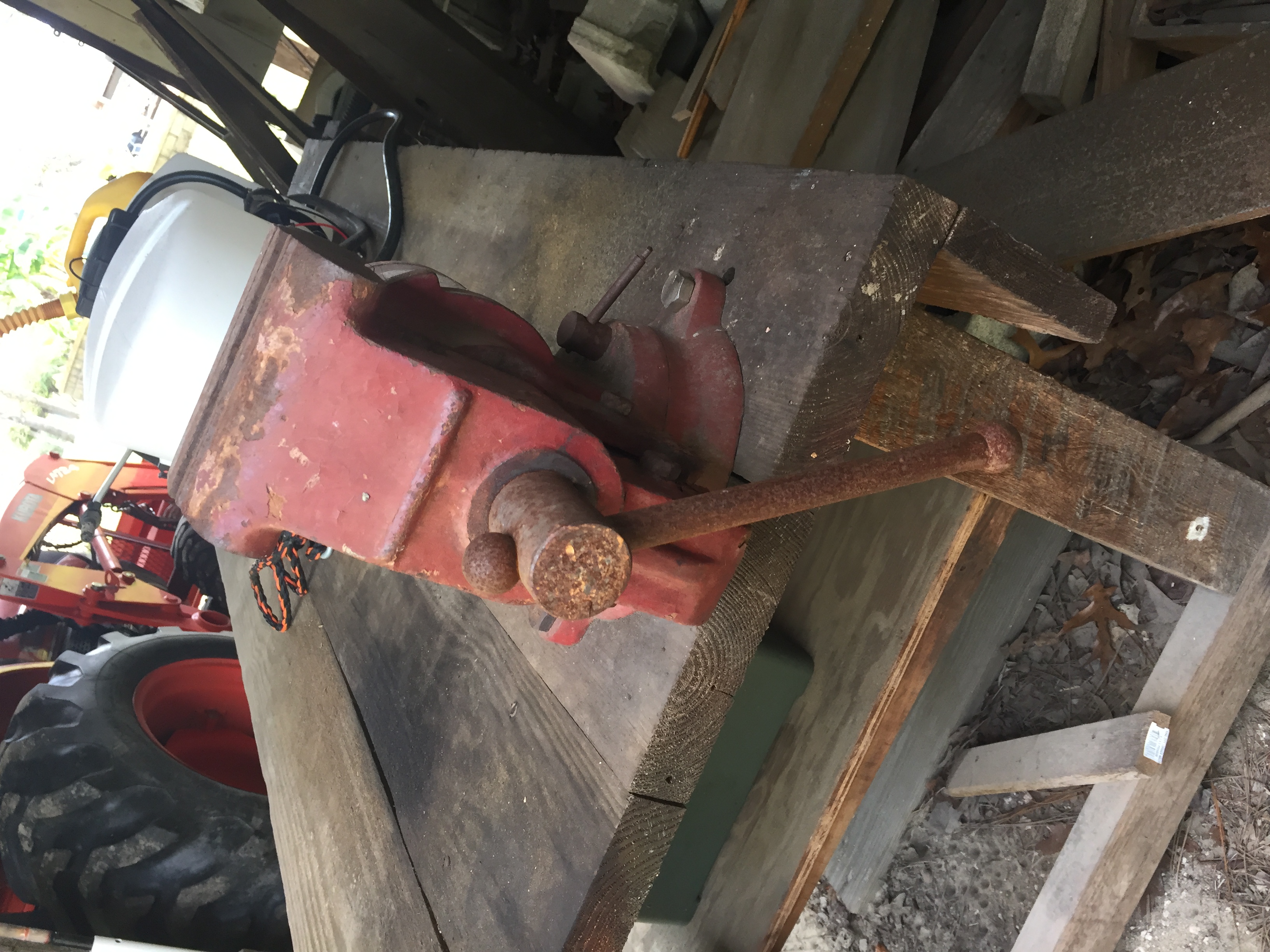

Well I bought this little sand blaster today with the 25% off coupon.. hope it does ok... and that's all I'm expecting is ok..
Portable Abrasive Blaster Kit
I'm wanting to clean up this vice..
