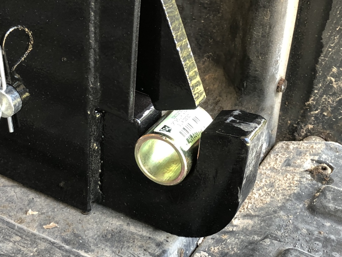

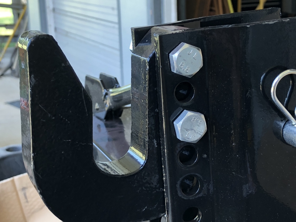

I haven't even taken it out of my truck yet but, plan to give it a look over this afternoon and I'll report back. I'll need the bushings on a couple of implements and rest are Cat 1 / Cat 2 hitches. Found some pretty good prices, for the bushings on eBay.
The lower hooks are sized for Cat 3. This is a Cat 2 to Cat 3 bushing.
The opening on top hook is a bit less than 1 3/8” and there is better extension than on the old ones. I don’t think any of the “aftermarket” hooks would give much improvement.
Let me know if you have any additional questions.

Thanks! So HF has changed the spec since their first version which had a Cat 2 hook.
It seems to me using an adapter sleeve like that with a clevis to hold it in, is preferable to adding the semi-permanent adapters with rollpins on every implement.
