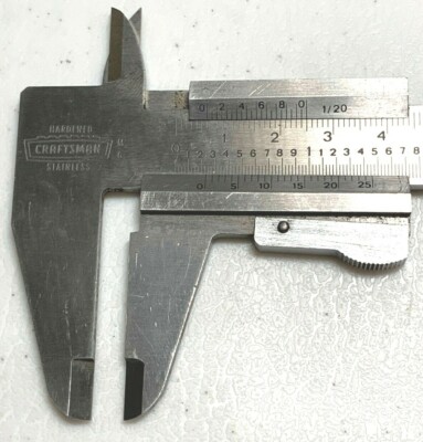

I have a Craftsman 40257 vernier, B&S and HFT with dials, and a few digitals. I use the HFT dials most often and rarely use mics.
Reading that second one
... makes my head spin. .2 + .025 + .005 = .230" ? Did I read that correctly?
At least this Craftsman caliper doesn't have the ambiguous markings like the one I returned, where there were often two different tics that might be 'correct'.
I've had for years a plastic General dial caliper but I rarely take it out, it could be damaged too easily just kicking around on the workbench. I had hoped to use the vernier caliper like yours for that, it seemed damage resistant, but I've decided the digital caliper plus the simple one I just bought, are sufficient. I have several cheap plastic calipers but none will hold a measurement, they're kinda useless.

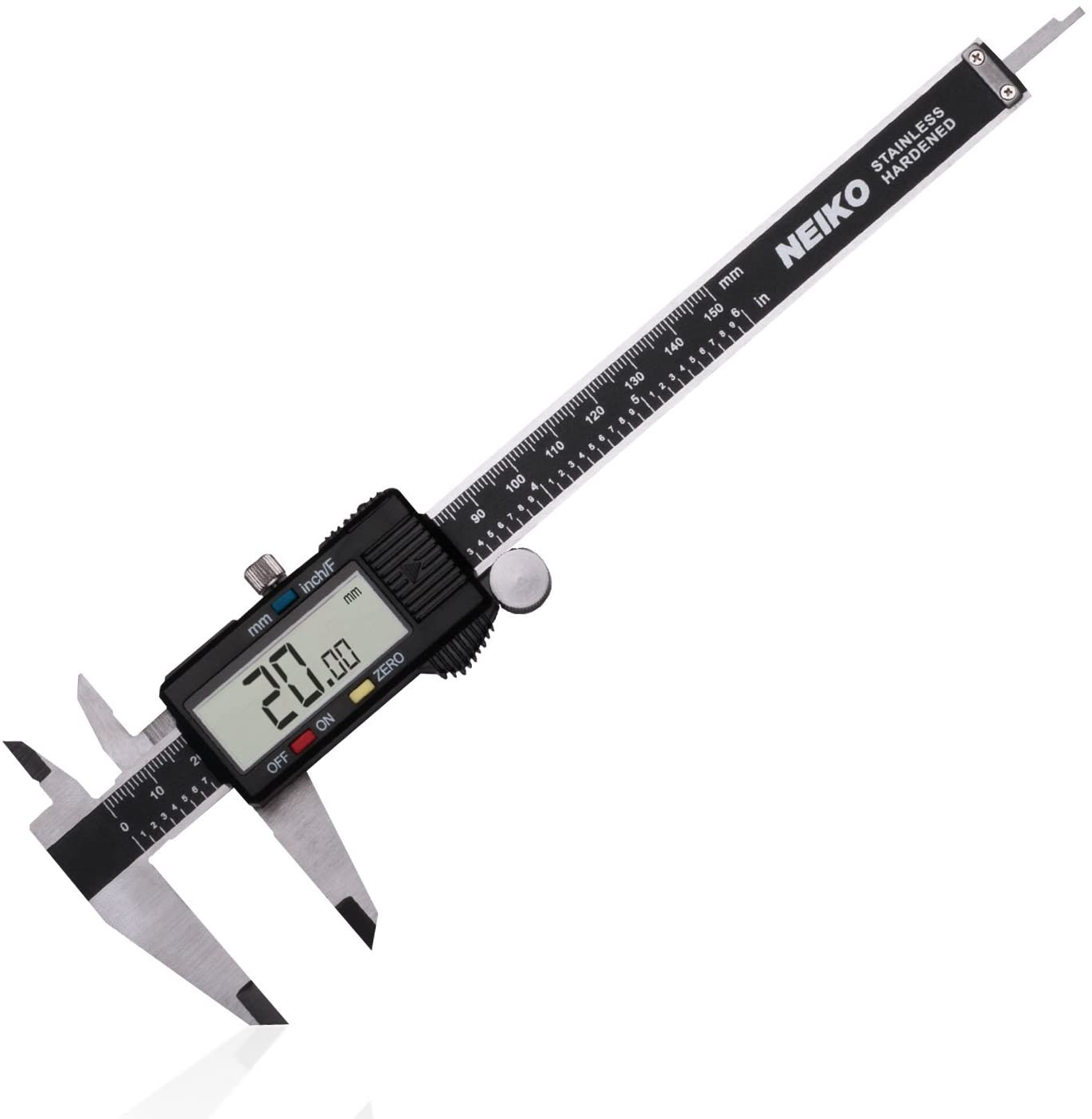

I have a digital caliper similar to this one. Hard to mess that up...
I expect many of us do. Mine's from HF. The precision seems good, it matched the vernier caliper described above (the one I returned) and is far more convenient to use.
But I don't get it out often because, as Old Grind noted, they eat batteries whether switched on or not. I don't leave a battery in it. I frequently found the battery dead before I figured out to remove it.
Might as well buy a card of batteries along with a digital caliper.
