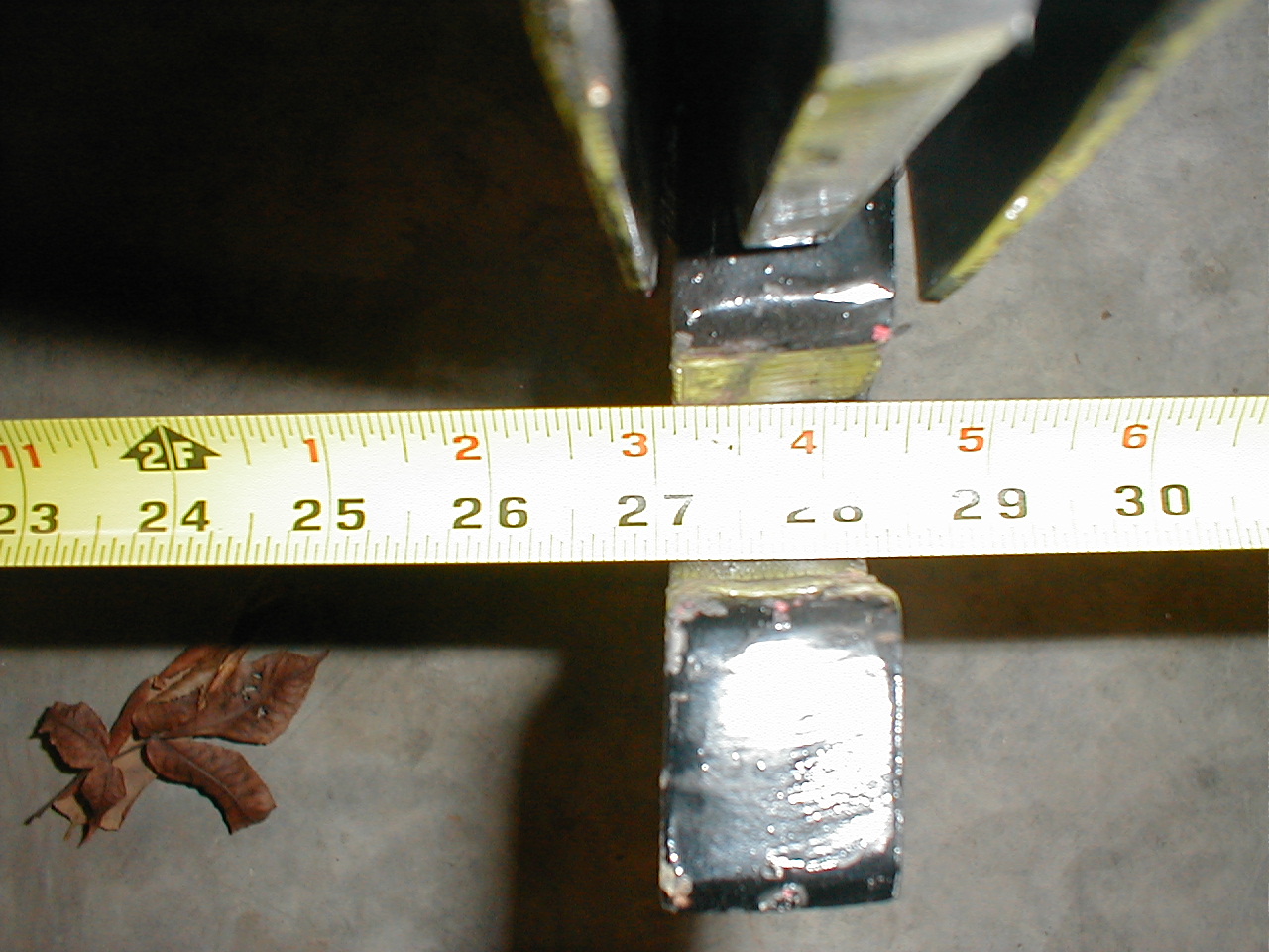

I just asked the same question on the HF quick attatch before finding this thread. My HF catalog sez ; draw pin adjustments 18", 19", 20", 21"; overall dim. 27-1/2" W x 18" H; wt. 60 lbs.

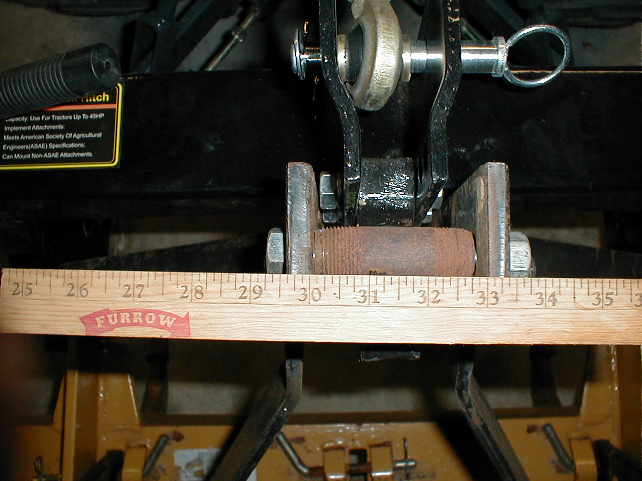

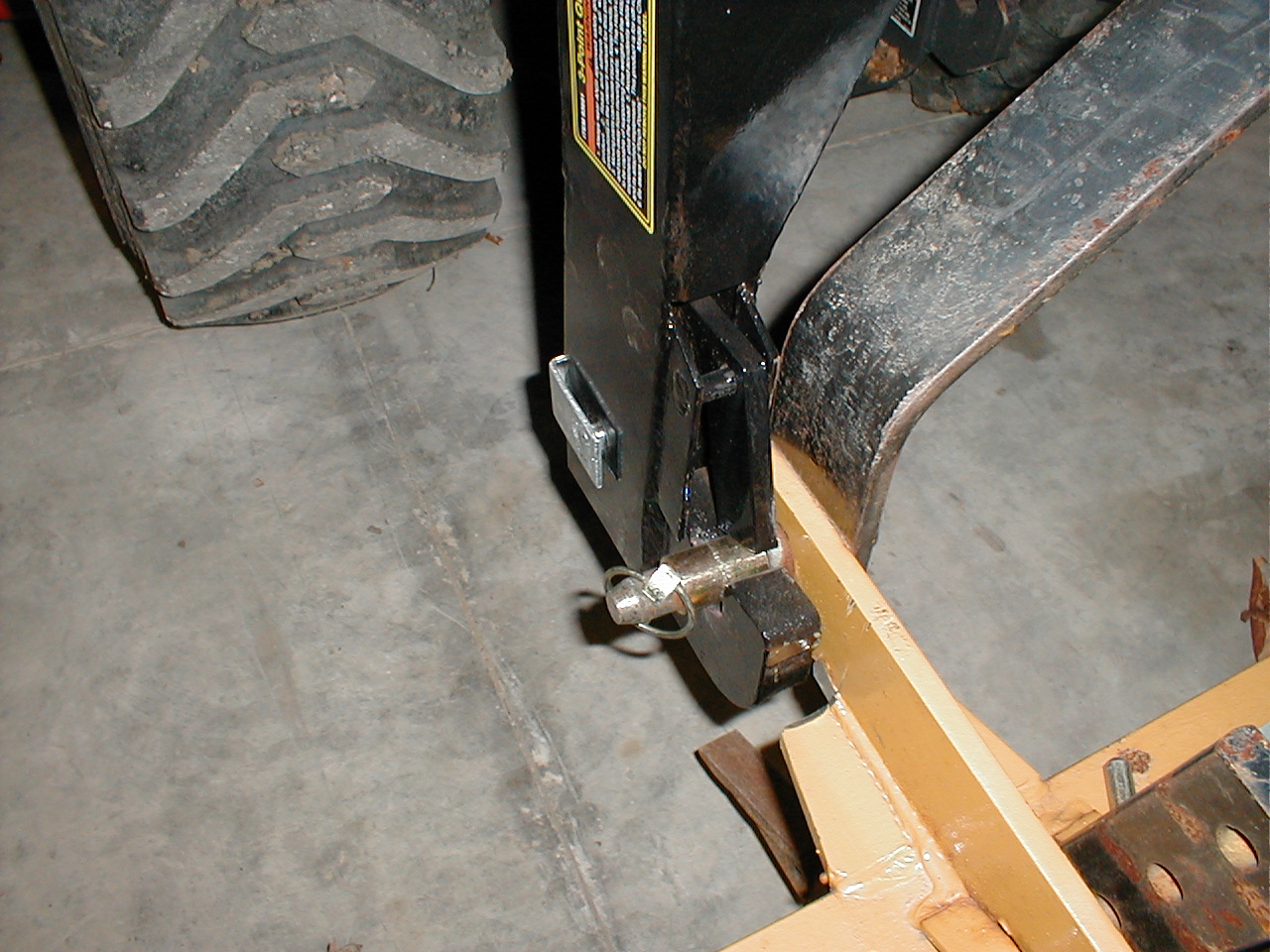

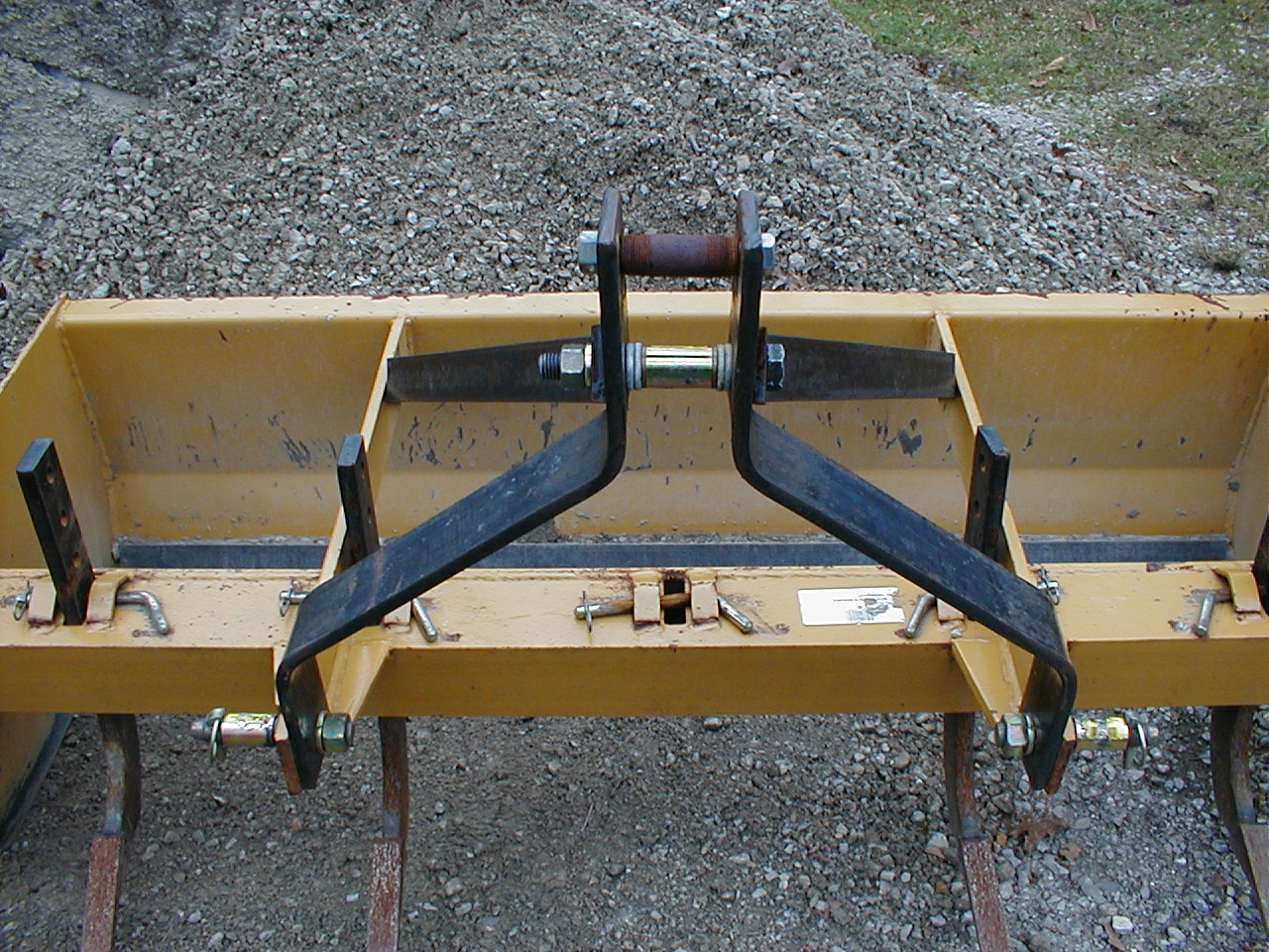

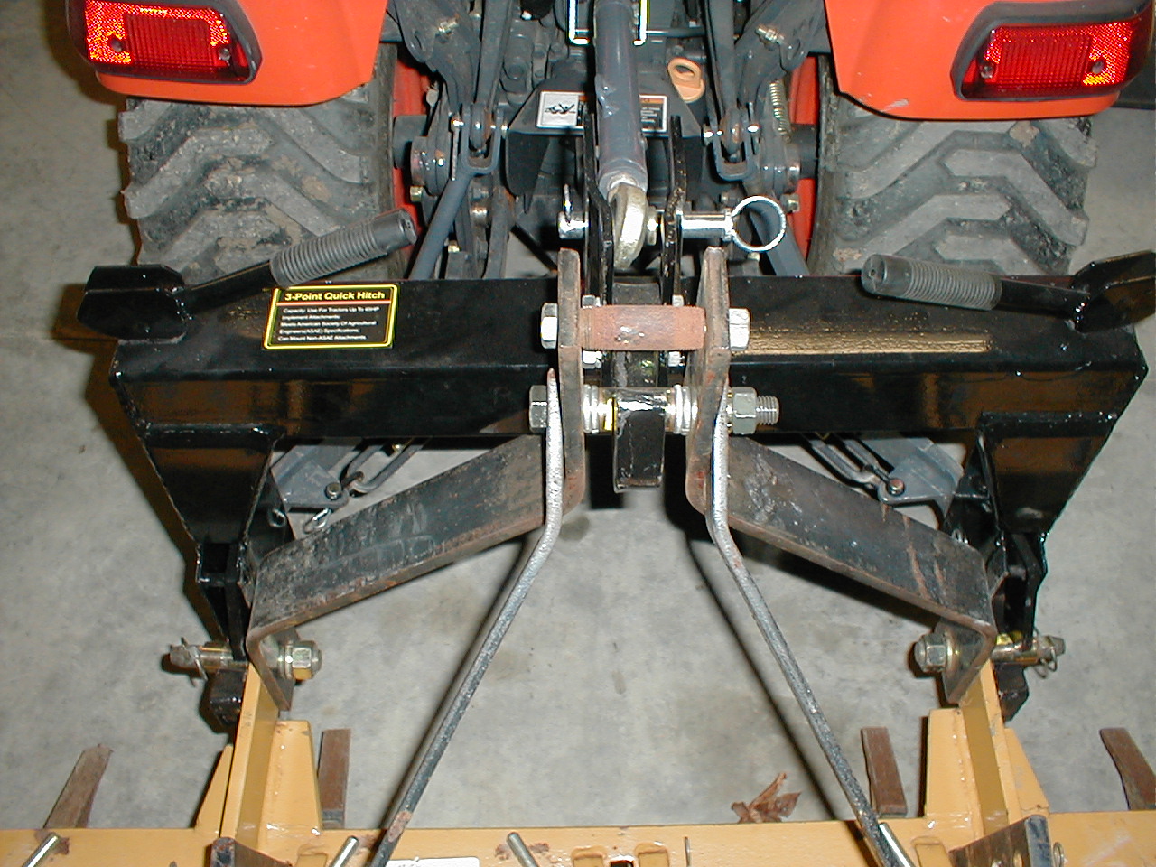

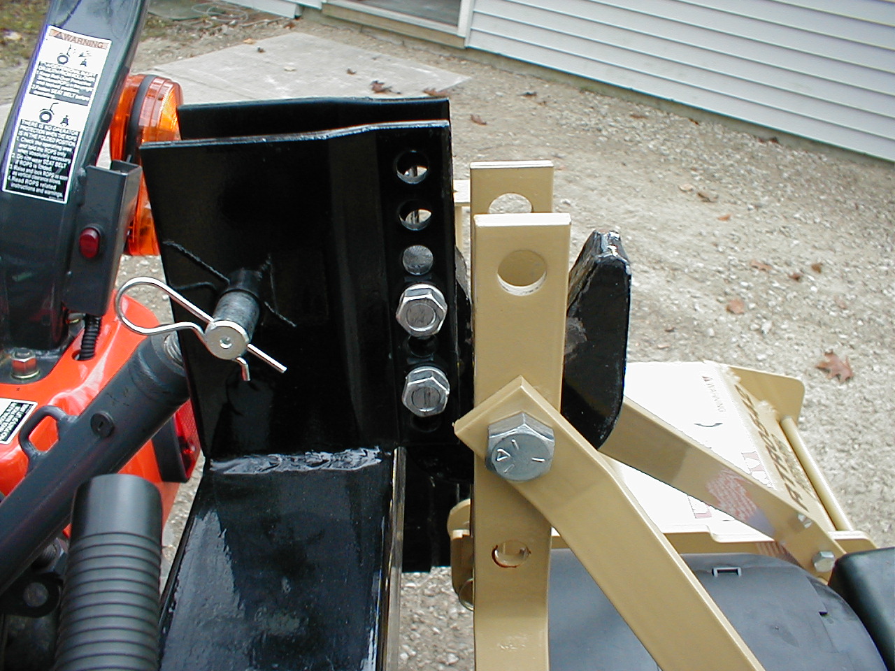

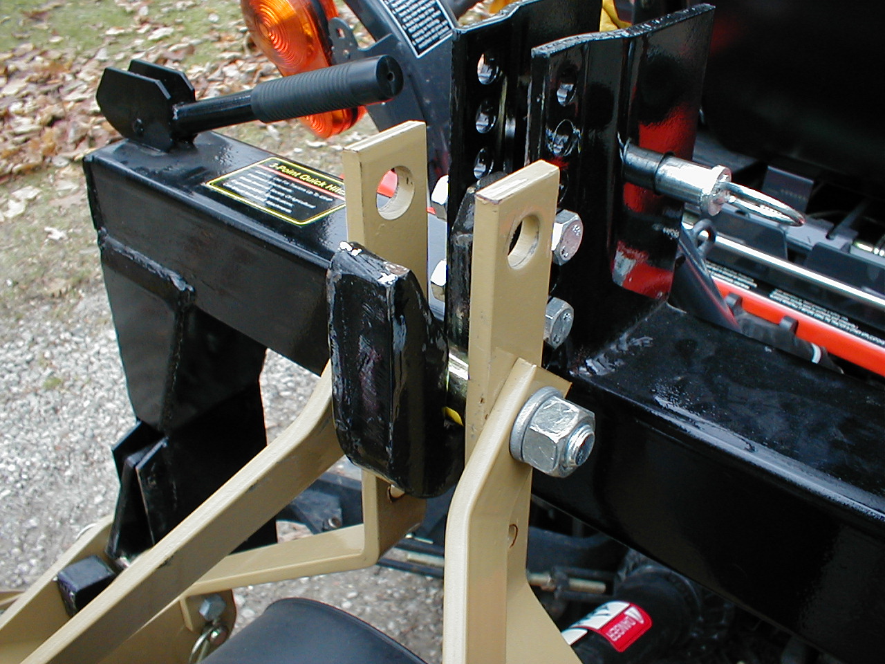

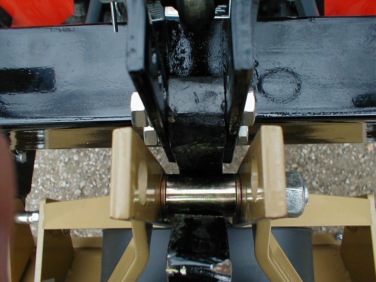

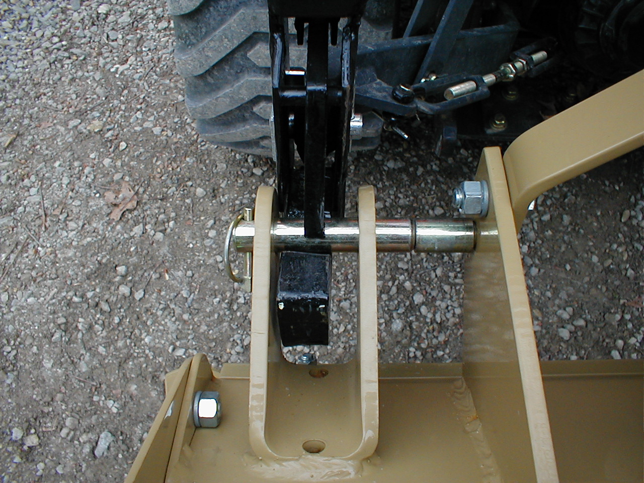

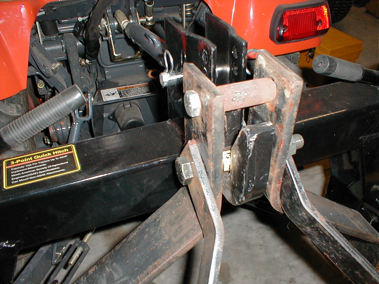

I must be pretty lucky. So far with the two implements I've purchase they both adapt to the HF hitch without major modifications. My previous post, with pictures, identified the change of the center hook connection, 60" KK BB, to be spread to a 3" gap between uprights by moving the back braces to the outside (supplied from the factory on the inside). I purchased spacers from TSC to keep the 3" gap after bolting it back together. Setup works great, not required to get off the tractor.
I recently invested in a 42" Landpride tilller and my luck continued. The uprights are smaller and did not require the 3" gap. The standard hook supplied with the HF hitch throat dimension was a bit too small. I purchased the same spacer used above from TSC and bolted it between the uprights. The spacing on the lower arms was perfect. Both setups for my 60" KK BB and the 42" Landpride RTR work interchangably. The pain is still hooking and unhooking the PTO drive shaft. I forget to move the PTO lever to undermount drive only position before getting off the tractor, which allows the rear PTO to freely rotate and makes it much easier to connect. See the pictures for more detail.

Update to thread: I got the upper link adapter. It swings up or down to match each implement's upper pin height, which is good.
However I ended up making the upper hook height easily adjustable, by replacing its bolts with a couple of trailer hitch receiver pins. That works simpler than using HF's adapter. (See the HF bolts in photo PB040012, in JEW's post just above this one.)
