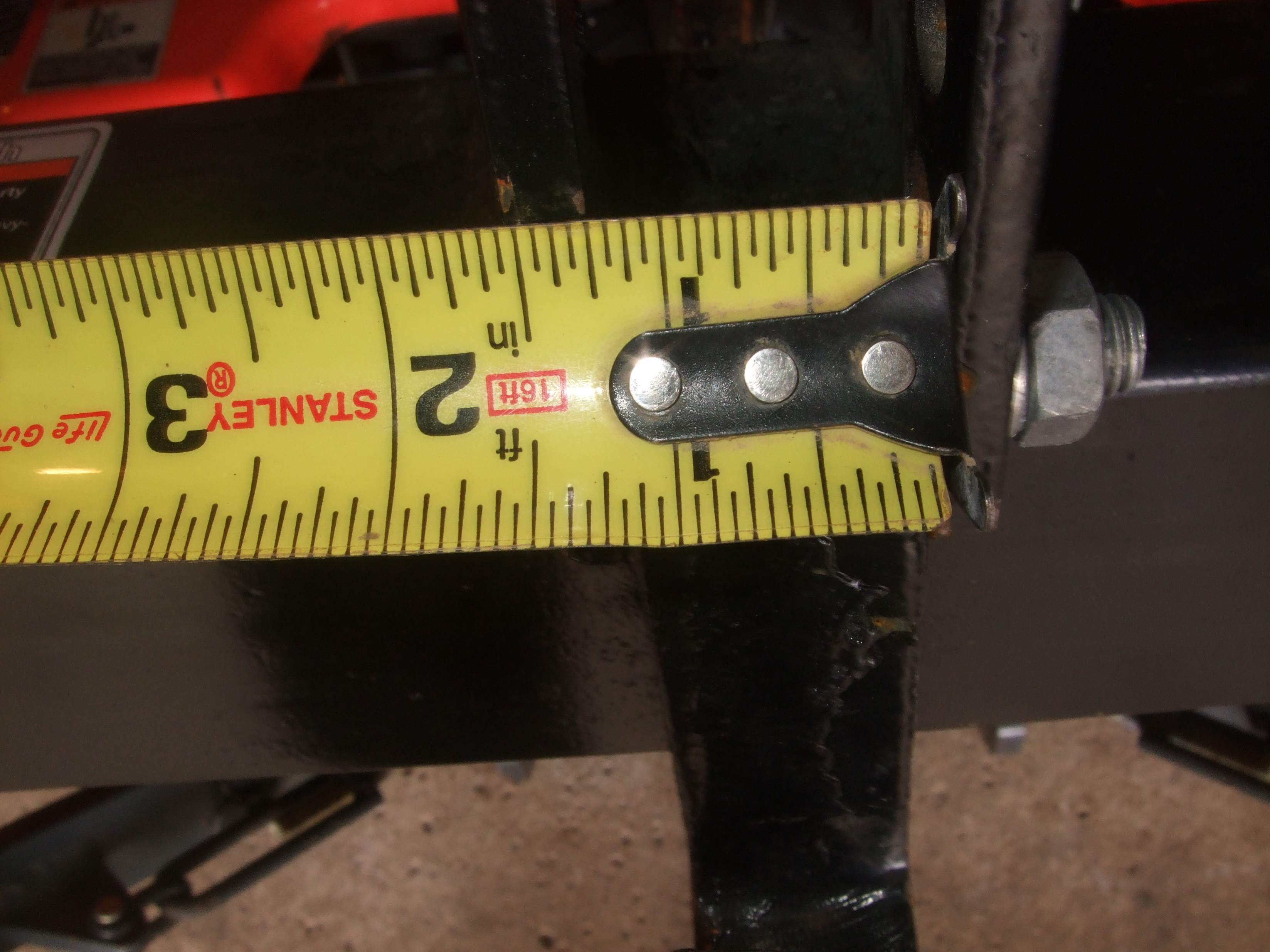

Sorry should have said more. The adapter that mounts on top of the HF quick hitch. It allows for a greater range of implements that will work on quick hitch. I think the part number is 29309 and it costs around 10 bucks. I just need the opening between the tabs that attach to the quick hitch.

Here it is. it's 1 and quarter wide. On the inside and its 1 and seven eights on the outside. You need the outside dimension, not inside. The HF adapter goes on outside on the QH. I am not sure If you trying to using the otherway around.
