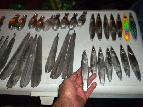

I've been making lead jigs for salt water fishing with a few fishing friends and I've been toying with the thought of powder coating these.......Can the lead be powder coated..?? Does it need any sandblasting for prep..?
Do you think this will work by preheating or baking the normal way in an oven.....

if there is not any oil or wax on the lead it should be fine as long as you keep the temp below 620 deg.

Bill. those are large jigs... I've made jigs up to 3-4 oz for lake trout and musky. I've powder coated some lead jig months after casting them without any prep and have had excellent results. I think lead is one of the few metals where prep work is not needed.

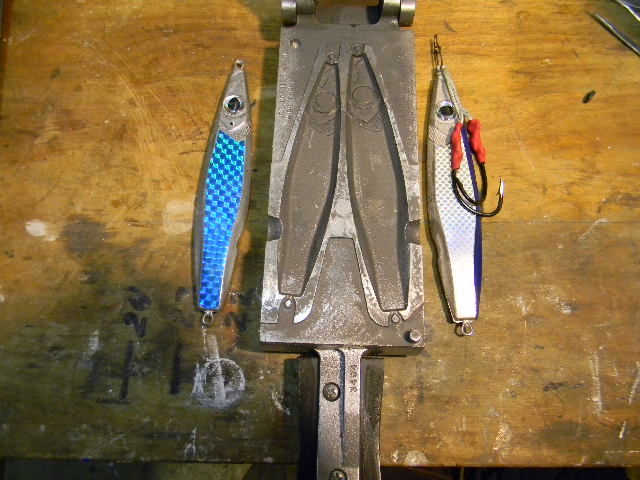

/ Harbor Freight Powder Coat Paint #33
Here's the pix of the mold
I was away for a few days. I have the smaller version of that mold -- the 1/4oz to 1oz model.
