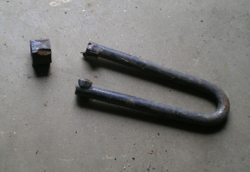

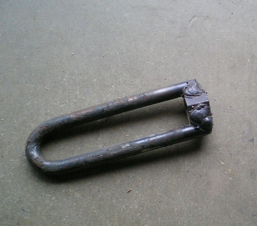

Finally broke the notorious BX turnbuckle. An obvious factory weld failure so I figured I couldn't do much worst with the hot glue gun. Works good so far.
Pic 1 is of the failure ... welds just plain broke.
Pic 2 is repaired , looks poor (I'll have to live with that for the rest of my life).

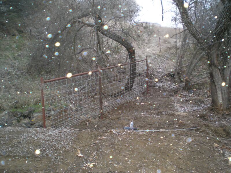

We had nice balmy weather here in Kalifornia (35°) today so I got the cross bars welded onto the posts for my creek crossing fence. The only things that I don't like about the HF hot glue gun are: 1, the wire rolls don't load themselves and 2, the 10% duty cycle seems to have been mislabeled ... due to my poor fit-up of the cross bars, I had a lot of filling to do and, I'm sure, most of the 4 joints I had to weld took more than 5 minutes each ... with no more than 1 minute breaks in between ... the whole exercise started to feel like real work :cool:

Question, are those posts in concrete or just driven in? ( I'm new at this)

The outer 2 were driven w/ my 40# Hitachi electric demo hammer. The middle one, I backhoed down 3+' thru granite cobblestone and just packed the same material around the post ... it's locked in pretty tight.

If you have other trouble with the BX turnbuckles, I'd urge you to do the mod to add the sliding links off the bigger model Kubota. I forget the model, but if you search on BX turnbuckles, it should come up. Think it cost about $60, and takes a little effort with an angle grinder to make them fit well, but they hold the lift arms very stable and eliminate side sway.
Probably the best mod I've done to mine.
Hope this helps.
