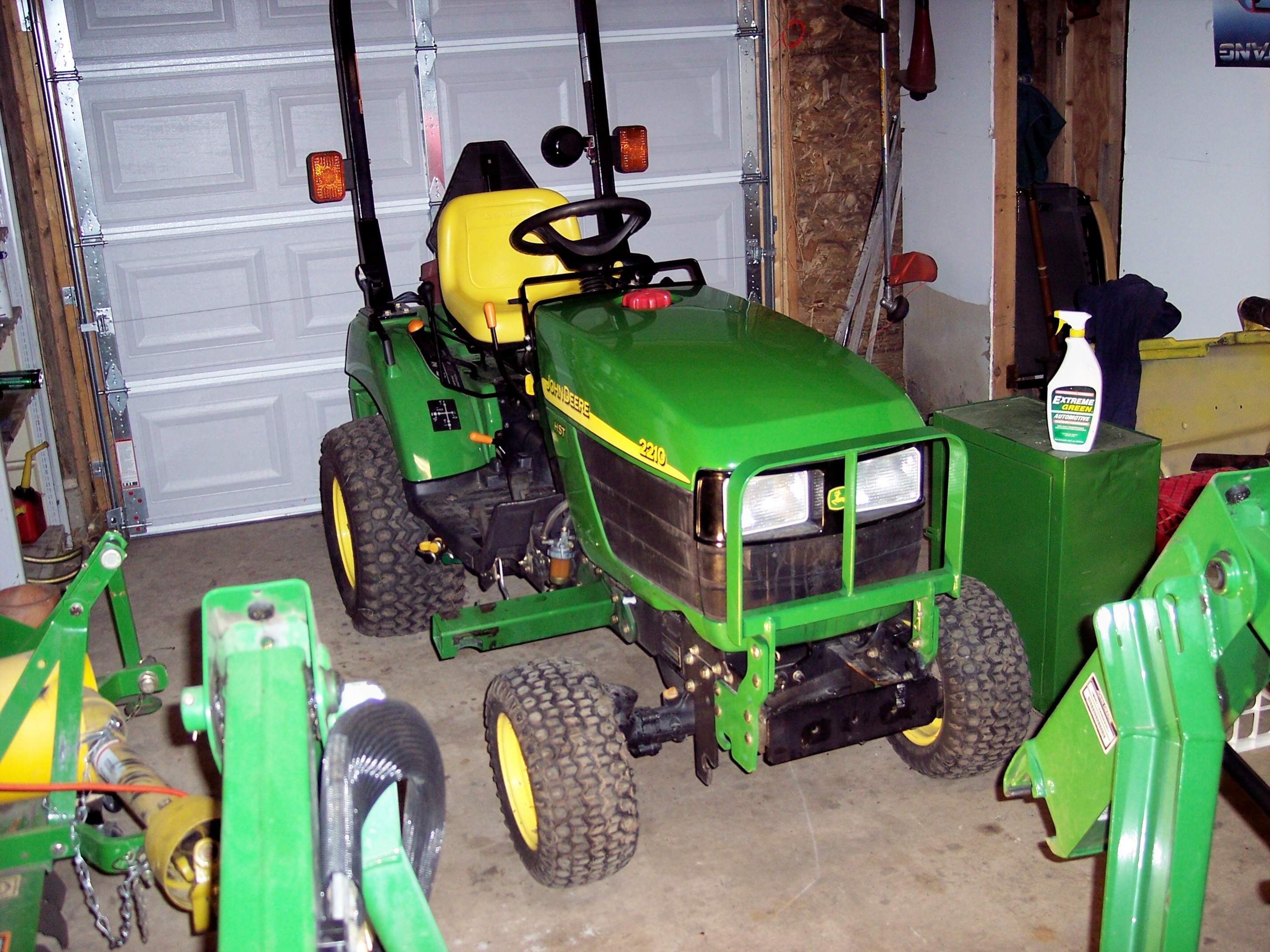

Ken, cylinder #1 was about 1/4 turn of the screws, or about .012 gap, some were about .011 the rest were .01 which I believe is acceptable but I went for the perfect .006's.
Here she is smiling, ready to go. Battery area repainted, new hold downs, and tightened the fan belt this morning, put back together. She even has her very own garage. Extreme Green worked hard this winter clearing snow, now moving on to warmer work. Raining today but will mow in April in Minnesota, weird.
