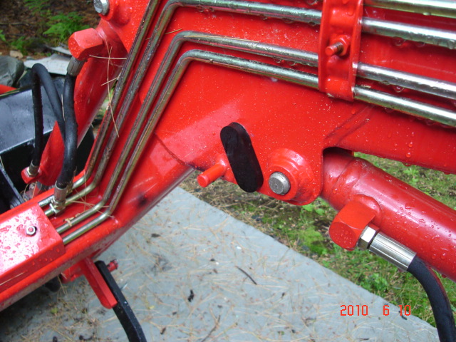

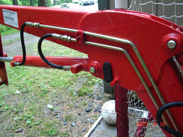

Wacky- the 2300-series tractors didn't have those rubber things for the FEL storage feet, but it sure seemed like a good idea to me. I asked my dealer to get me a couple, and he had some right there- apparently many of them do fall off.
No problem! I used alcohol and/or acetone (don't remember for sure which, probably both) to clean all original adhesive residue off the rubber pad, then thoroughly cleaned the painted surface where they'd be put, and used medium (gap-filling) "super glue" --also known as CA or CyA glue-- from my model stuff to stick on to the side of the FEL arms. They've never budged, and it's been well over a year.
They do work to keep the FEL storage arms from rattling; I suspect mine is the only 2310 in existence with those rubber bumpers!:D
