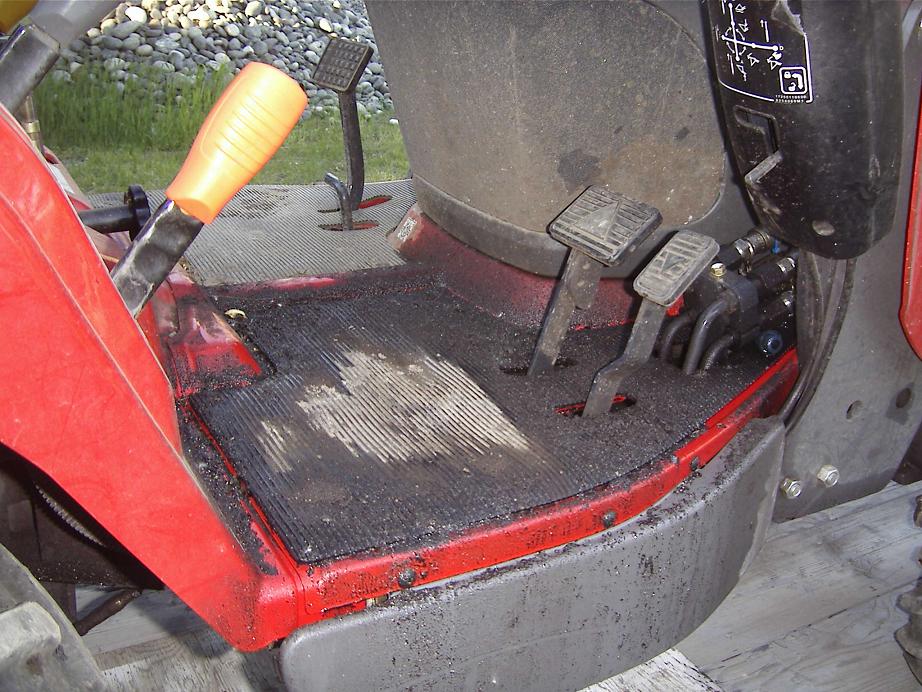

mine leaked from new. (at the loader disconnects)
first dealer repaired at 20 hours, this picture taken at 47 hours.
the second dealer did a better job, but i still had one leaking screwed connection afterward. i broke down and worked on it myself.
it may or may not be good now, but its certainly a lot better. i hope this doesn't turn out to be a chronic problem. hate to say it, but it really looks like a quality control issue.
other than that i guess the only annoyance is the lack of a light or buzzer to remind me that i have left the e-brake on:ashamed: btw, it looks like there are quite a few unused spaces in the warning light panel.
all things considered, i still give it a resounding thumbs up. now that i own one, and have put it to work:D, its easy to see why these things command the prices they do.:thumbsup:
