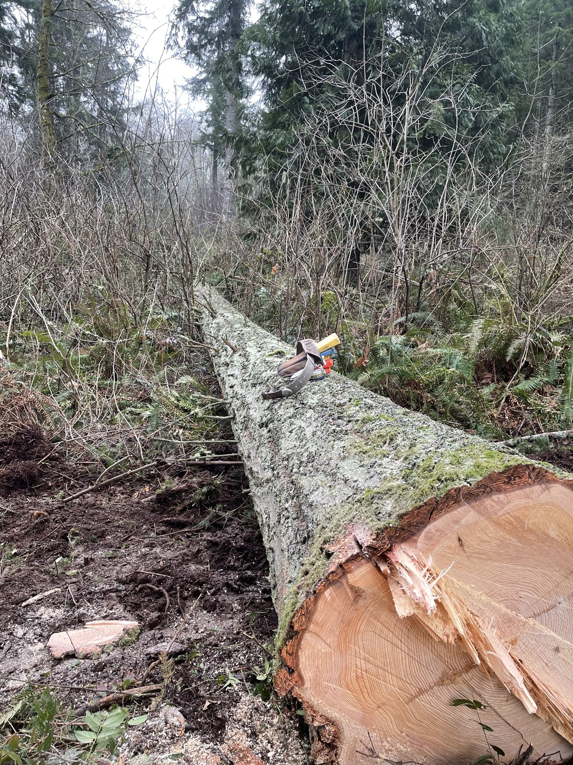

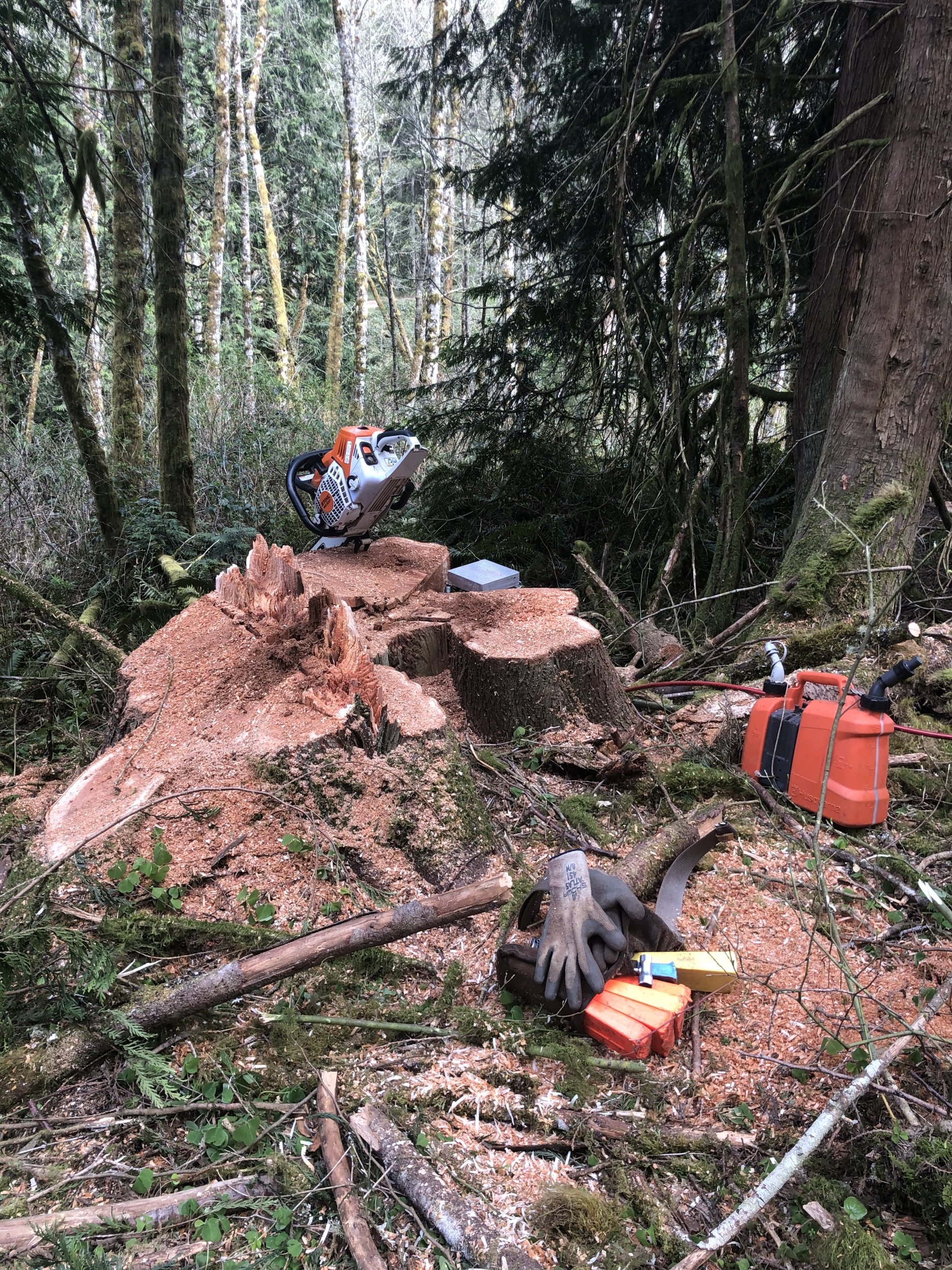

Let’s see how and where guys are using different methods of falling timber.
Being out on the wet coast I’m sure I do it backwards to some but this is the standard way of falling out here.

I've seen it done that way and especially if the expert sawman needs it to fall due to a space issue. For the most part though it's easy to drop just with a specific cut on the side you want it go in.

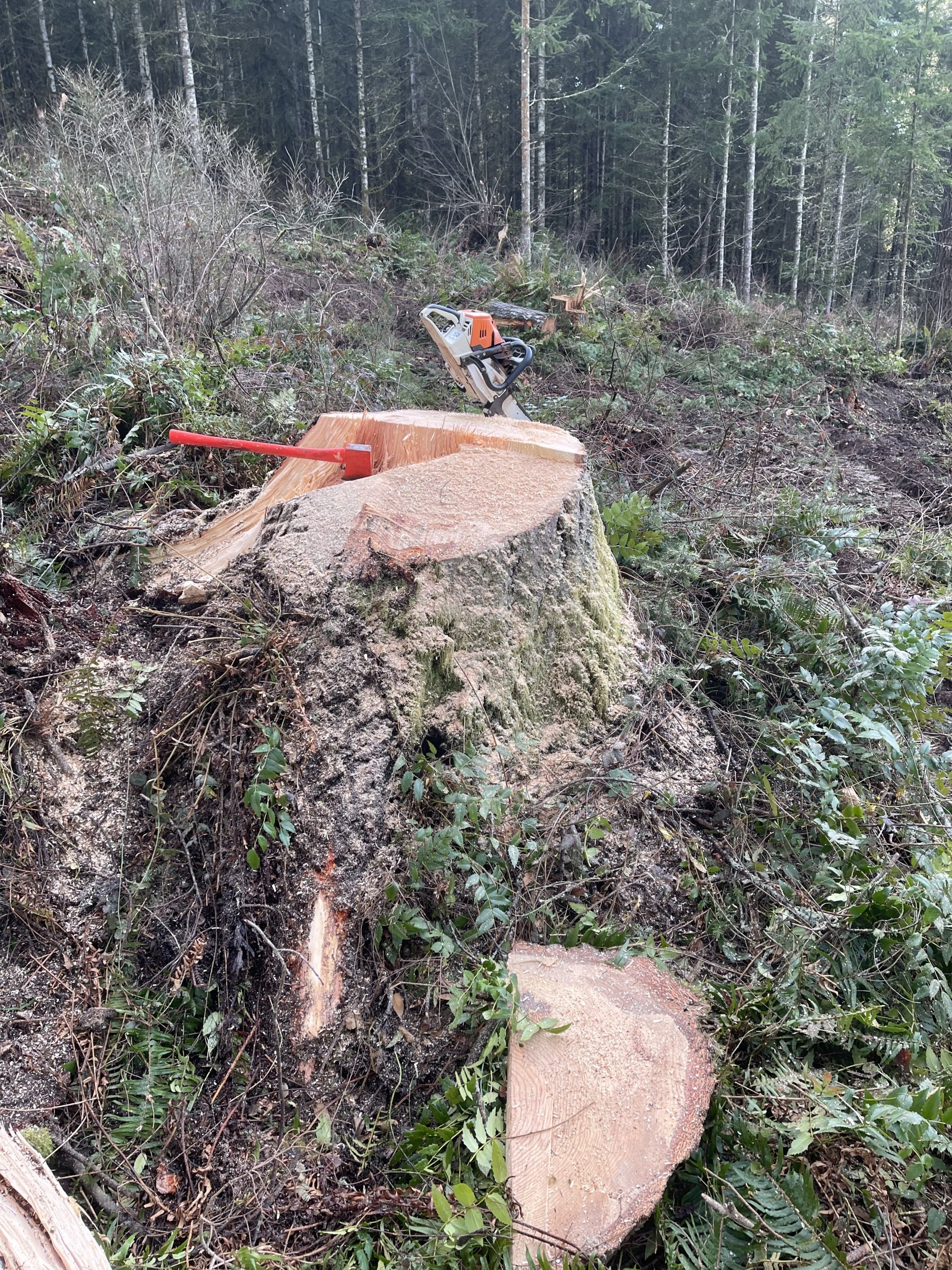

Use conventional face here, with back cut, or plunge cut if it's a dead ash.
Ours mostly 100' or less, so no notch and jack needed.
If it's too near a house etc. I'll call in someone with a crane or cherry picker.
Did a lot of plunge cuts the last few years with the dead Ash, too many tried to barberchair.
More ropework where we have dense trees.

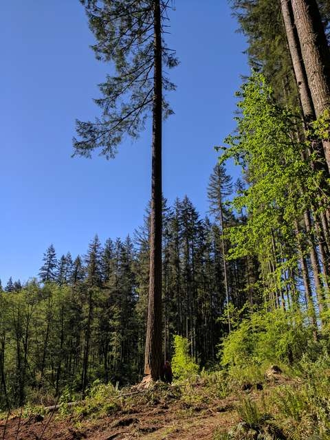

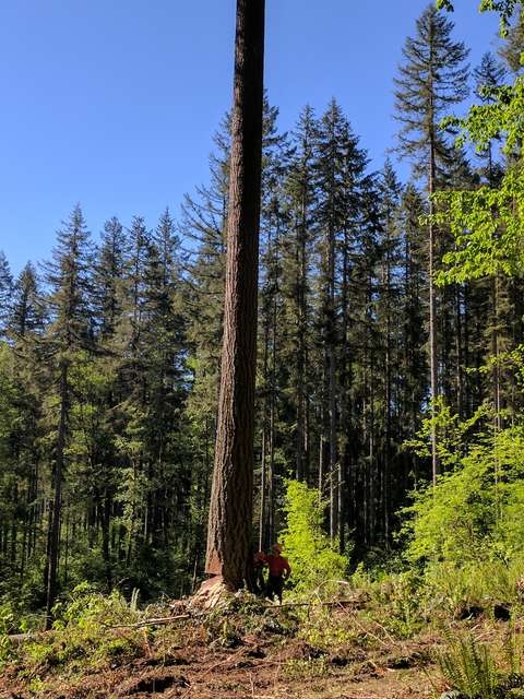

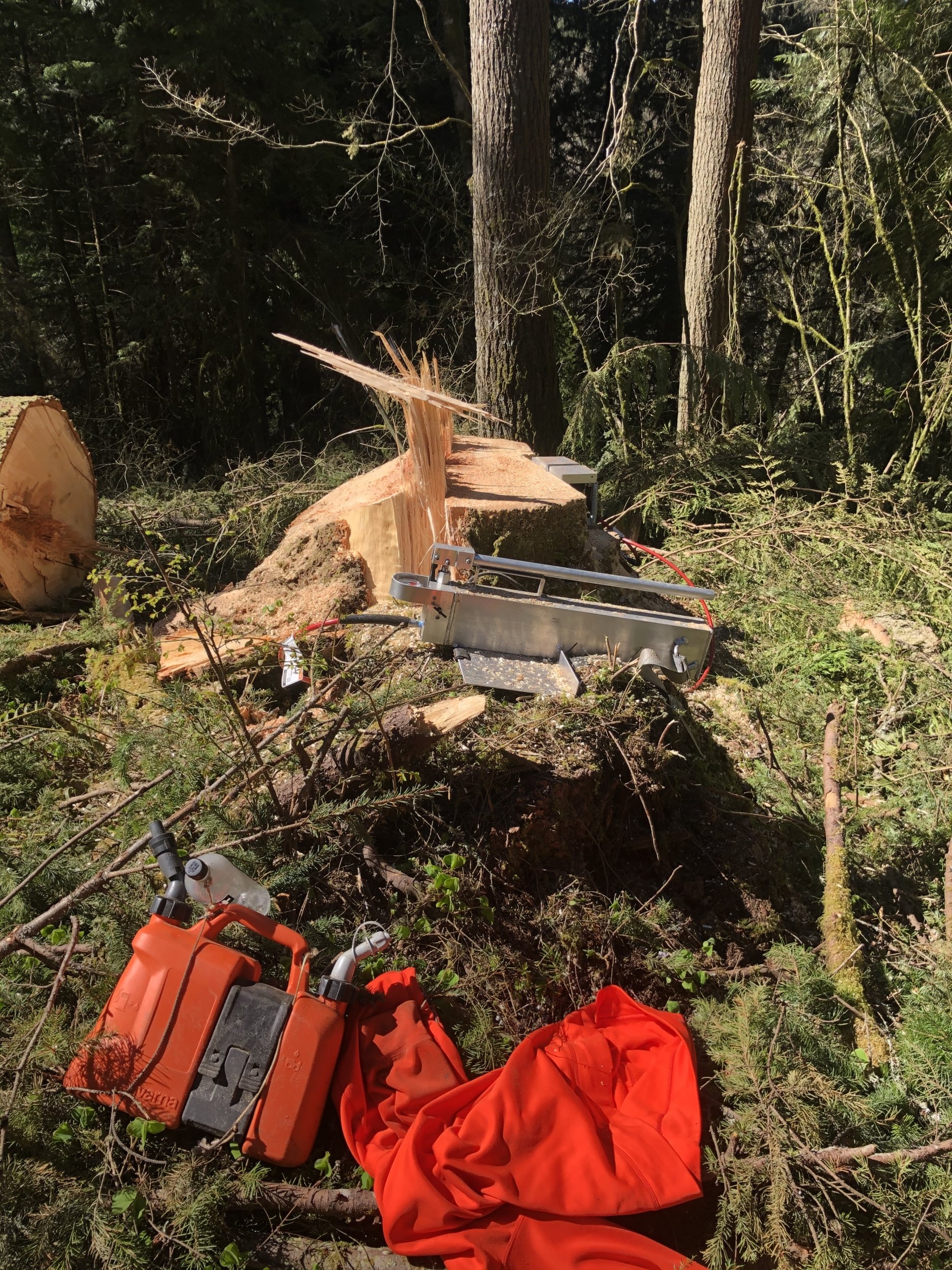

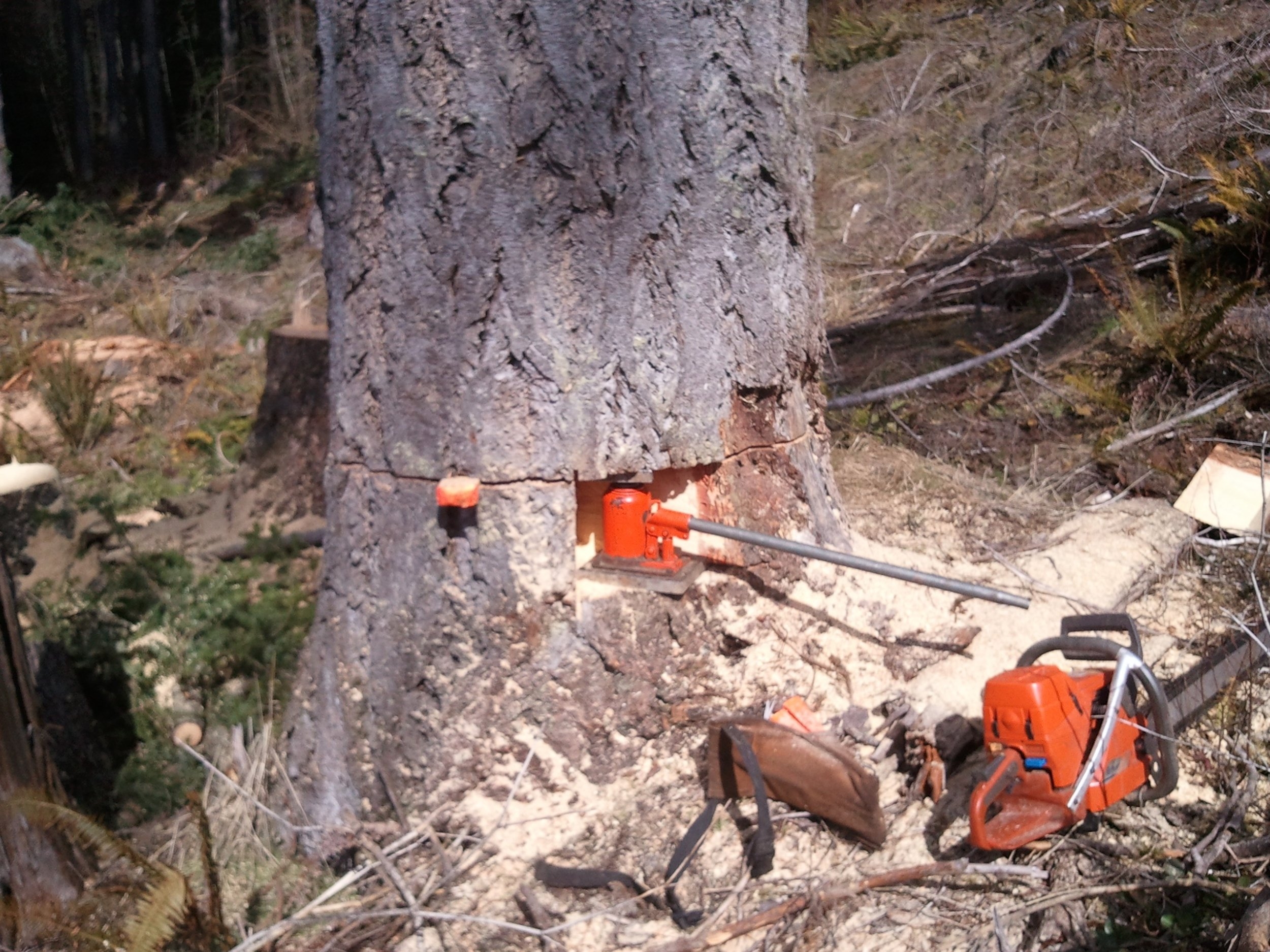

Using a jack isn’t something I’d recommend for everyone it’s a unique experience as well it can be nerve racking. That jack was setup just for some of the ones that aren’t leaning back that bad, if they are I have a dual ram setup that will lift 102 tons as well as they have a gauge to watch what the tree is doing.
One thing that can help is putting the back cut in first on a back leaner like we do with jacks.

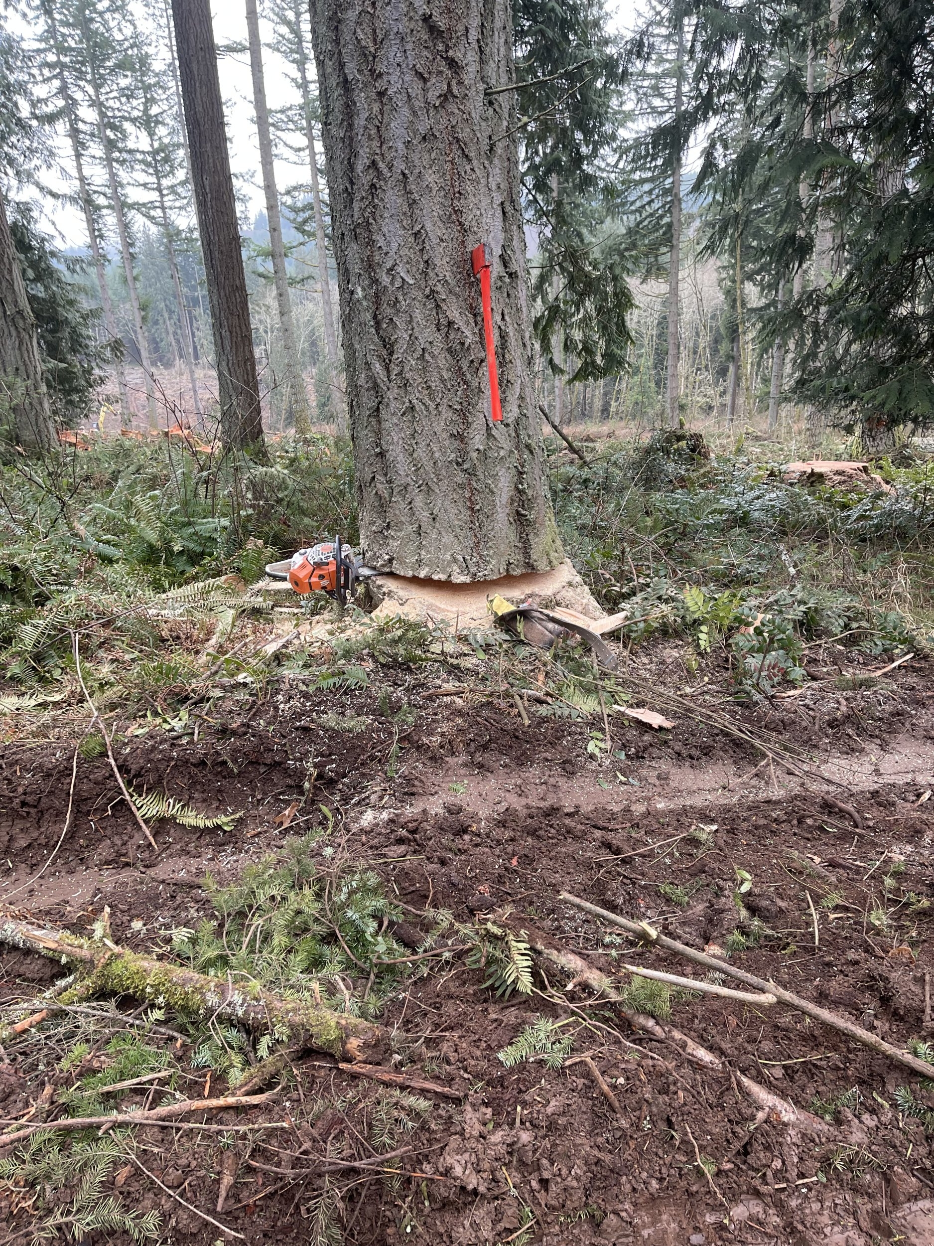

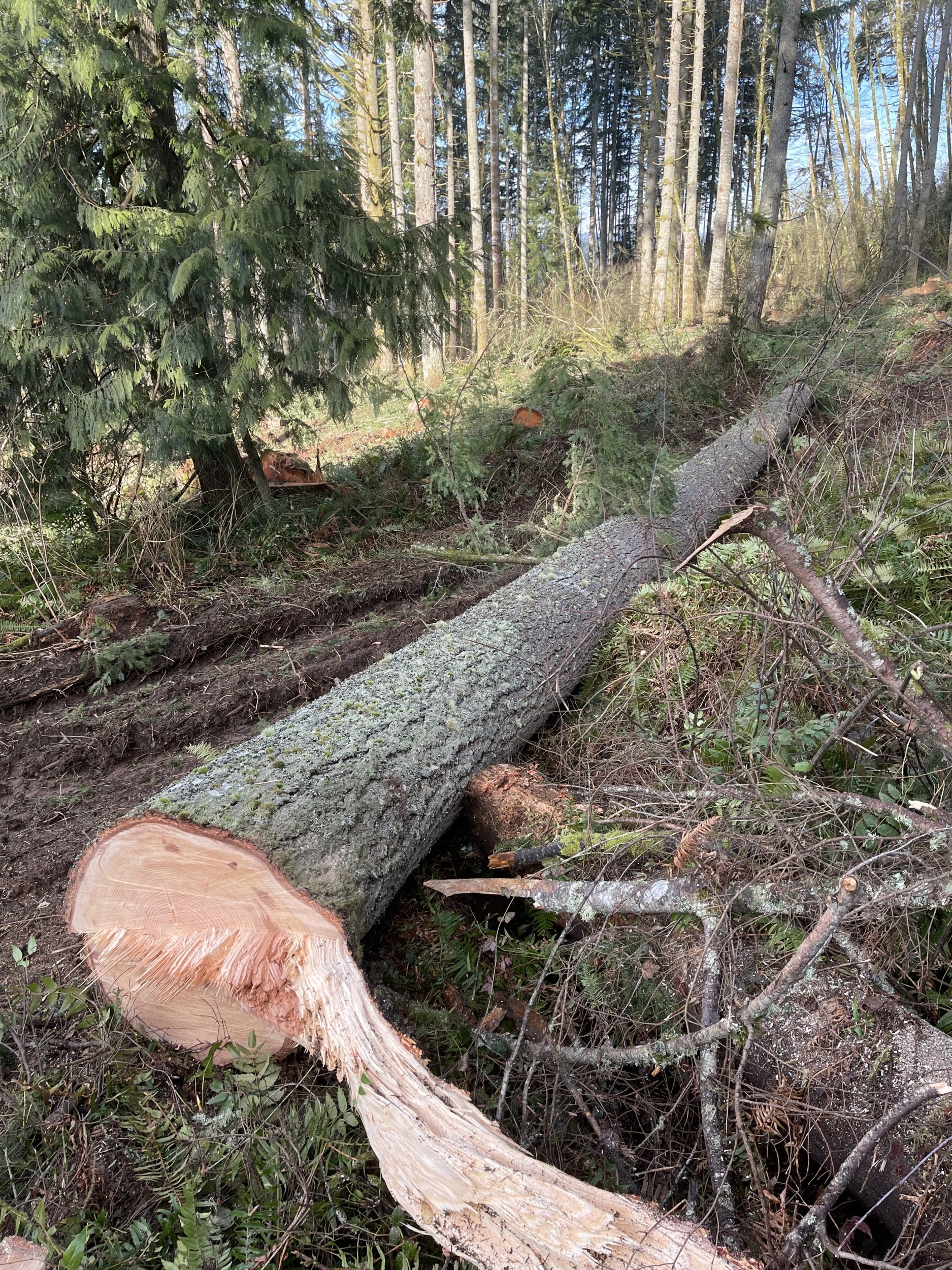

you are way more pro than I ever was with that setup.
It’s made me a good living doing it,
it’s nice to be able to save out and sometimes it’s just nice not having to hardly touch wedges.
