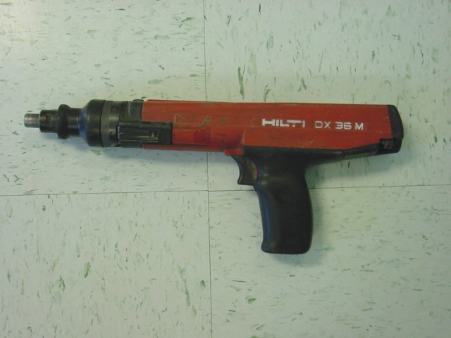

Have you considered using a powered anchor gun to shoot nails into the concrete through the lumber? This might be the best solution to the problem. Why drill holes and bolt anchors in when you can shoot them in quicker???? For the hammer drill, I have a 1 1/2" Milwaukee that will drill 6" holes in concrete. The 1 1/2" designation is the largest size drill bit that it will take to drill a hole. After that, you use hammer drill hole saws. Mine is about 10 years old and still works great. Purchased it used at a flea market for $50. Lots of them on eBay also.

I just anchored some wood to block with one of these... I shot about 1000 nails and it's REAL handy /forums/images/graemlins/laugh.gif

</font><font color="blue" class="small">( Have you considered using a powered anchor gun to shoot nails into the concrete through the lumber? )</font>
Indirectly I have. I'm using that "new" treated lumber and when I asked the dude at the box store about what to use to anchor it, he gave me the story (which I already knew) about the new treated stuff, reacting to the traditional fasteners.
I asked about cutter nails, he said he didn't think they'd live long in the new lumber either. We briefly spoke about the shooters, but I kind of felt I could have future utility out of a drill more so than a shooter (didn't think about renting)
So, the shooter wasn't investigated very well I must admit.
I'll look into that too.
